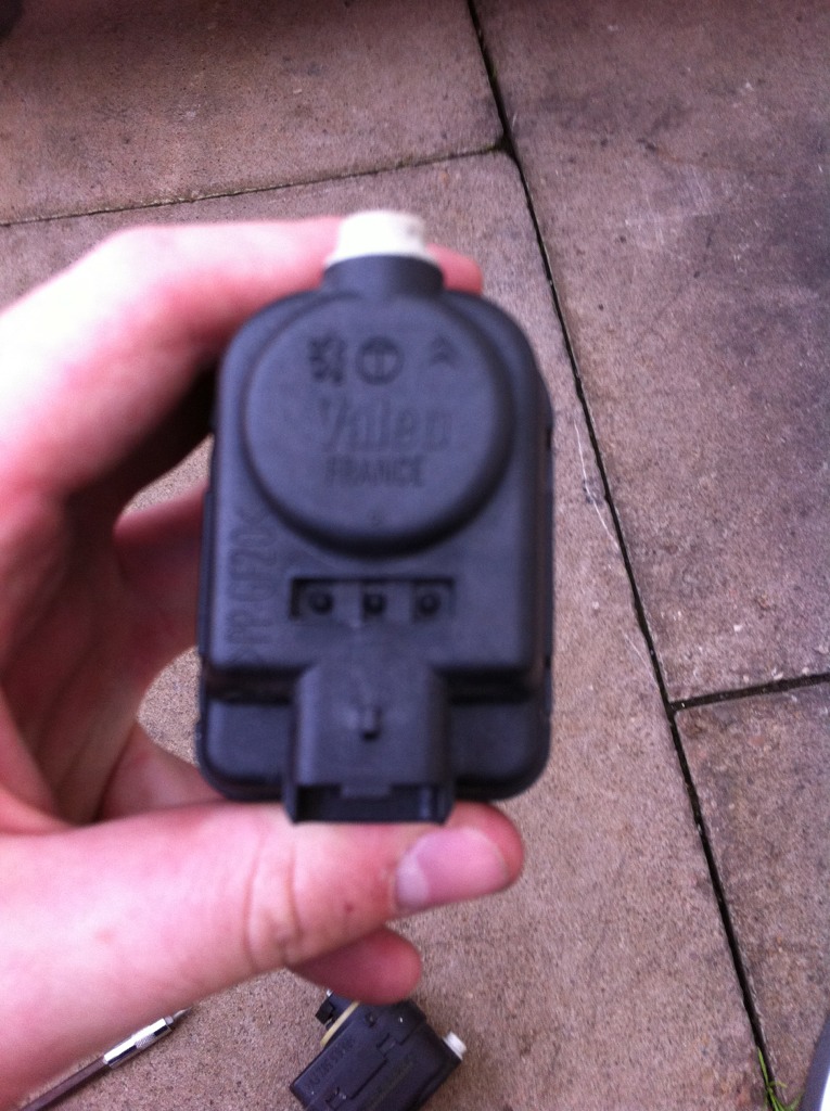

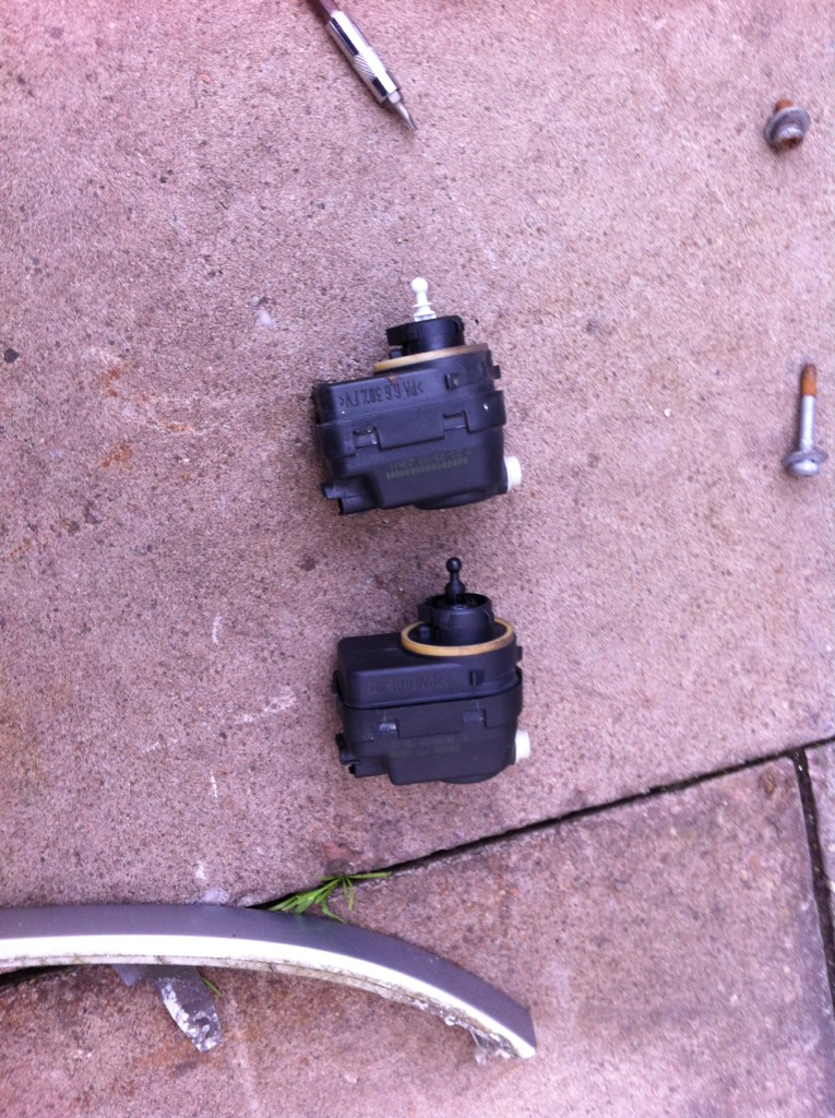

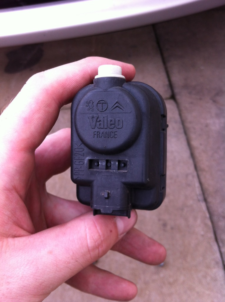

Finally got round to doin this yesterday. Hasn't worked. Both sets of my adjusters look exactly the same too. Tried swapping everything over and tryin every combination but hasn't worked.
They work cuz moved the switch without the adjusters in the light and they were moving. Dunno what to do?
Take pictures of the two adjusters you have?
They are the ph3 ones, do you have the brown ones?
They are all the same mate. No brown ones. Took a pic of one that was in the ph2 lights, and a pic of one of the ones out of the crystals
