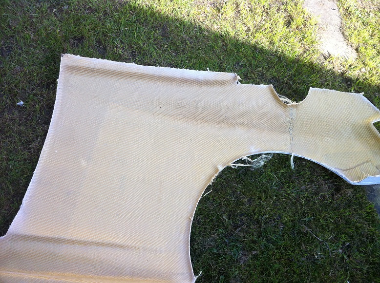

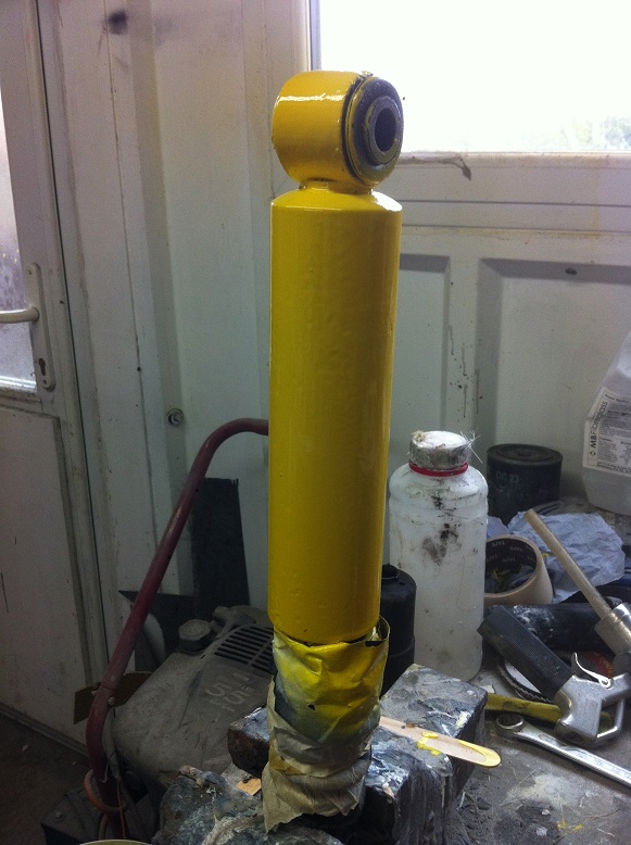

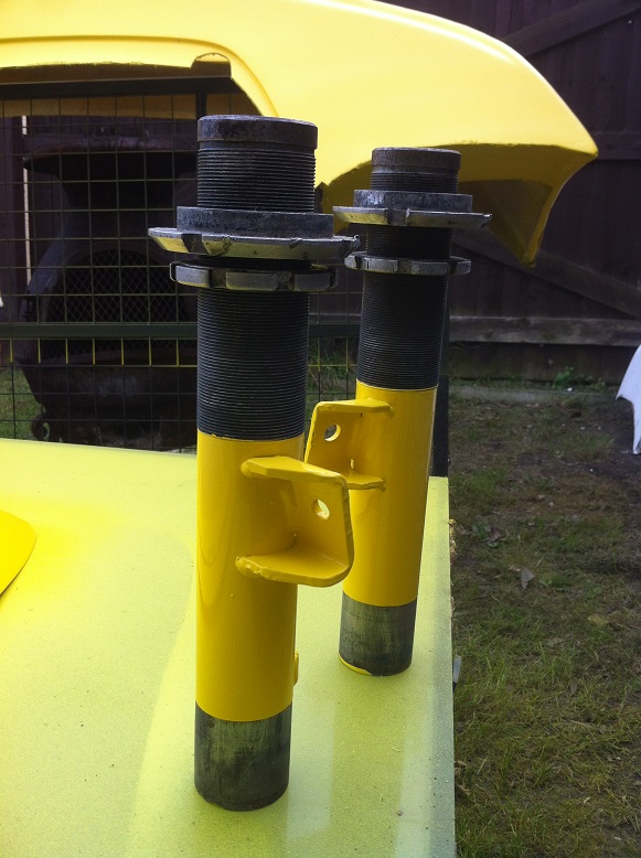

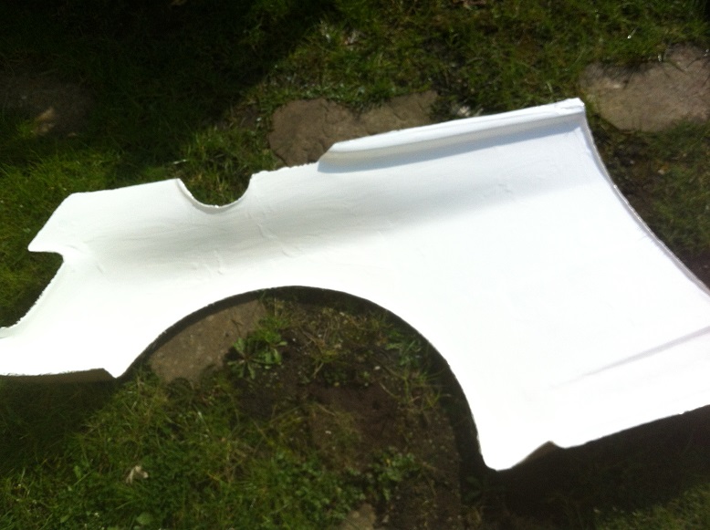

managed to get a fair bit done on car over weekend , made some spare kevlar rear arches and some carbon / kevlar arch guards , as with thinking about doing rallying again am going to make full set of spare panels , also cleaned up all shocks and painted , fronts ready to be built after full overhaul ,

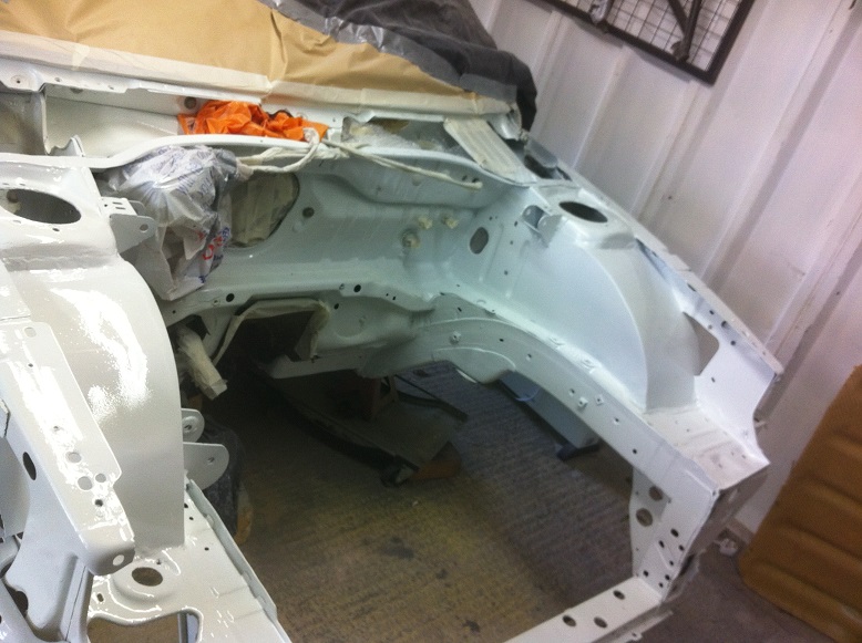

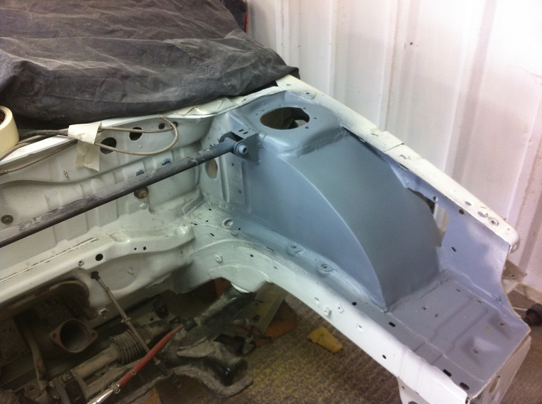

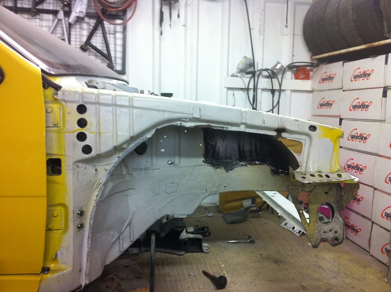

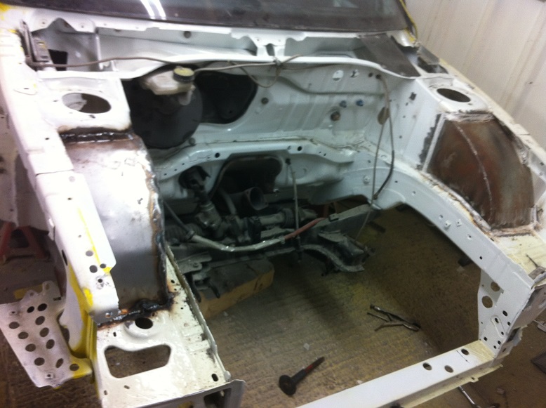

thanks mate , fabricated some front maxi inner wheel arch extentions , just got to finish cutting out existing ones and start welding in the new ones ive made , then can repaint engine bay and start refitting engine and box

Inner arch extensions look good, but why are they needed? Surely if your increasing the front track the wheels would be further away than normal?
[Image: 20120704_212316.jpg]
(05-07-2017, 07:14 PM)Ben Wrote: Inner arch extensions look good, but why are they needed? Surely if your increasing the front track the wheels would be further away than normal?
Ben inner arch extensions are put in as wheels sit more forward and are larger diameter wheels used , sure the track is widened , but still got to allow for when on full lock  with steering , this is what the works 306 maxi had done to them, hope this explains your question

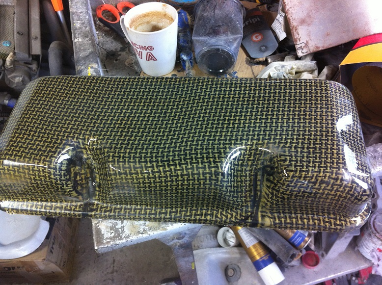

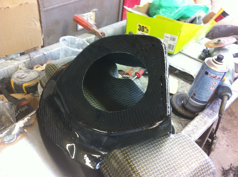

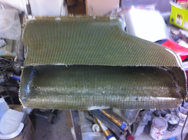

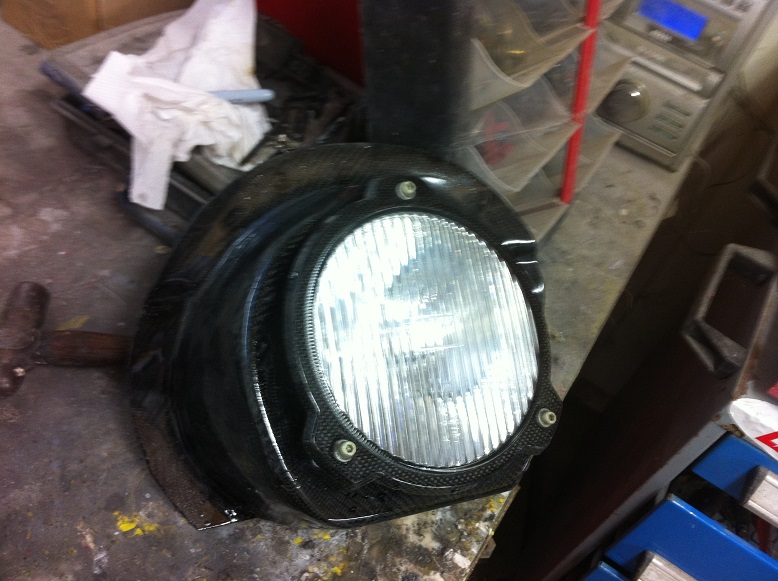

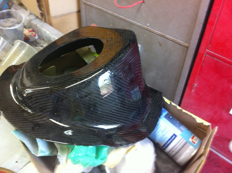

moulded carbon fibre 306 maxi bumper spot light pods  during one evening in week , so manage to remove from mould i made a few weeks back and here they are , also made carbon /kevlar maxi air box parts , wich are pictured , just need trimming and cleaning up

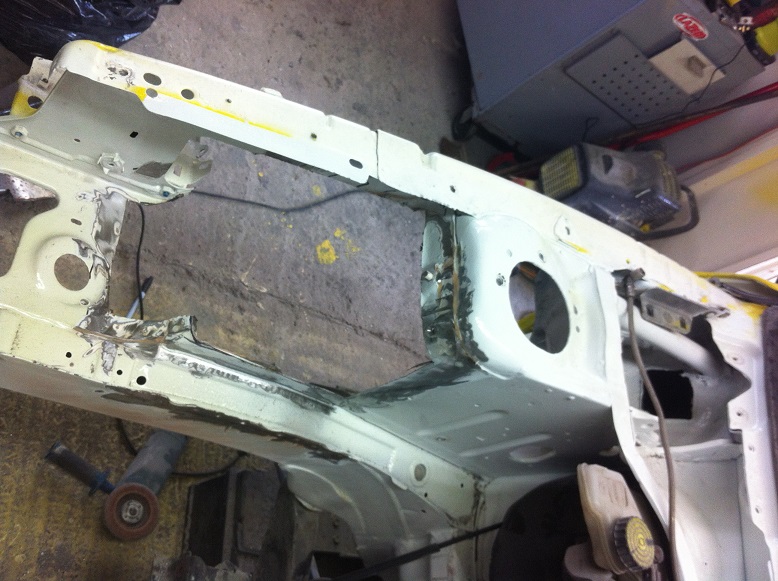

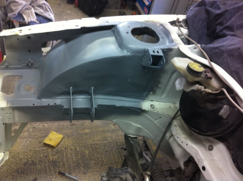

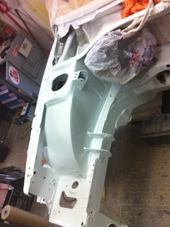

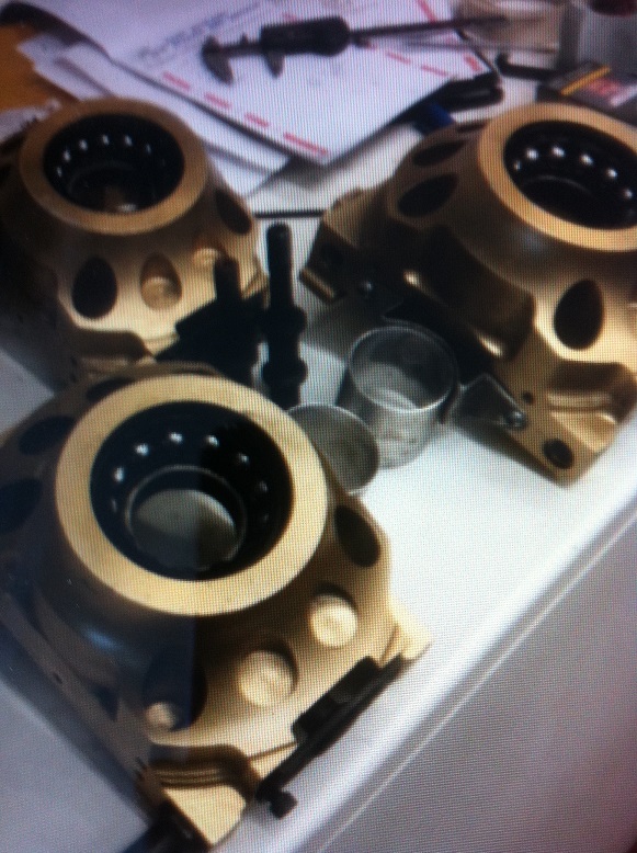

cheers hovis. quick update of what got done this sunday .finished tubbing front arches ,just got to fit a new chassis engine mount now , and then can clean up and paint and also weld brackets on for strut brace , also sent some parts of for fabrication for new alloy front uprights , wich should be done in net couple of weeks , and started fitting lamps to maxi bumper pods
quick update of whats been done on car this weekend , all tubbing of front wheel arches complete , new strut brace  brackets welded on and new engine mount bracket welded in , primed and painted ready to start fitting back together now

Looks epic. Why tube the fronts out of interest?
(06-07-2017, 04:23 PM)twangy Wrote: Ben inner arch extensions are put in as wheels sit more forward and are larger diameter wheels used , sure the track is widened , but still got to allow for when on full lock  with steering , this is what the works 306 maxi had done to them, hope this explains your question
(21-08-2017, 12:32 PM)bashbarnard Wrote: Looks epic. Why tube the fronts out of interest?
see above.
the tarmac maxi cars ran an 18" wheel with a 640 200 18 tyre IIRC, so a good two inches taller than a 195 55 15, something along the lines of a 205 45 18 Big Grin on gravel I think they were runnign similar overall diameter on a 16", so along the lines of 185 65 16.
this extra height as well as the additional castor but retaining the same strut top location meant the wheels were further forwards, not certain exactly how much but about an inch as well.
Ah fail on my behalf there. Sorry everyone.

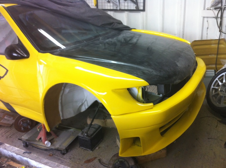

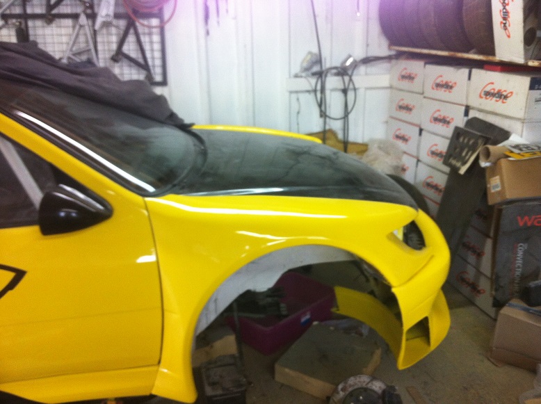

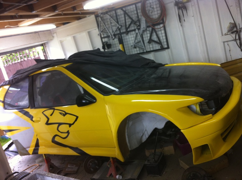

managed to get a few bits done on car this afternoon , re fitted wings and started fitting out engine bay , hopefully try and get a few more things done over bank holiday , thanks for all positive comment ,

havent had a lot of time to work on car lately hovis , as waiting for some bits and with work commitments ,  were its up too now is have fitted front lights and bumper pods , and have been making new full lightweight motorsport braided loom for car with proper connections wich takes time in its self  ,also got all tyres fitted onto speedline rims , wich has give me a load more space in mancave, hopefully going to get time on car this weekend , so will give proper update then

Quick update,In the middle of doing full braided Motorsport loom wich is nearly complete , gearbox getting fitted with 4.9 cwp then can fit engine and box then can make up new engine mount, hopefully picking up new front maxi style suspension next week as all machine work done ready for fitting , will add pictures over weekend
