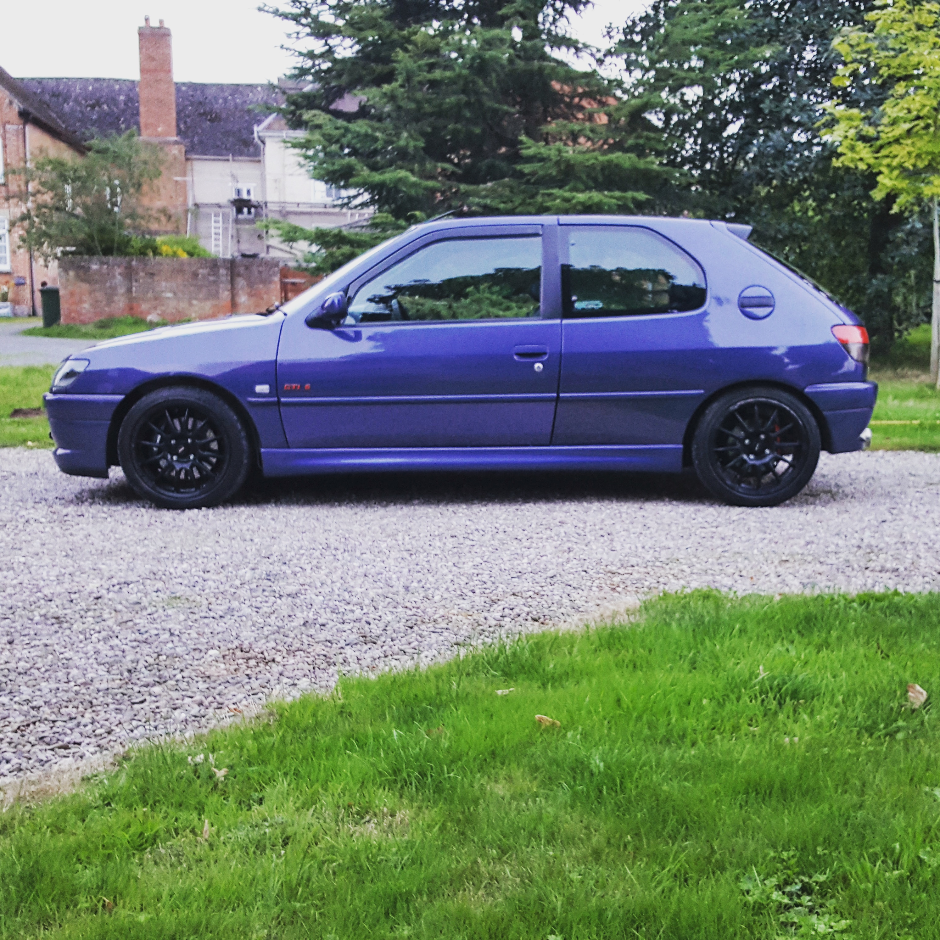

Standard gti6 torsion bars but I have a hybrid rear anti roll bar with 28.5mm and 25mm ends rather than the standard 24mm. I prefer this setup to having 21mm torsion bars like I have on the dturbo daily

Changed the front springs again (third set this year) for eibach Pro 30s as the gmax 40s sat a couple of mm too low. So much better now, rides alot smoother and firmer, not crashing over bumps anymore either.

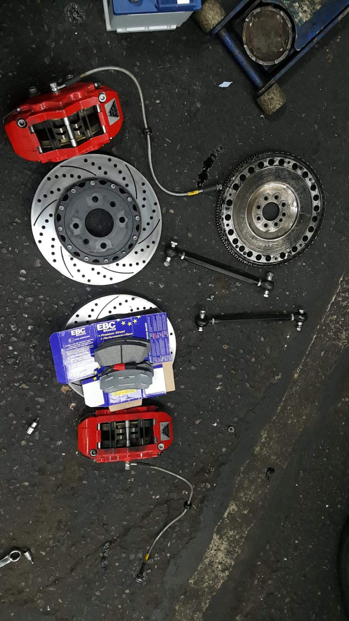

New brakes on the way, 6 pots this time which is huge overkill but they came up at a good price plus even with the extra pistons they're still thinner than the 406 brembos therefore giving me the choice of wheels fitment I was after
Small road trip tonight to get some parts for the next batch of upgrades ;Wink
305mm bells and rotors with 6 pot calipers and ebc yellow stuff pads
Adjustable droplinks with mot friendly rubber boots
Ultra lightweight flywheel (I'll do a weight comparison when I change them over)
Some brand new blackmasked lights (annoyingly I melted the lens of one of the current ones with some thinners Sad
An intact battery and ecu tray with all the clips still in one piece
And some Peugeot sport numberplate surrounds as I've always fancied having them to fill the gap in the numberplate recess a bit better
Oh and this is how the car sits now everything's bedded in :Smile

They're pug1off branded but all the part numbers for the caliper come up as AP for Aston Martin vanquish, so look they're just an ap caliper with a Peugeot hub adapter and a different face plate
New brakes fitted tonight while I was waiting for the Mrs.
305mm rotors
Ebc yellow stuff pads
6 pot caliper
Perfect fit inside a 16" rim, and the best bit is that I've gone from having a cigarette paper of clearance between caliper and wheel to over 15mm compared with the previous 406 brembos!
Not had much of a drive yet as it was horrible weather but first impressions are a very good improvement over the old setup and that wasn't exactly a bad one!
Also fitted some Peugeot numberplate surrounds as I've always thought about getting some to fill out the 306 plate recesses a bit better Smile

These are  Peugeot 406 fitment iirc so et15 I think I remember? Only went for these as they where a great price with new tyres at the time, just run them with a small spacer, team dynamics pro race 1.2

Yeah I had braided, use a 306 flexi to a little adapter made out of copper brake pipe

I guess you could buy the calipers but I highly doubt they'd be cheaper than buying them through p1o, Aston owners hardly worry about the money a pair of calipers cost I guess.
Plus then there's the hassle of having adapter brackets made, buying disc bells, brake hoses, pads, rotors....
Pretty quickly it'll come up to way more than p1o prices I'd guess

Here's the 90 degree elbow you need, easy enough to make if you're handy with a brake flaring tool and they do fit under 15" wheels even with the 288mm xantia discs, the biggest issue is space between the caliper face and the back of the rim as these calipers are extremely chunky!
My new 6 pot setup has gained me about 15mm from where there was only a cigarette paper of clearance before
