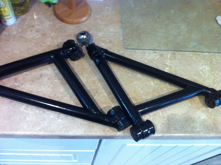

refurbing all front suspension , here are the PTS tubular adjustable front wishbones , ready for going back on car

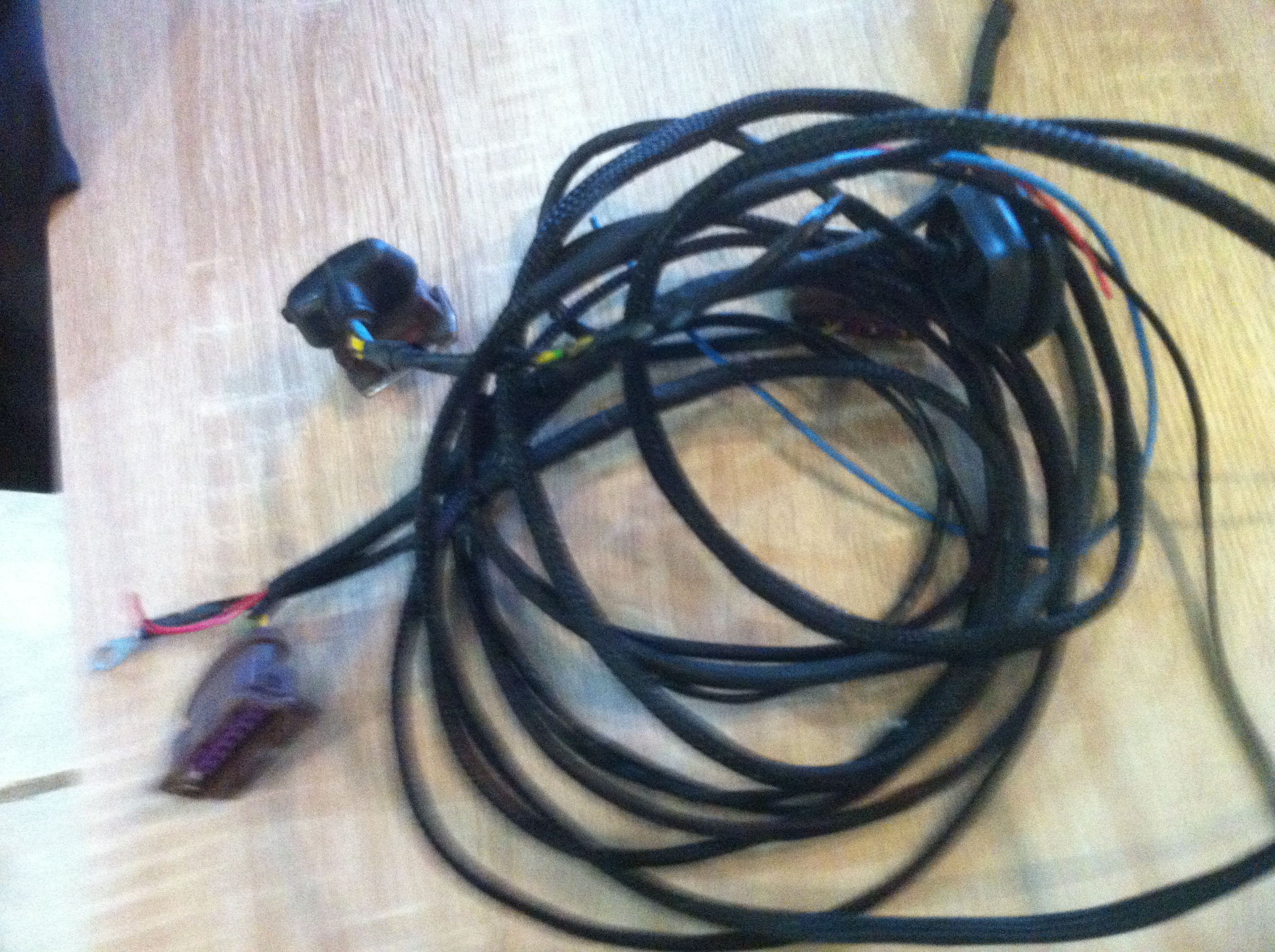

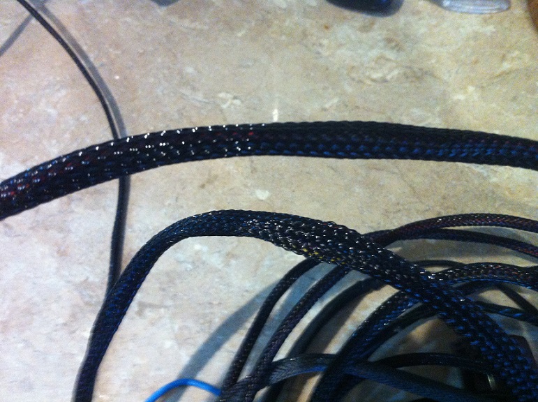

started making lightweight motorsport loom all with overbraid
Those bottom arms are a work of art!
(18-01-2016, 08:32 PM)roland rat Wrote: Those bottom arms are a work of art!
yes mate ,they are genuine PTS bottom arm i got hold of ,slily money to buy new for what they are
how on earth do you thread braid? (respect!)

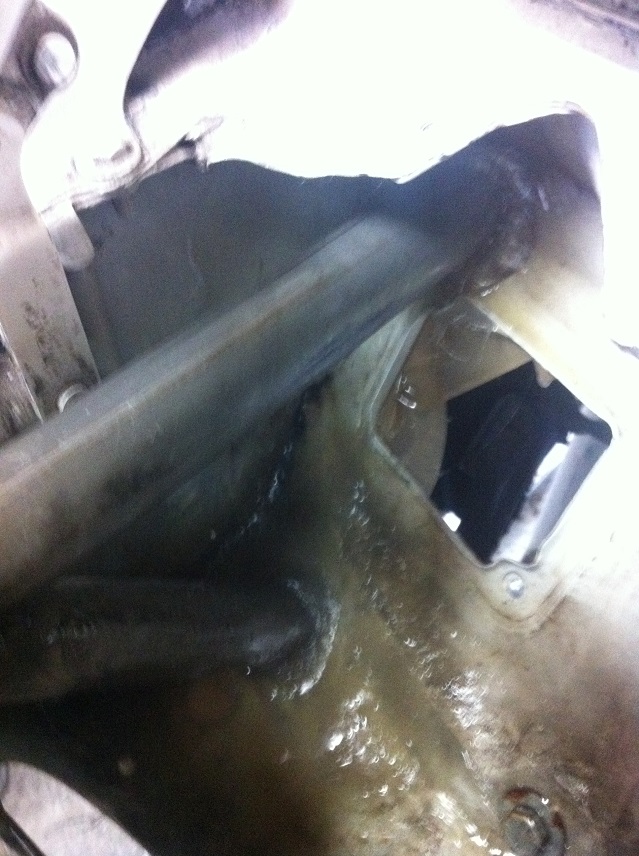

How did you ensure the subframe didn't warp while welding may I ask?
Loving this by the way... Only project that makes me want a perv
(18-01-2016, 10:12 PM)Piggy Wrote: How did you ensure the subframe didn't warp while welding may I ask?
to stop subframe from warping when welding  you do  a inch weld 1 side and then weld opposite side and  so on , just not concentrating welding in any one area , it just take a bit longer so as not to get any heat distortion mate

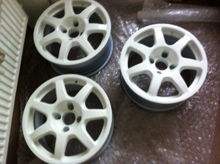

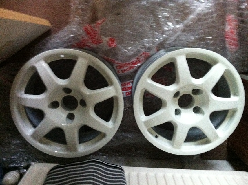

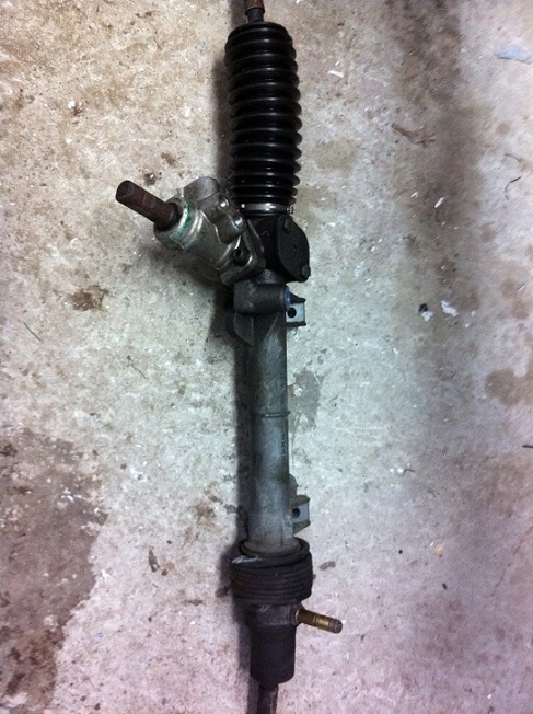

vts steering rack delivered today , also got aload more carbon fibre , 16sq metre in total so can make some more lighter panels for car , and cleaned up and painted 5 alloys for the wet tyres to be fitted to , so have absolutely loads to get on with car
Arrgghhhnomnomnomnom
Love raceline rl 7 alloys!!!

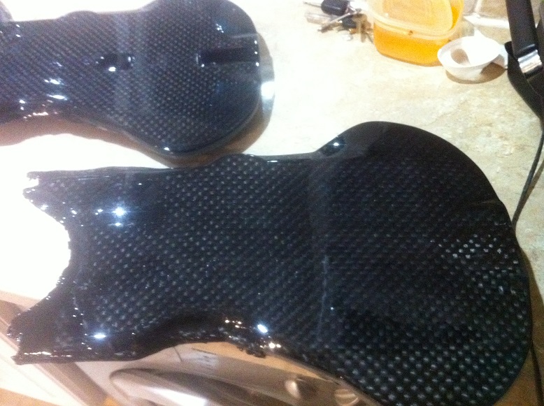

right found out nobody makes carbon fibre cambelt cover ,so made mould and layed up in carbon fibre , so will remove tomorrow and see how it turns out like .then might make some more
right  pulled first carbon cambelt cover from mould  , but decided to make phase 2 cambelt cover , so  just ready for final trim and flat and polish ,ready for engine build

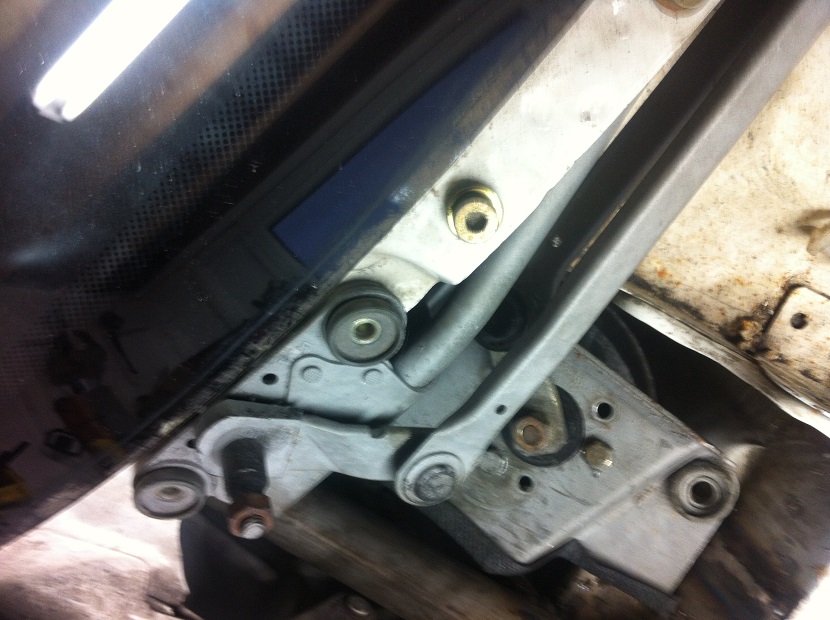

managed to triangulate drivers side strut turret  , and modified original wiper motor by turning motor and drilling the 3  fixing holes that hold motor and trimming mounting plate , so all fits in original mounting holes , so  primer new cage work this weekend hopefully
Nice, mine has to use a zx single wiper due to the cage..

(03-03-2016, 08:23 PM)adam b Wrote: Nice, mine has to use a zx single wiper due to the cage..
no what you mean  adam , its a bit of a tight space but with a little bit of alteration , went in easy , and saved me having to buy another , so really happy how it worked out mate
