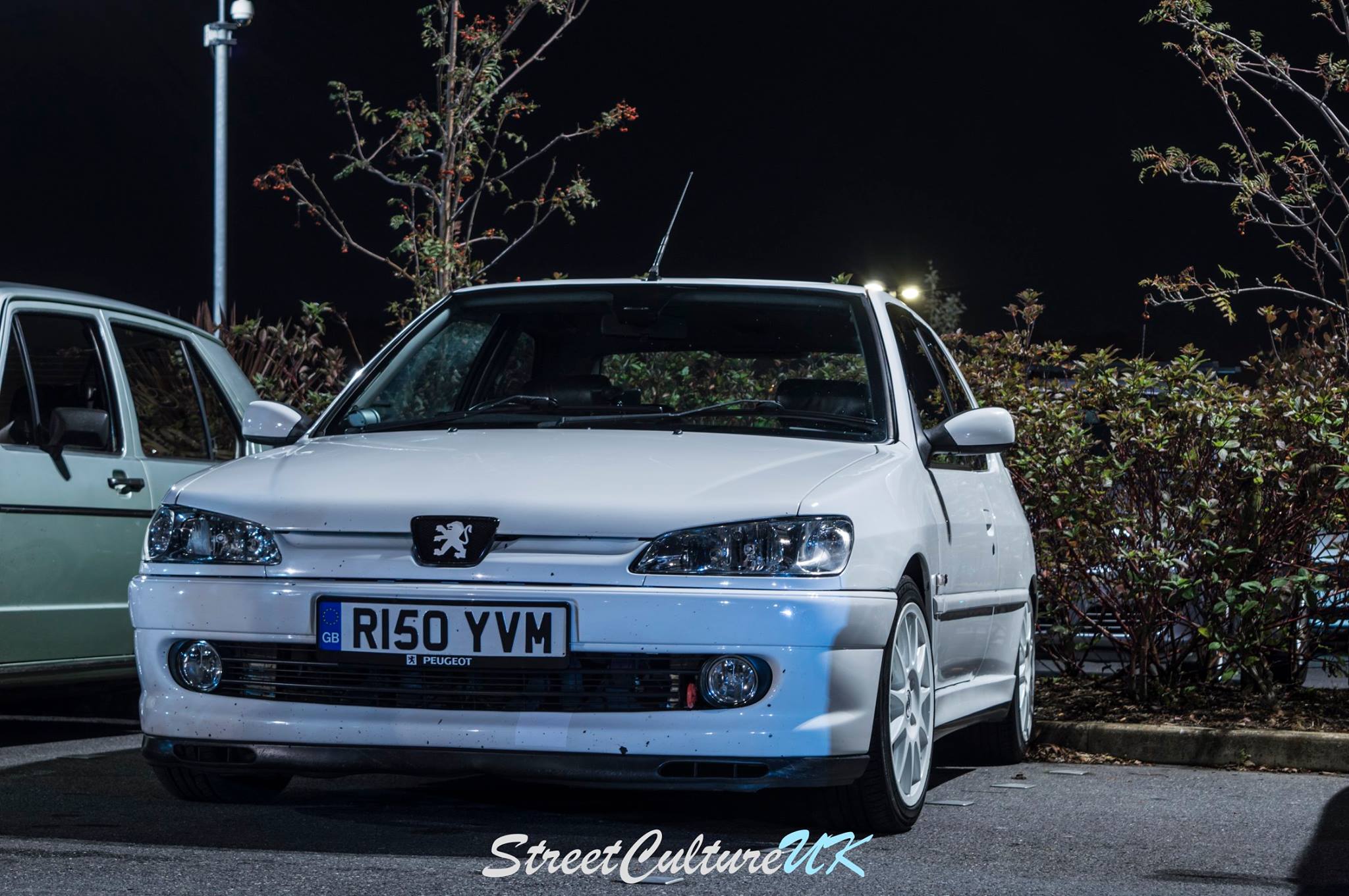

well around 2000 miles on the new engine and it flys!
went to a car meet in Plymouth last night, met up with a group at Exeter services
for a convoy to Plymouth, which ended up as a race along the A38,
was suppose to meet frosty and James on route but ended up flying past them
as i was playing with Nissan skylines Big Grin
after a while thought better of it so slowed and waited in a lay-by till frosty caught up
the car meet was one of the biggest ive been too police were blocking entrances to full carparks and directing people to other parks
