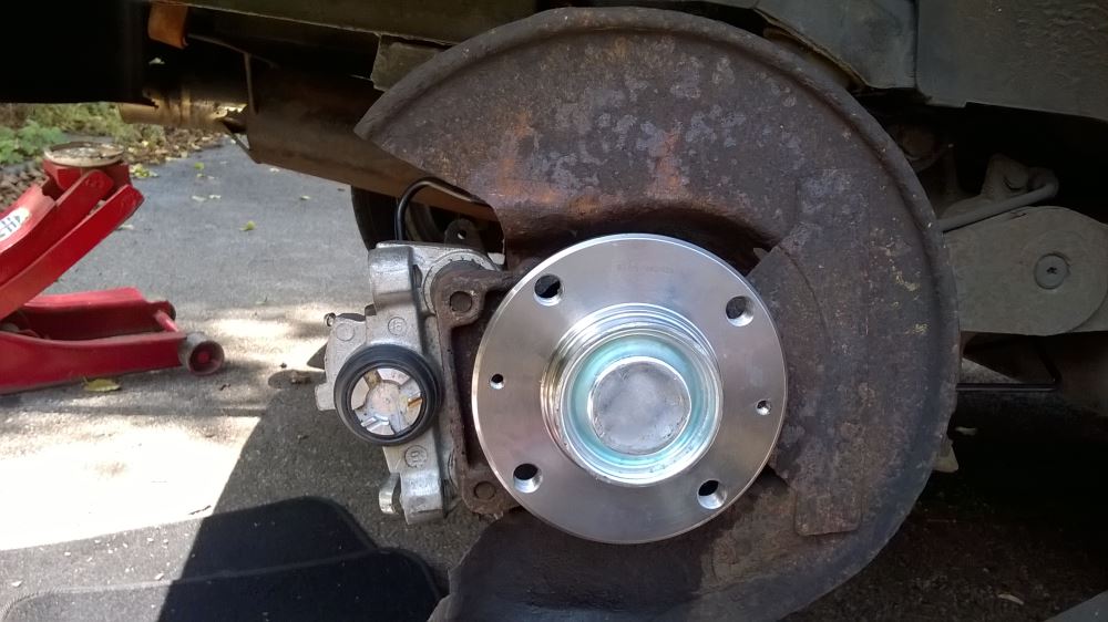

So before pugfest I fitted a new caliper, hose and bled the brakes again and fitted a new hub as it had stripped on wheel bolt and felt like it was gonna do another.

Are the hubs just bolt on? I mean do you just buy them and they are 4 bolts? Mine are stupidly rusty so if its cheap enough might just be easier to get some new ones and smash them on.
(19-07-2015, 07:42 PM)Eeyore Wrote: Are the hubs just bolt on? I mean do you just buy them and they are 4 bolts? Mine are stupidly rusty so if its cheap enough might just be easier to get some new ones and smash them on.
The rears are just a centre nut. Super easy.
Looking good man. Hope to actually see this at some point.
Yeah the rears are just a 32mm center nut that is easy enough to undo with a long enough bar.
Only issue I had was the inner race being stuck on the spindle but fire and hammers eventually sorted this although there isn't much space to get anything behind it to force it off. If I do the other side I should probably do a video guide.
Just use a puller
Then the inner race always is a bugger, but crow bar/chisel to get it moving then get the puller in again
Aww f*ck I forgot I own a puller!!!!!!!
f*ck sake!!
