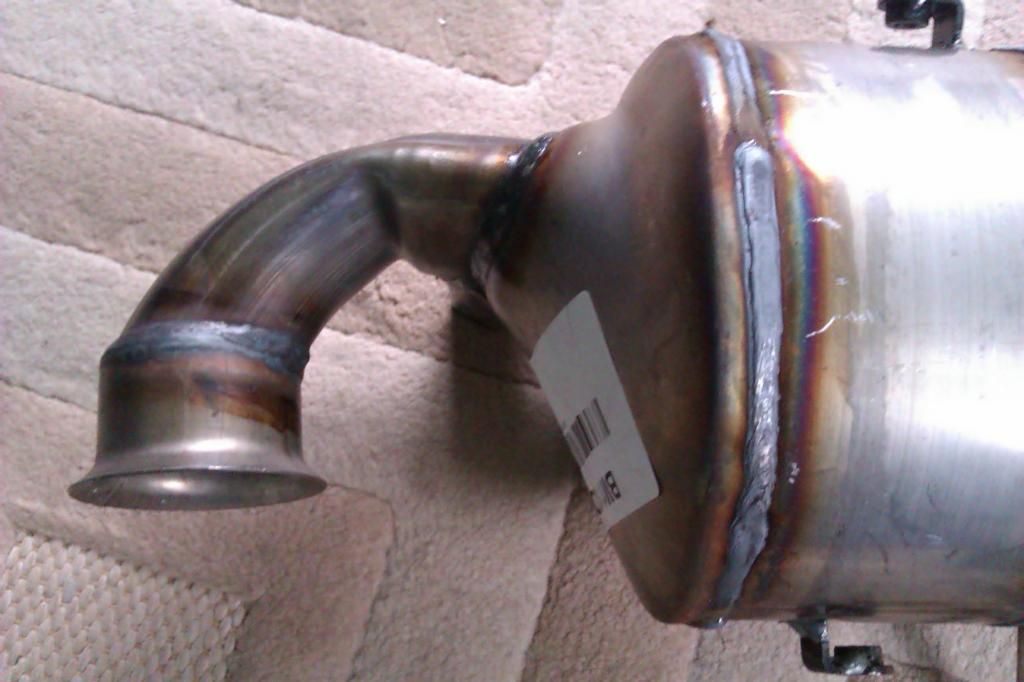

Hmm, having a better look at the DPF. The crush bend at the top looks pretty restrictive, and I'd assume it to be a mandrel bend on the original? Is it likely to make a noticeable difference on something with such a small amount of power?

Youll not notice a difference, i presume the bend is a bit flater on the corner, all cheap exhaust parts seem to be like that.

(19-11-2014, 10:08 PM)Toms306 Wrote: Hmm, having a better look at the DPF. The crush bend at the top looks pretty restrictive, and I'd assume it to be a mandrel bend on the original? Is it likely to make a noticeable difference on something with such a small amount of power?
Why do I always find something to worry about!
The bend on the original is probably the same. Stop bloody worrying and get on with it.

Well, more than a bit flatter tbf...  Probably lost 60% area there.
They picture it well n ads so it can't be seen. But others look like proper bends, eg - http://www.ebay.co.uk/itm/FORD-FOCUS-1-6...1c2be75254

(19-11-2014, 10:34 PM)Niall Wrote: (19-11-2014, 10:08 PM)Toms306 Wrote: Hmm, having a better look at the DPF. The crush bend at the top looks pretty restrictive, and I'd assume it to be a mandrel bend on the original? Is it likely to make a noticeable difference on something with such a small amount of power?
Also, oil filling up with diesel? Id expect a little blow by but if its noticeably filling up the oil, that doesn't sound good!
Theyll fill the oil with diesel from continually trying to regen, but yeah its not the best thing to have pumping around the engine.
Considering the OEM DPF costs £800 I'd hope they use decent bends!
Active regens use post injection to heat the DPF, it's that that causes oil issues, especially switching the engine off while that's in progress - which is every day atm!

Thats pretty badly made, you could always cut the bend of your old one and weld it onto the new one if you really wanted to.

that pipe looks like its been dropped on its end

(20-11-2014, 06:20 AM)cully Wrote: that pipe looks like its been dropped on its end
This tbh.. That looks kinked rather than bent lol

That looks damaged to me
Duno what pic you're looking at tom, but thats quite clear to me!
No kink!

That's the ~£400 link I shared, not made by the same place as the sub £200 one...
I did wonder if it'd been dropped, but surely the hole wouldn't be circular if it was dropped with enough force to cause damage like that?

Only just seen that pic. That's kinked tom!

Sent an email to the supplier...
Quote:Hi Tom, I am sorry to say that the unit you have received has been damaged. I will request that the factory send you another unit.
Sigh... I had one f*cking chance to change it as well, won't get the chance next week so it'll be a fortnight before I can give it another go.  Admittedly the supplier replied very quickly and is obviously happy to resolve the problem which is good.
