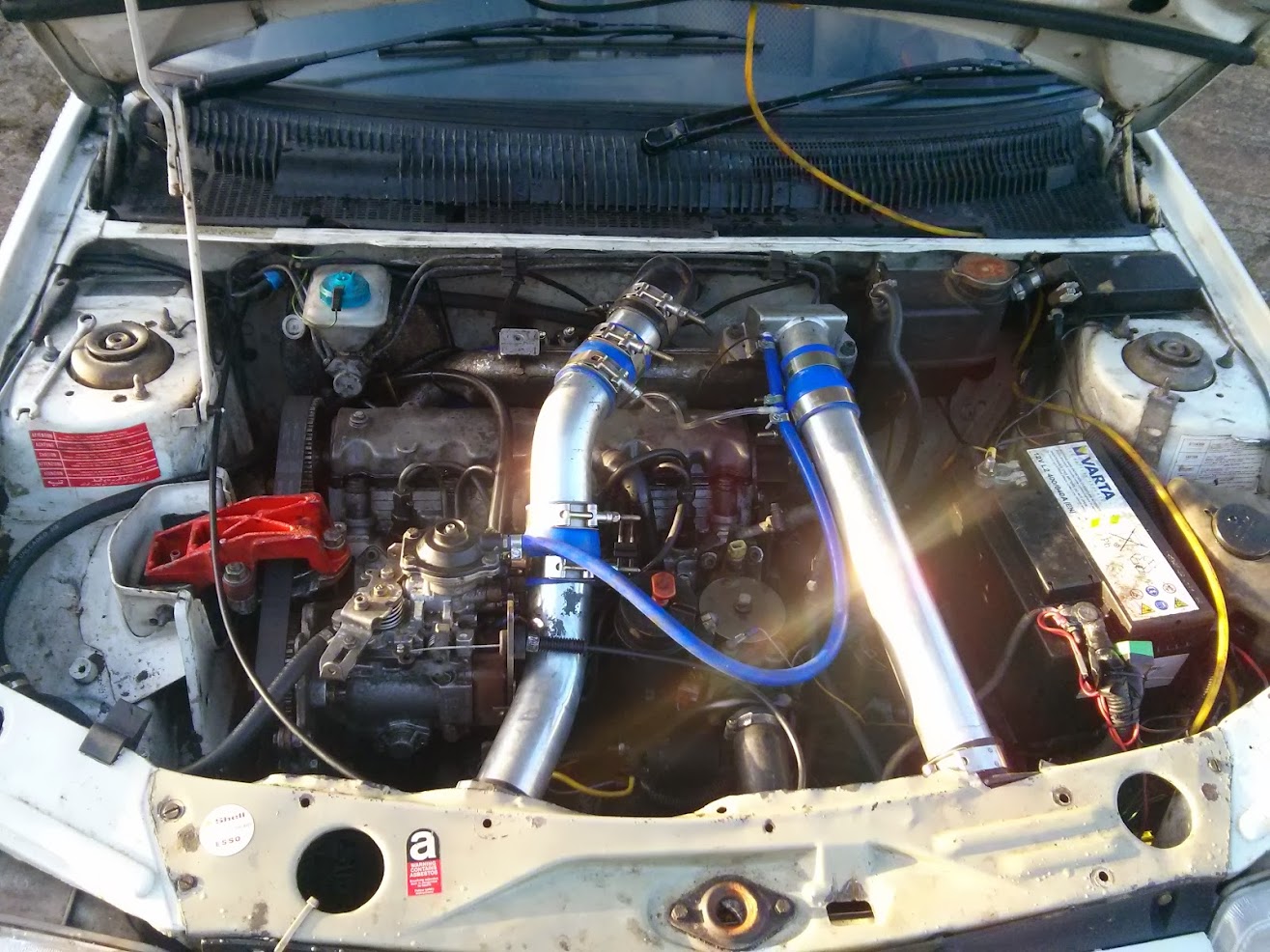

Right so I didn't touch joey yesterday cba! But today I got it all timed up and and cranking over, and the pumps not working, one delivery valve is spurting fuel but the rest arent, that combined with no fuel coming out the return pipe when cranking makes us think vane pump, so the pumps back off to get torn down again. Good times. If anyone wants to come join in, be my guest.

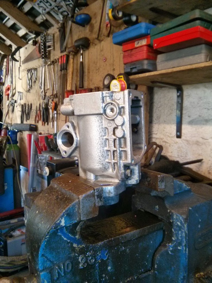

More happened this evening, pump torn down again. I put the vanes in the rotor the wrong way round, little things eh :/ anyway

Got it running today and its running crap, Throttle does nothing Til the last little bit of it, squeezing the primer makes it rev up more which screams vane pump, starts a lot easier after priming as well, I could hold it at full throttle and it would sit and 2k and priming made it Rev up more. I got so pissed off with it , wentbto run it back up and film it for Darren and I left the locking key in the fly, snapped that off and its now a lot shorter but still wedged in the fly and the engine casing and I could turn the engine either way to get it out. So I threw a hammer across the shop said a lot of words I don't use very often and then left it. I don't want to work on cars ever again.

Been talking to Darren about this recently and came to realise that there not much point in me fault finding this because quite frankly i havent got a clue. So Darren and Chris came out this morning in the landy and we towed the 205 back to lobb land where Darrens going to pull it apart and find what i've missed. Its a shame for me to not see it through myself but atleast this way my blood pressure has chance to come down and i'll have some love back when i drive it.

Stripped it bare, de greased and cleaned casings:
[Image: IMG_20140119_110515.jpg]
