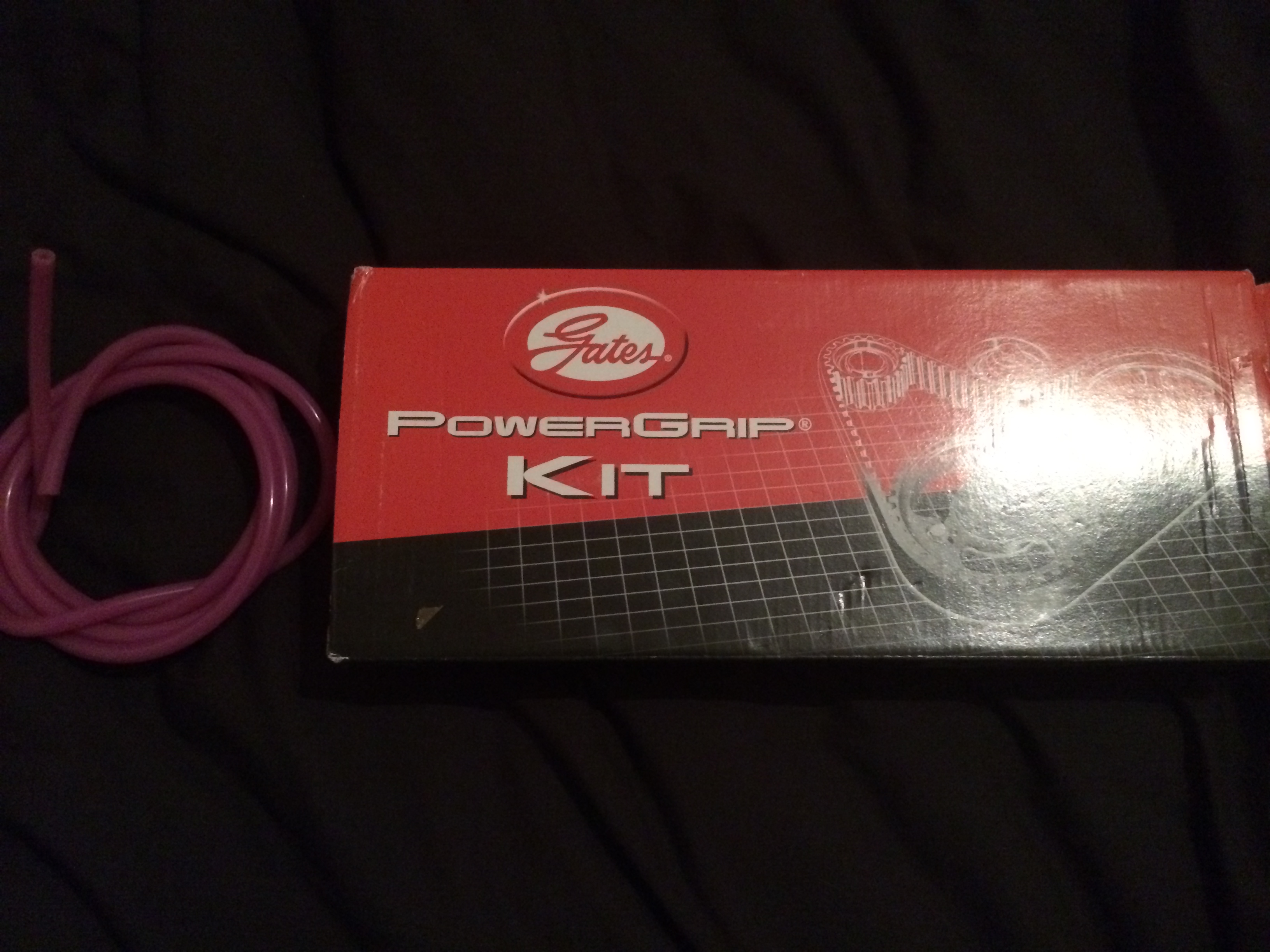

Annnd we are back up and busy again! Payday was last week so ordered a few bits. Firstly, got a bargain Gates cam belt kit. Was on eBay for £70 or make an offer so i made him an offer of £50 and he took it Big Grin

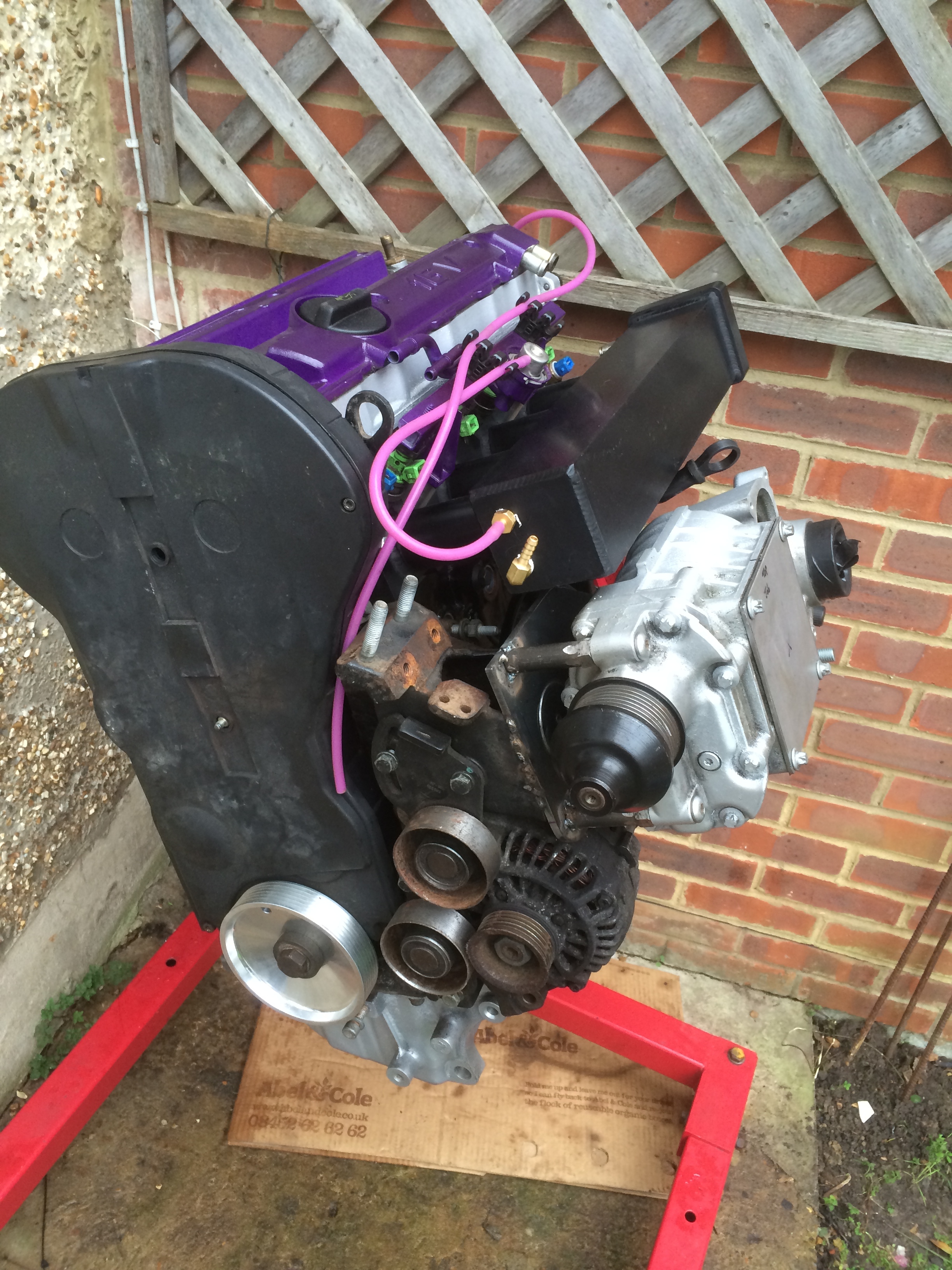

Also got some purple (well in the photo it was purple but its more pink Sad ) hose for the map sensor, boost gauge and FPR and a nice big sheet of metal. Hopefully have the charger bracket mocked up this weekend and the engine timed up Smile

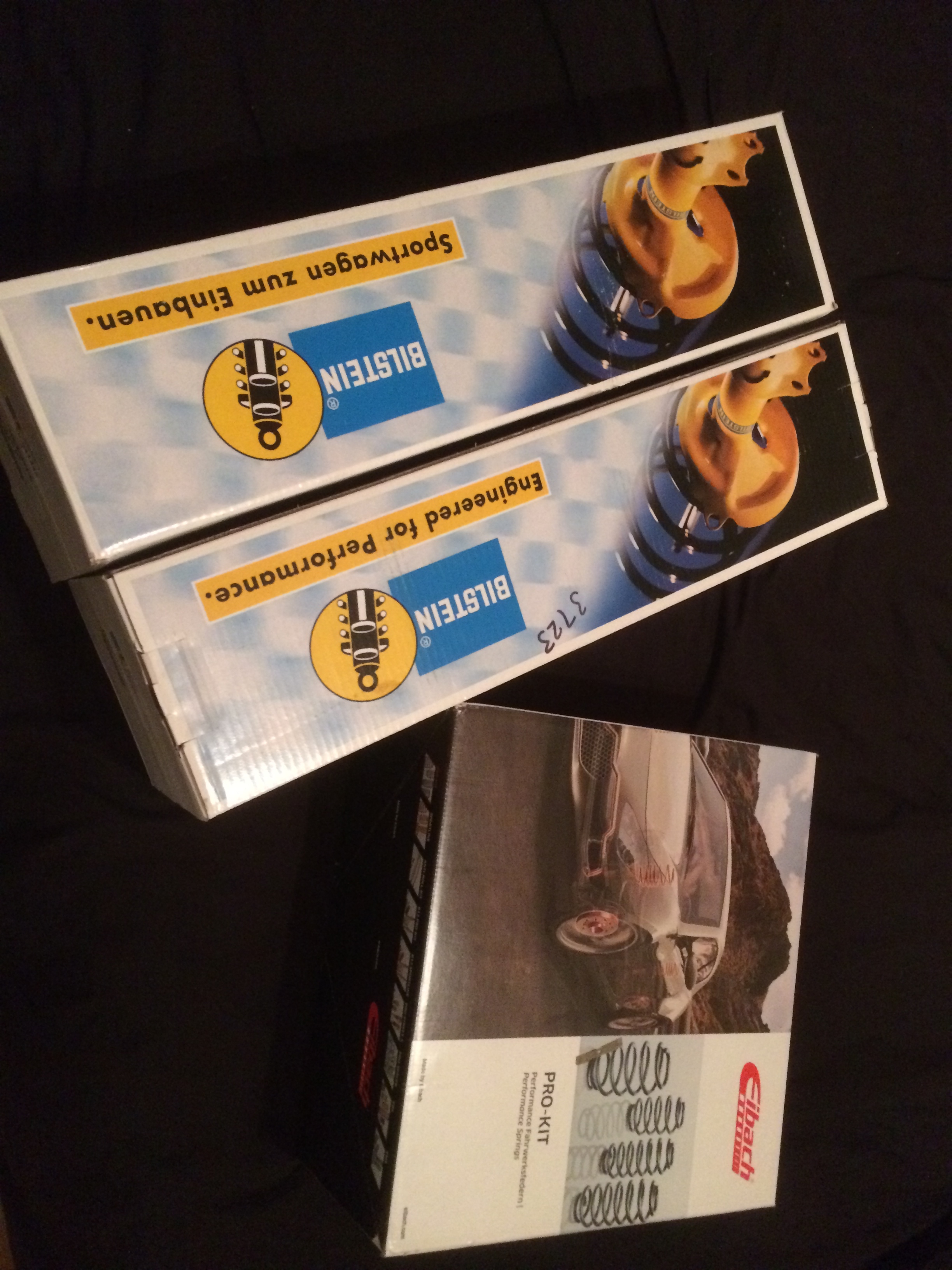

Oh and I've also ordered new shocks and springs as I'm really not getting on with the D2s. The car seems to handle worse and grip less with them no matter how i set them up but then I'm also turning into a old bastard and want it to be more comfortable lol.
Awaiting me when i got home was a massive parcel which contained this lot.
Bilstein B8 shocks and Eibach Pro springs to replace the D2 coil overs. This is the same setup i had before i bought the D2s and it way a much nicer ride.
Parts hoarding is going well. Room is starting to look like a bloody stock room but hopefully it will all be fitted in the coming weeks!
Ooh big pile of bits
My old D2's by any chance?
Well they weren't gonna be pellowe's lmao
True that, wounded were they went
(04-12-2013, 06:43 PM)sam Wrote: My old D2's by any chance?
Yes mate they are Smile

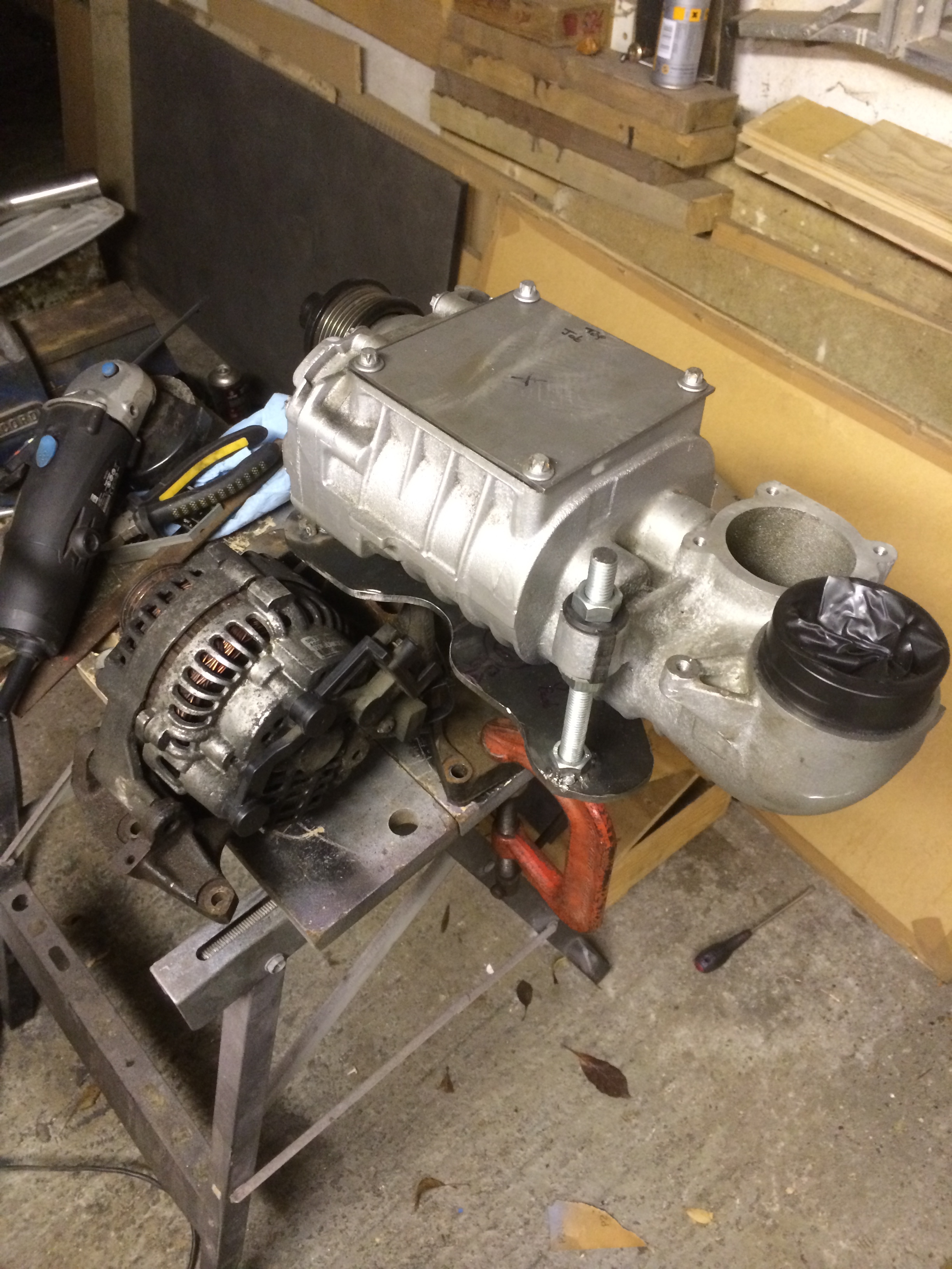

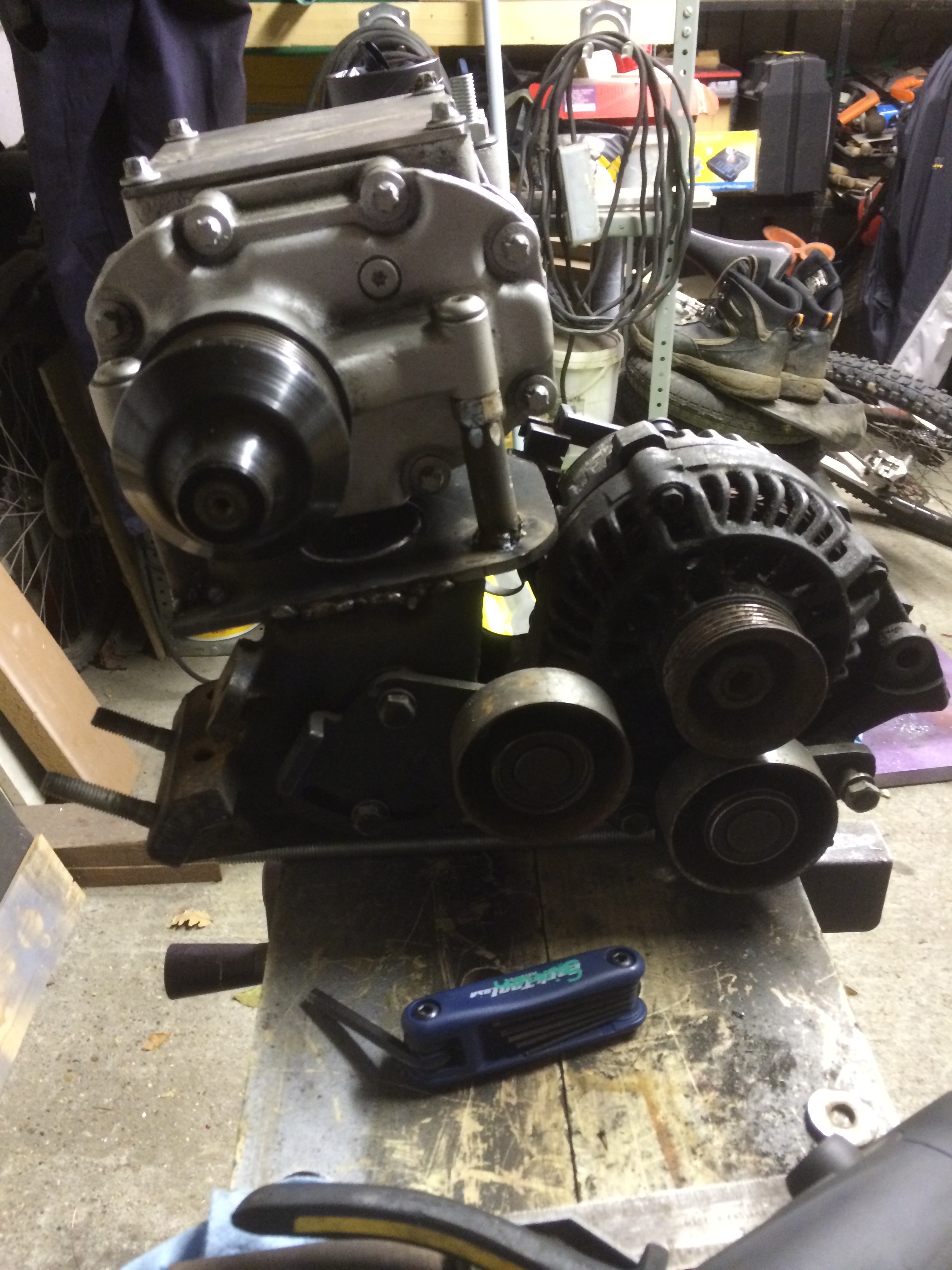

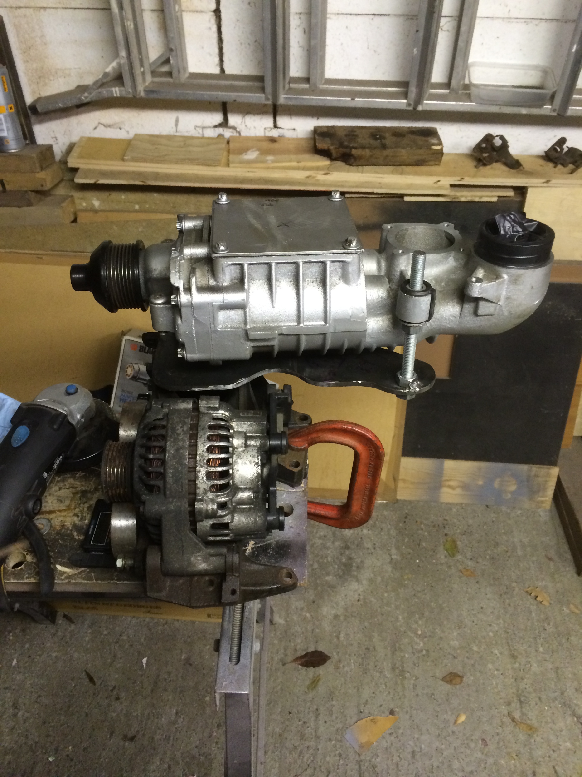

Charger bracket is all mocked up and ready to go! Unfortunately i can't weld it properly as our welder isn't man enough to weld 5mm steel properly so for now, its all been tacked together to make sure its all in the right place and then it will be welded properly one eve this week.
Hopefully get it welded up this week then next weekend i can get it fitted to the engine and go and get a belt then its all ready to drop into the car!
Have to say a massive thanks to Grant for his help with making this over the past few days as he pretty much did all of it for me whilst i stood back and watched lol
Nice one Grant Big Grin
Nice to see it taking shape. You got an intake mani sorted yet?
After typing that, a pic of it popped up. Neat little mani that. Nice colour scheme too.!
