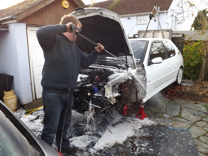

The sun is out so its outdoor jobs today!

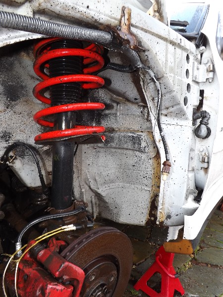

i have been threatening to do it for a while now one side of the front don't have an arch liner, i wanted to check the condition and give the underseal a new coat of paint as it looked damaged in places
can you tell which side didn't have the liner??
yup N/Side is packed with mud!
but the O/Side may need a patch as it feels soft need to get in there with a wire brush and strip back the scabs.
lots of tar to get off from the side without the arch liner before painting
so wire brush kurust and paint is the order in the near future
that needs a phase 1 front end.
Hahahahaha man that arch is lagged!
Probably how my drivers arch is going to look when I get round to changing the wing.
Bloody hell has some one been off roading in it??
Can come clean mine if you want cully been sat there for a month haha!

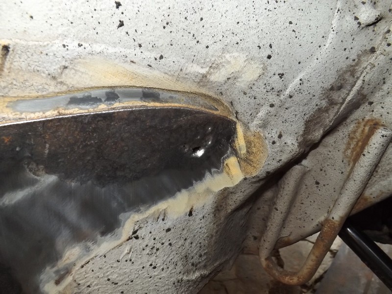

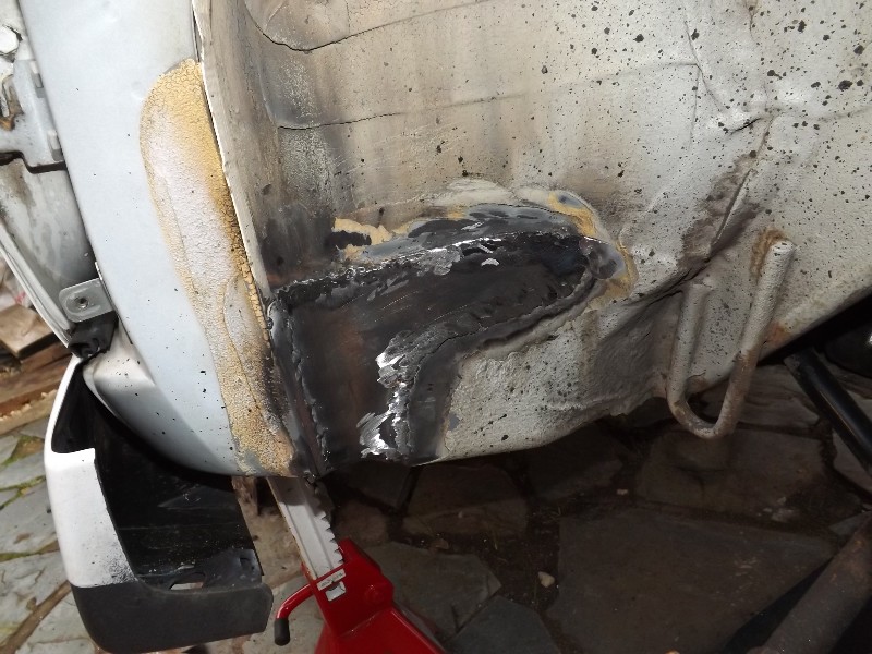

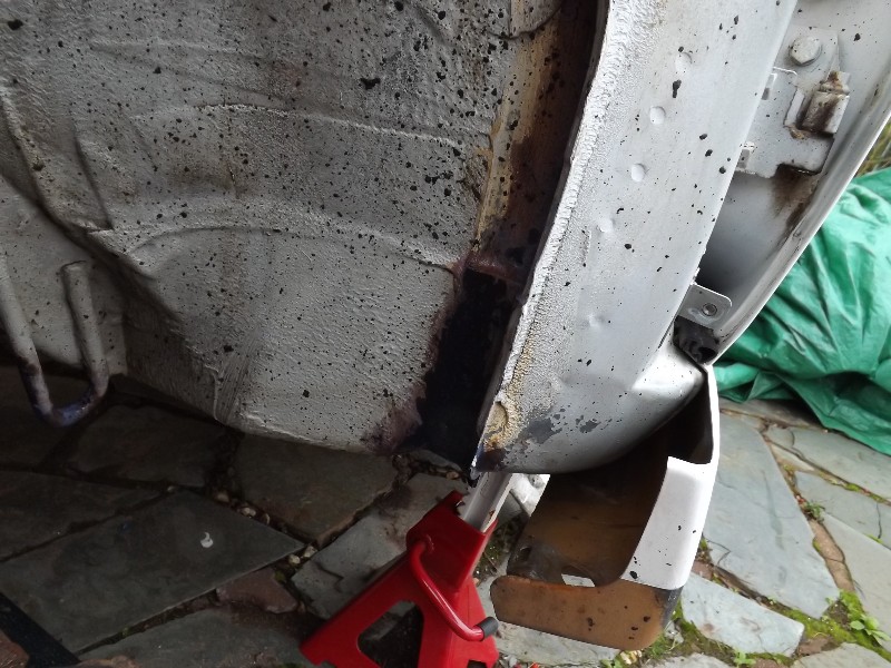

been poking around the front archs ive found some Holes!
so ive cleaned back to good metal and welded in a plate Smile
must be double skined there as it didnt burn through on fire watch
have also cleand back the passenger side and it looks good quick coat of Kurust to slow the brown evil
will have to do the drivers side tomorrow as the light is begining to go now

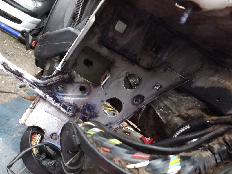

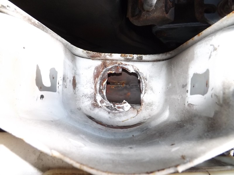

yup my suspicions were correct !
Top engine mount chassis cup is broken!
i cant find the bits of metal that are missing, the mount has what looks like a large washer so i think its been bodged before!

Did you notice anything when driving?
Bit of a pain but you'll now know it's done, when you sort it.
(19-11-2013, 12:09 PM)mr_fish Wrote: Did you notice anything when driving?
earlyer in the thread i was saying the backend was skitish and loose coming off the throttle
im wondering if this is the cause engine moving transfering the weight around
thoughts ?

I had that white ph1 DT that had a broken mount. and apart from a bit of a knock up the front (thought it was a wishbone bush) it felt funny coming off the throttle.
As you say, come off the throttle, engine tries to move a bit and the inertia creates that feel. Would be increased in a GTI due to the engine being heavier?
