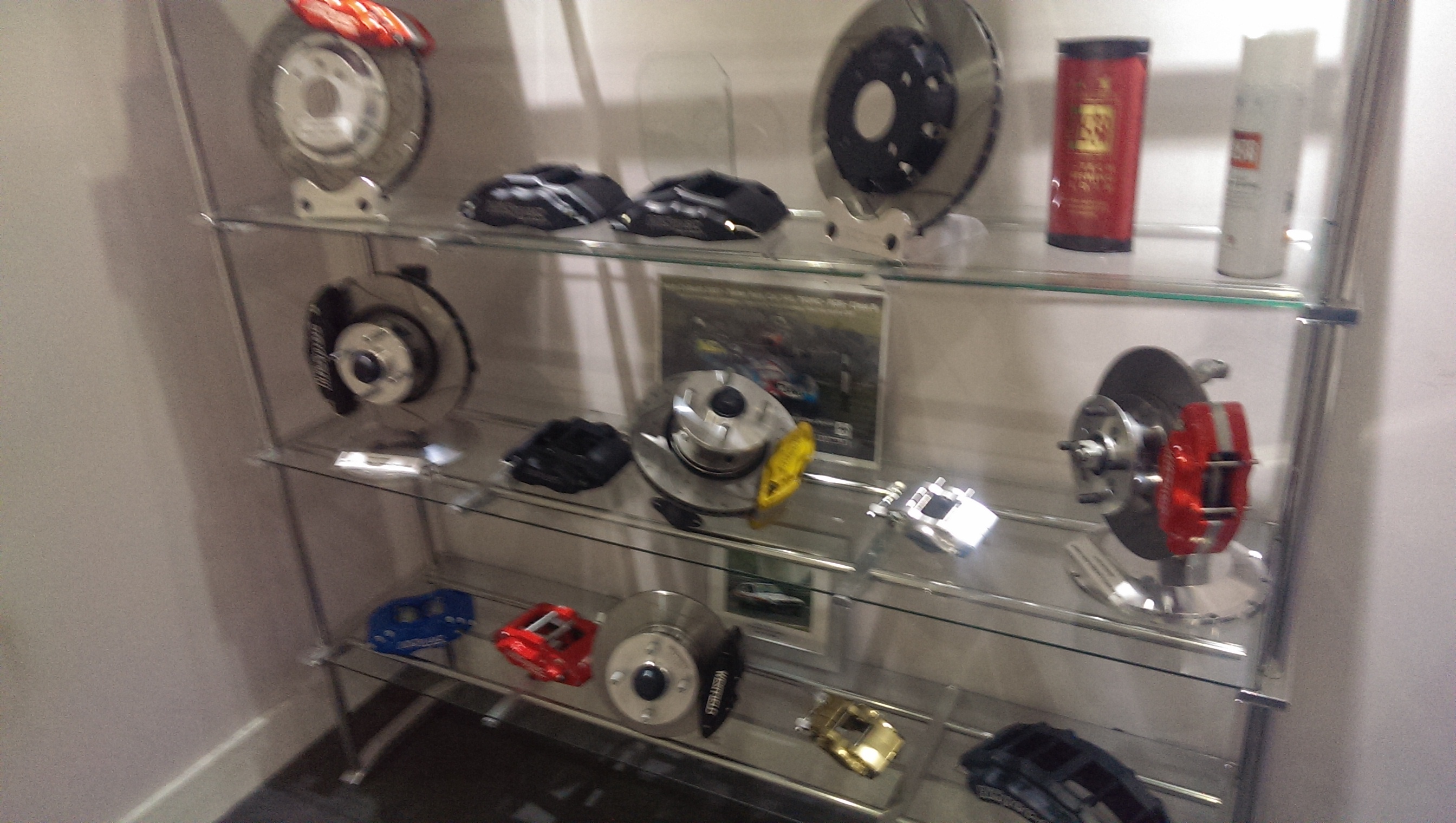

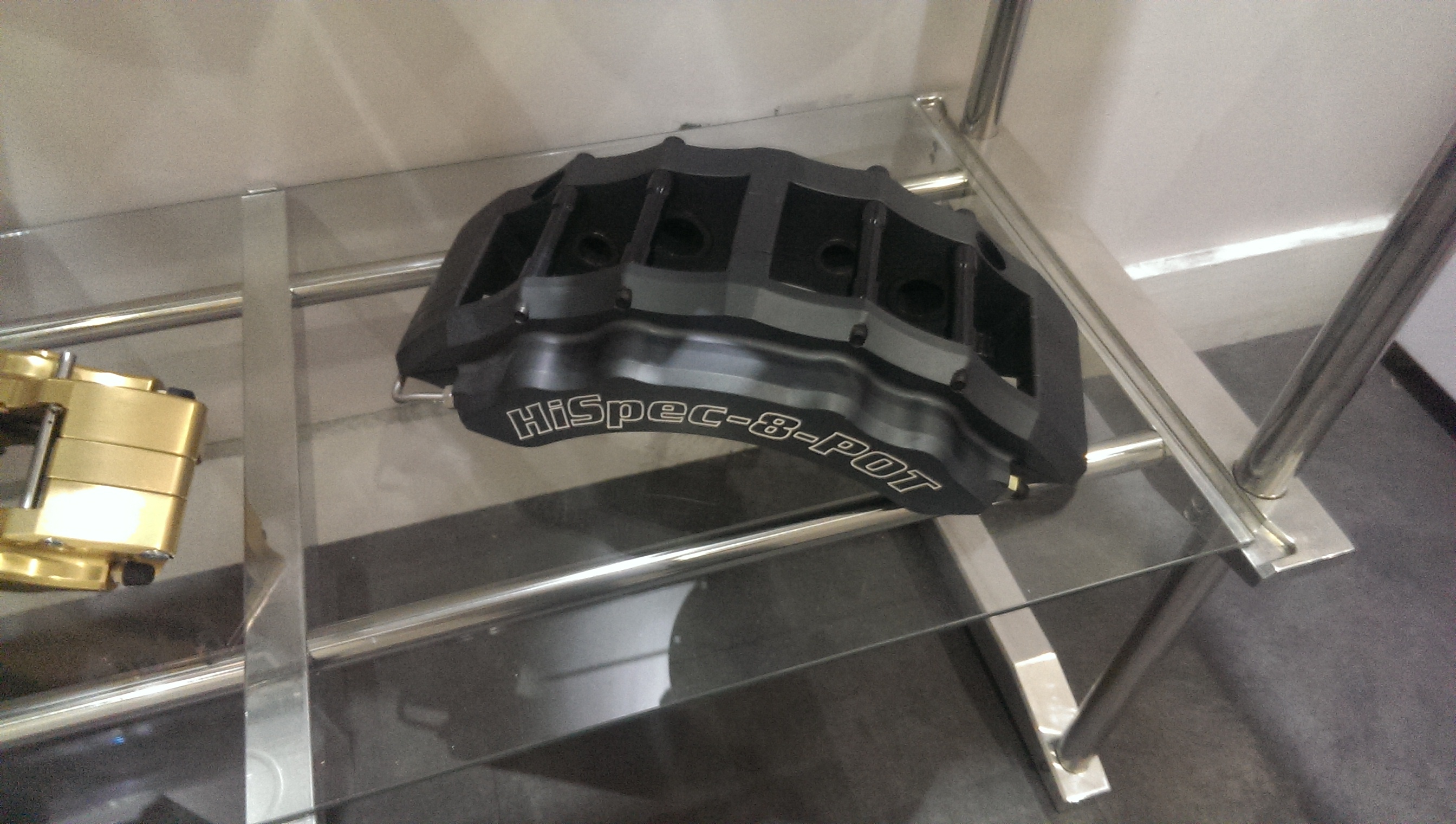

Went to Hi Spec's offices/warehouse today seeing as i was on a course 100 yards up the road to get some bits for the calliper refurb. I feel very inadequate in the breaking department after seeing these

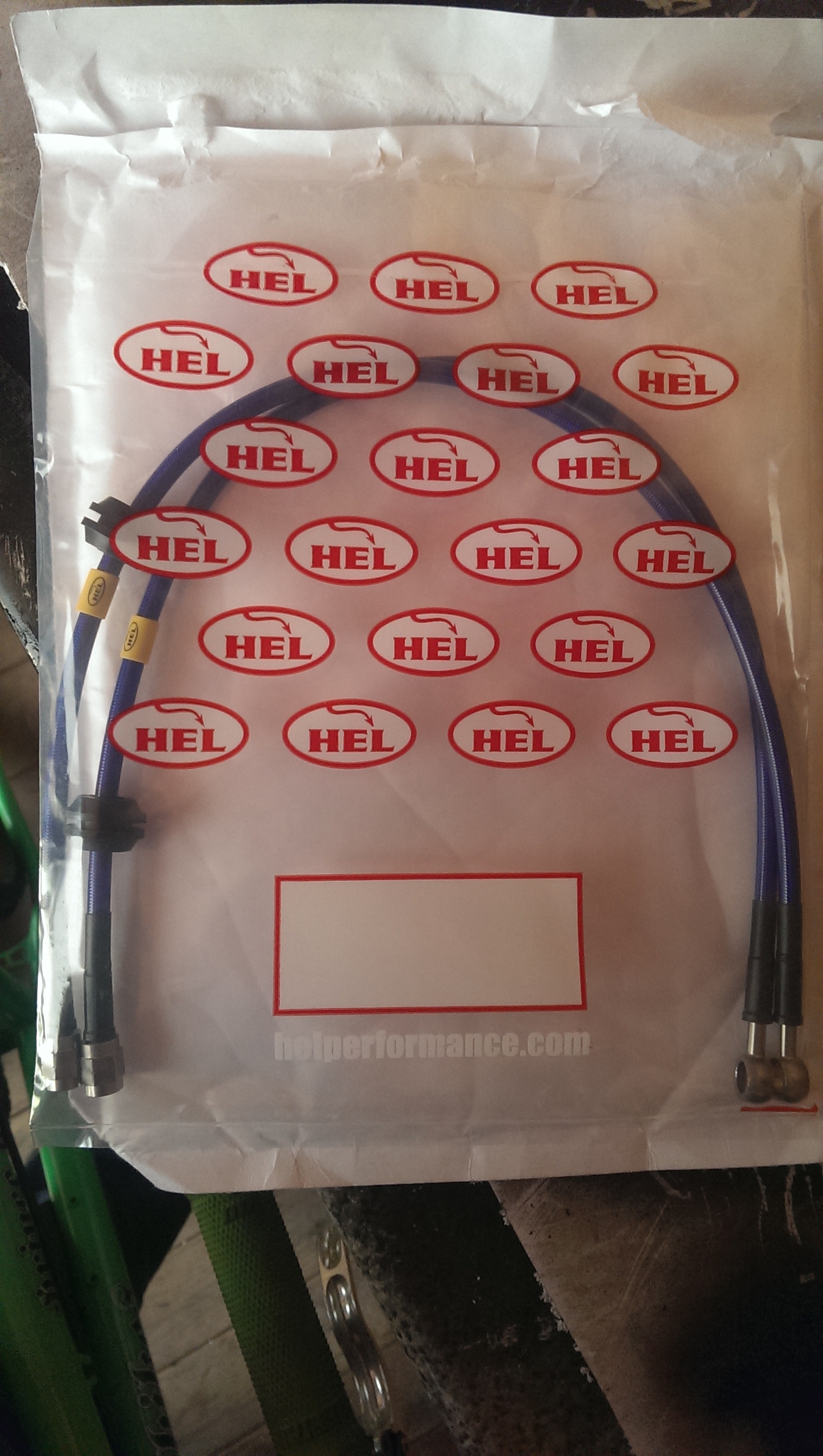

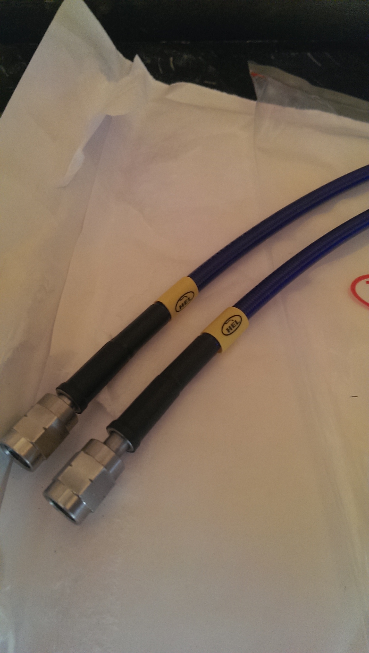

Anyway, got home and there was another nice package waiting for me Big Grin

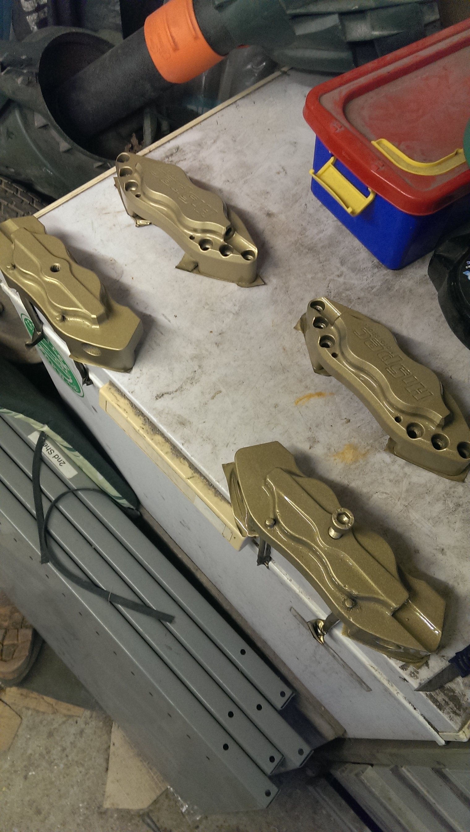

Went round Grants to build up the callipers but they were still bloody tacky! Left them in front of the heater for a few hours and they should be fine by tomorrow so will build them up before going out for dinner tomorrow eve then get them fitted saturday Big Grin

So did you buy all now bolts and stuff for the calipers?

(04-07-2013, 09:53 PM)Pompey306mark Wrote: So did you buy all now bolts and stuff for the calipers?
Err new bleed nipples, new banjo bolts and copper washers and new slider pins.

Not as much as you would think! Less than £200 a calliper. Them big 8 pot bastards up there are only £480 each!

Got my brakes built up today ready for fitting tomorrow. The new paint has been damaged a bit but i really want to get them on before next weekend because my current pads are fairly low and i want 4 pots for hill action!!

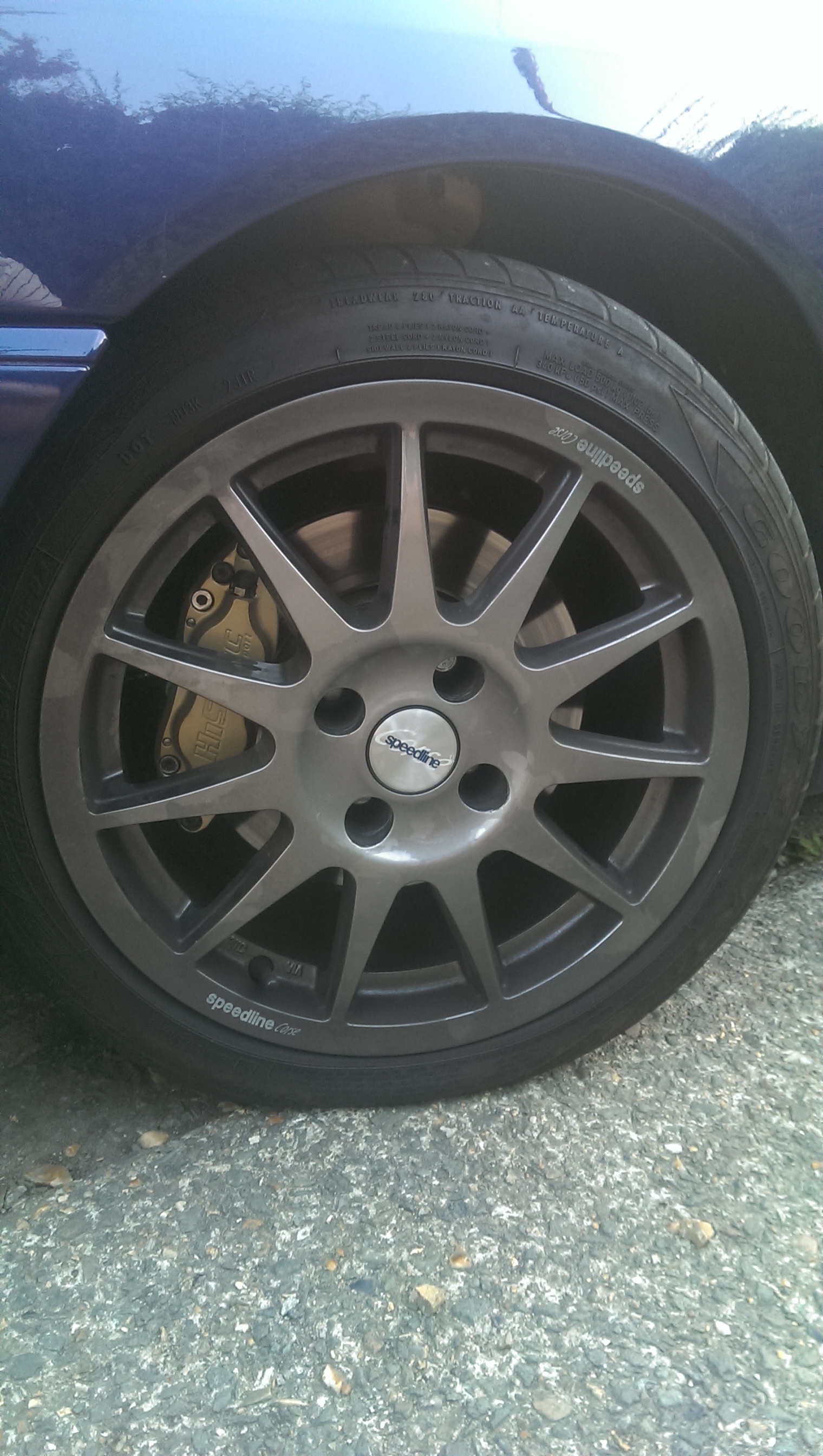

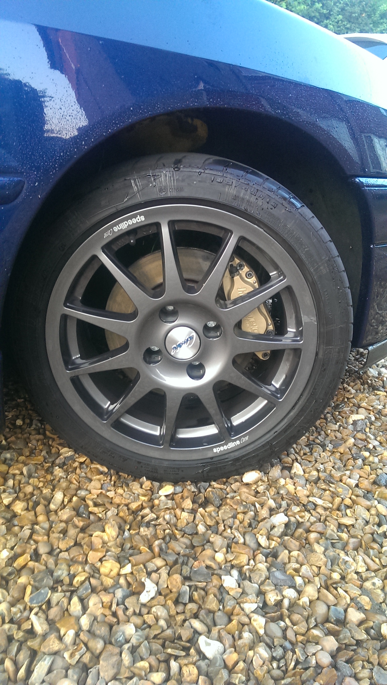

Got my replacement wishbones on today. Was relatively painless and went for a quick drive around my local favourite road and the car is back to its good old self. Also, i think i was destroying ball joints as there was a silly amount of play in the f*cked P bush!
Also got my 4 pots on. Was relatively painless. I was expecting to have trouble getting the original lines apart but they came apart quite easily. Bled them, went for a drive and they are very very good and they havent even bedded in yet! Had a bit of a scare when i got home and found a loose bleed nipple had splashed brake fluid all over my wheel Doh. Thankfully, they are powder coated and it got a through clean and detox.

How did you find the fitment of the discs and pads? Mine were a tight fit.
(08-07-2013, 08:06 PM)Pompey306mark Wrote: How did you find the fitment of the discs and pads? Mine were a tight fit.
Absolutely spot on but the pads are already used. I will be buying some 1155s on payday but just couldnt afford them now.
Already scared now. I dont like driving the car after ive worked on brakes until i build confidence they are ok (sounds silly i know!) but now i found one leaking, im worried lol
Lol. You might need to remove a mm or two off the back of the pad on the new ones.
What discs you using? Standard 6 ones?
Yes I am.
