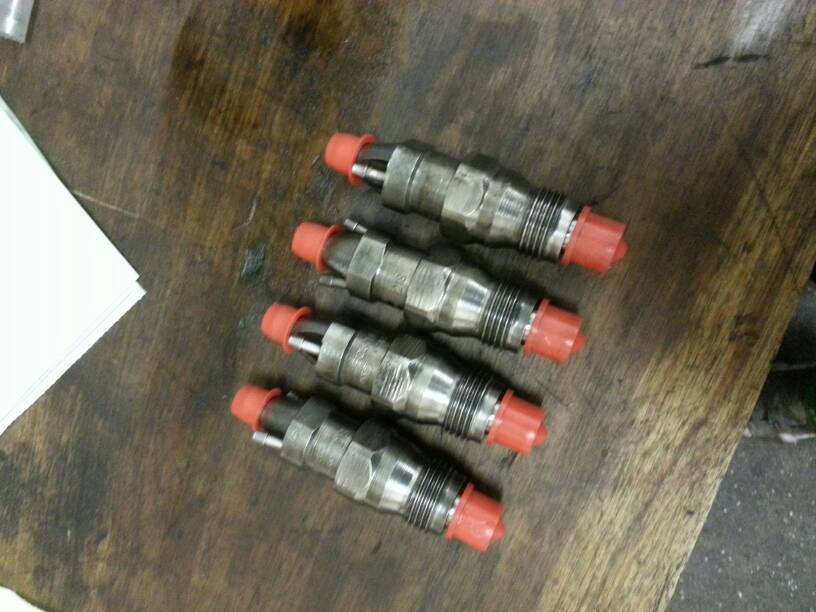

First set of injectors done for zx_volcane.. :-)
#51
^^^Shiney bits Big Grin

#54
Shiny indeed Smile
(24-10-2012, 08:34 AM)Dan! Wrote: First set of injectors done for zx_volcane.. :-)
