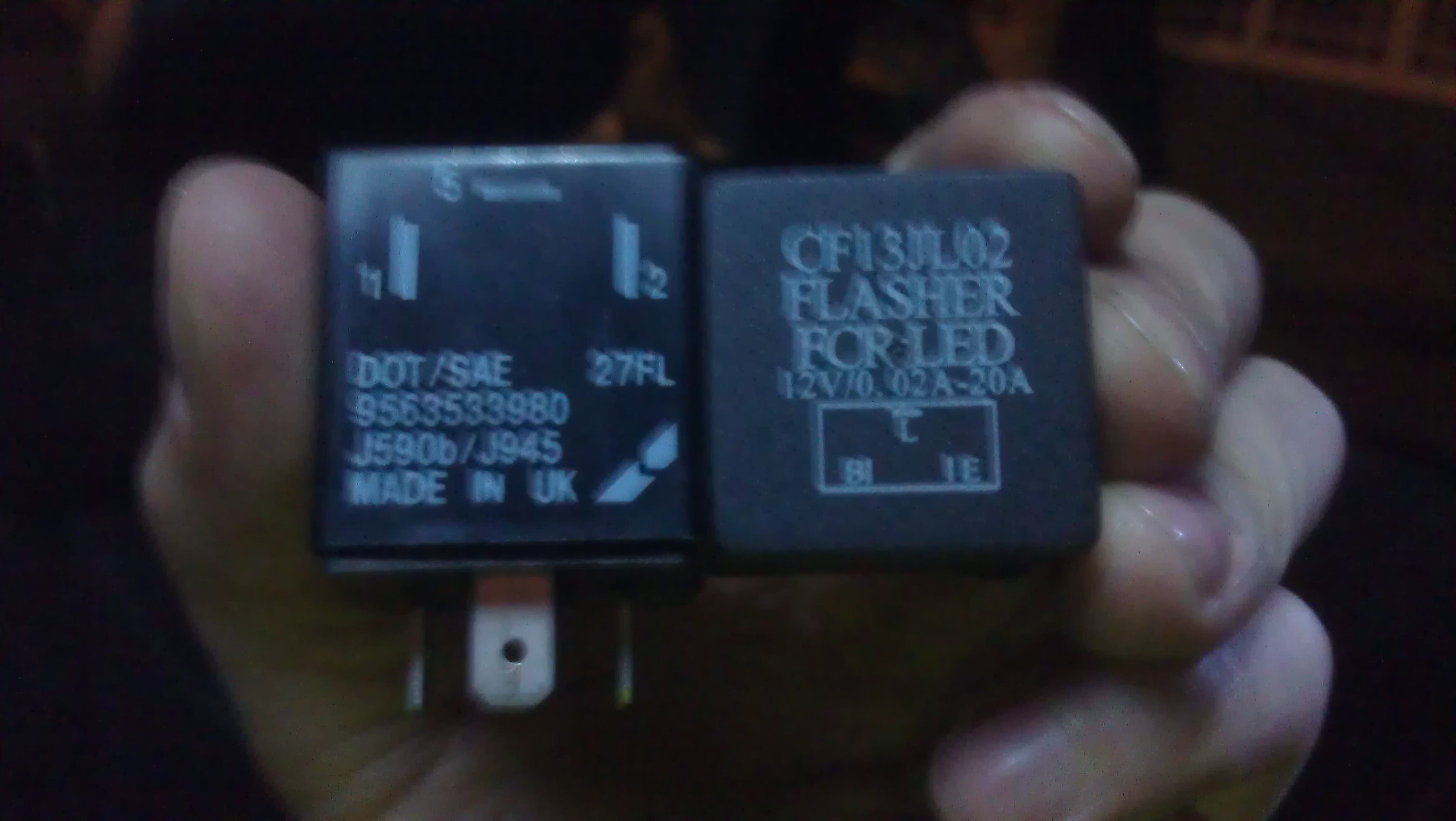

If it helps, here is a pic of the leccy relay next to the standard one from the car (sorry about the blurry pic, only got the one before my phones battery died):
The leccy relay has CF13JL02 written on it, just in case you cant read that properly. Wink
Ive seen some on ebay that are CF14, if anyone can shed any light on what difference (if any) this makes, that'd be grand. Rep shall be awarded for information leading to a fix. Big Grin

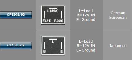

short answer you bought the wrong relay!
you bought a relay for a japanese car
you should have bought CF13GL-02
easy fix make extention leads for the relay and swap wires E and B over in the plug

(15-01-2013, 11:04 PM)cully Wrote: short answer you bought the wrong relay!
Excellent stuff, should have just pm'd you really! I shall order a new relay then probably, and you shall receive your rep when im back on the PC. Big Grin
