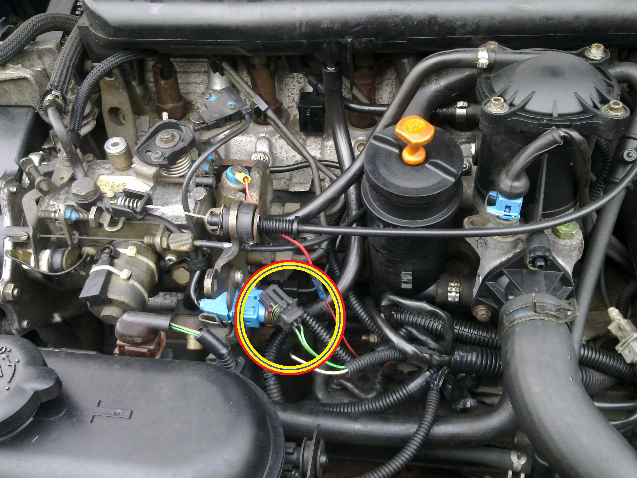

Hi all, I was replacing the heater plugs today when I noticed a 4 pin (female) plug with three wires one of which is broken off, it is tucked behind the main loom to the right of the injector pump, the plug itself is coming out from the loom along with the fuel cut-off solenoid and alternator wires etc, there are no obvious probs, faults or warning lights showing. Does anyone have a clue as to its intended use?
I think its a XUD motor, 1999 (S) 1905cc turbo, Lucas CAV system.

Don't recognize it from memory, probably just a spare plug, there's a few on the loom! TBH it's an XUD, if it runs and drives and everything works, then just leave it Smile
Is that not the Lucas immobiliser plug?
im sure cw has hit the nail on the head

look at the pump, its been cut open to have the immob removed, that was the original plug for it
Yep 100% it's the original immobilizer plug. You have had your stop solenoid replaced in the past and whoever done it just sacked off the immobilizer and put a straight 12v onto the solenoid instead. Pretty common occurrence and nothing to worry about :-)

OK, It's an XUD then! that's a good start. Thanks!... I can't see any sockets within the area so I assume it is just not needed on this model, but mostly these are capped - it probably fell off.

(14-11-2012, 08:46 PM)Dan! Wrote: Yep 100% it's the original immobilizer plug. You have had your stop solenoid replaced in the past and whoever done it just sacked off the immobilizer and put a straight 12v onto the solenoid instead. Pretty common occurrence and nothing to worry about :-)
I'm happy with that, less to go wrong eh? I thought the connection to the cut-off sol didn't look factory... the thing with the cable ties on the inj pump doesn't either (?)
