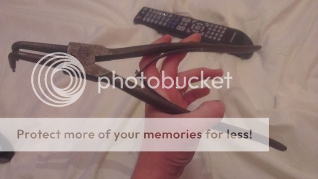

I had to use some big arse circlip pliers to get mine off. Horrible things.

I borrowed them from my father in law. Really need the biggest you can find, here's a pic of one of the pair I was given, didn't use these and they are for external circlips but the others are the same size. It was still tight with these :o
