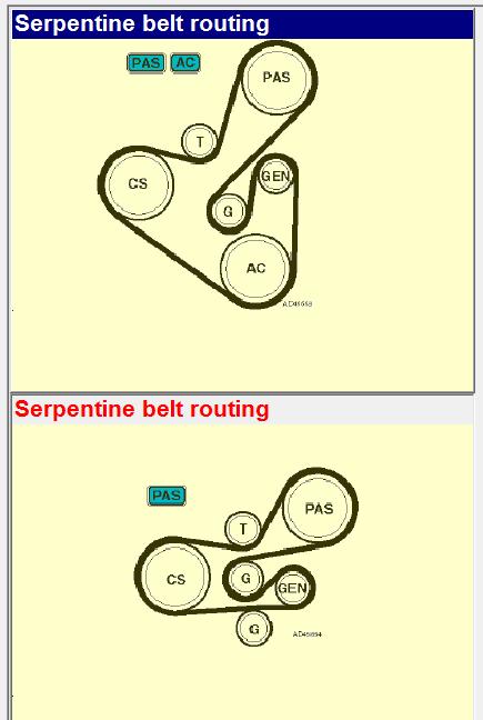

how dose the shorter belt fit?? what route dose it take?? and i dont need to swap anything else??
You should be able to work out the belt routing, as far as i remember its not far off the original and its hard not to get it right, the pipes were a real pain to get out of mine from round the back. Just bend them till they snap and take them out bit by bit. The pump is just four bolts with a 16mm nut and bolt.
i belive without looking the belt is a 6pk1193,
becasue 1205 is too big and the belt just runs a diff way.

its a 6pk1173 belt
(stolen from warlord)
[Image: auxbelts1-1.png]
Well that looks simple enough! never thought it would be that easy lol whats a 6pk1173 belt?? is that the part number for peugeot?? or can i just go to my local car parts place and get a belt for non air con??

autodata belt routing for cars with aircon and without
soooooo theres 2 options then but looking at the second option the belt will need to be longer??
If you want to remove the pump there are 2 options.
1 use the shorter belt listed above with the original alternator and pas bracket.
2 use the full non air con bracket from a dw8 or dw10 and run the appropriate belt for that setup as cully has pictuered (which is what I've done on 2 (about to do the 3rd) of my cars and a mates)
[Image: sig.jpg]
Think im gona go for the warlord option seems so much easyer
Just to confirm, 6pk1173 is a gates part number, otherwise pug parts guys should be able to find you a belt that's 6 notch and 1173mm long. Keep the bottom tensioner in place, it removes the long run from the bottom gives a little bit more wrap around the alternator pulley. I seem to remember that long run gave warlord problems with the belt slipping, hence why he ended copying the set-up i used (last pic).
