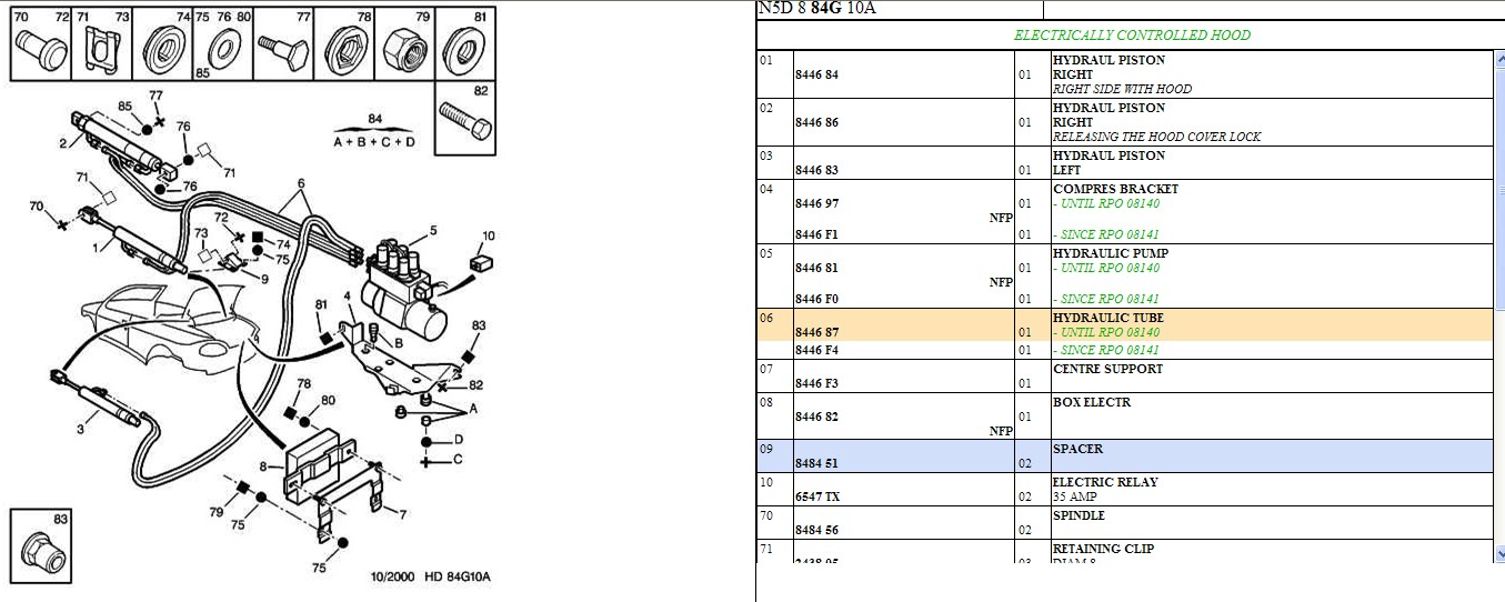

If the motor stops part way through opening/closing then it's probably one of the microswitches either stuck or faulty. As a newbie to the cabriolets myself though, I'm afraid I don't know where the various switches/sensors are located but I'd certainly look to these first.

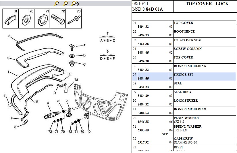

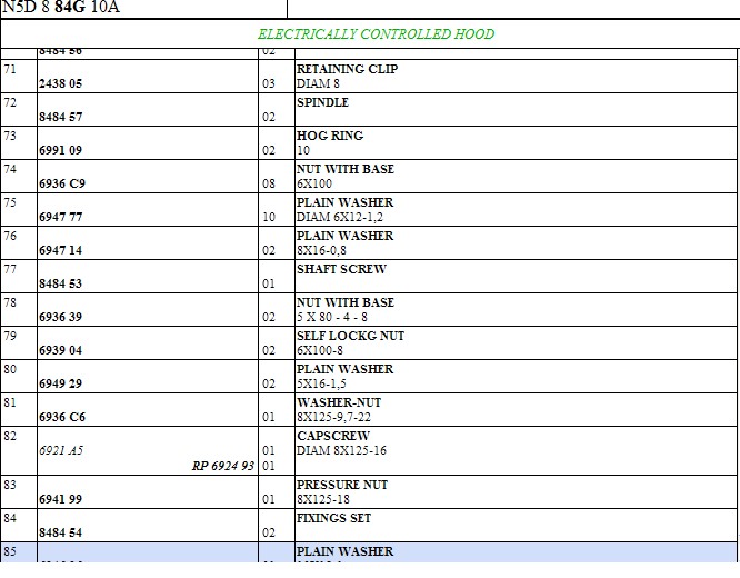

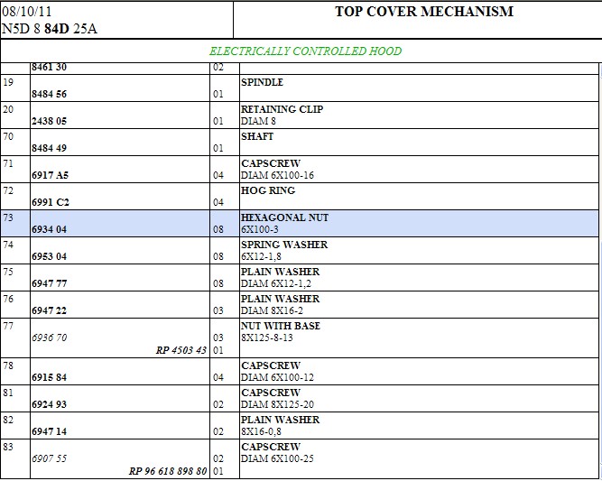

I don't know if these will be of any help in working out what's going on but I'm posting them anyway. For starters I guess the hydraulics need to be properly charged & bled for the roof to work properly. I wonder whether the pump or rams also has sensors/switches built in to sense when they're fully extended or retracted?
