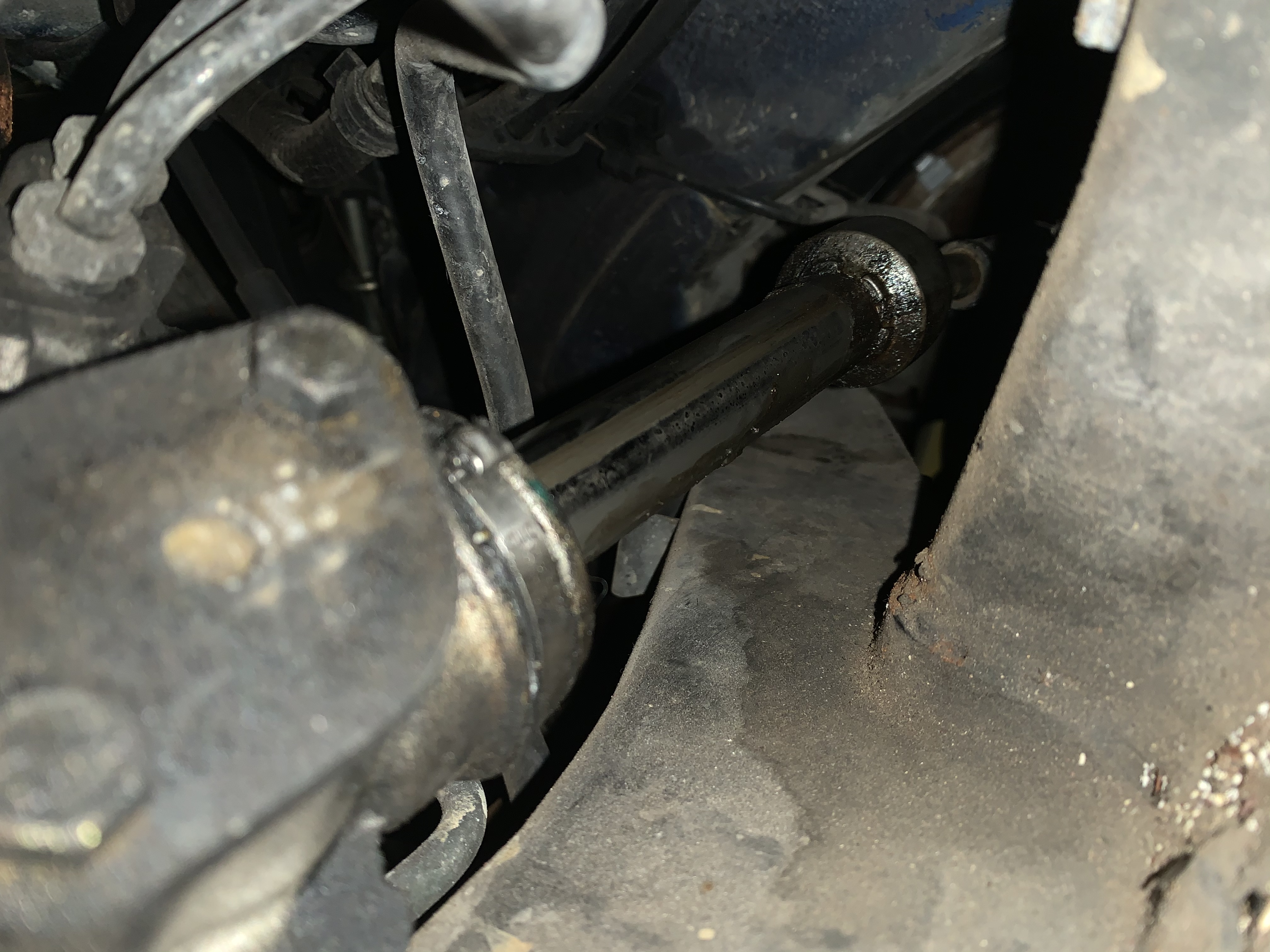

So that’s about it to date. Only new drama we’ve got is a bit of roughness in steering and a faint banging sound every now and then from somewhere on suspension is guess. Will post on a forum as I progress.
Biggest query though is that I looked at steering rack today and noticed a worn gator on drivers side steering rack rod.   It’s full of grit and not much grease (shite steering doh!) in the steering rack. Probably not something I can refurb, though the rest looks ok......including links, ram and rods etc.

banging from the suspension is common for the rear axle mount to body bushes to wear out. Should be pretty easy to check with a lever.
Clean the steering rod and fit a new gator. If the seal had failed, all the power steering fluid would have probably pissed out. Smile

Thanks for getting back Martin.
ive posted in the suspension thread some pics........
How would I get into the rack and pinion to clean it out?
Roughness is a grinding/ stiffness (no shit I hear you say once you’ve seen pics).
