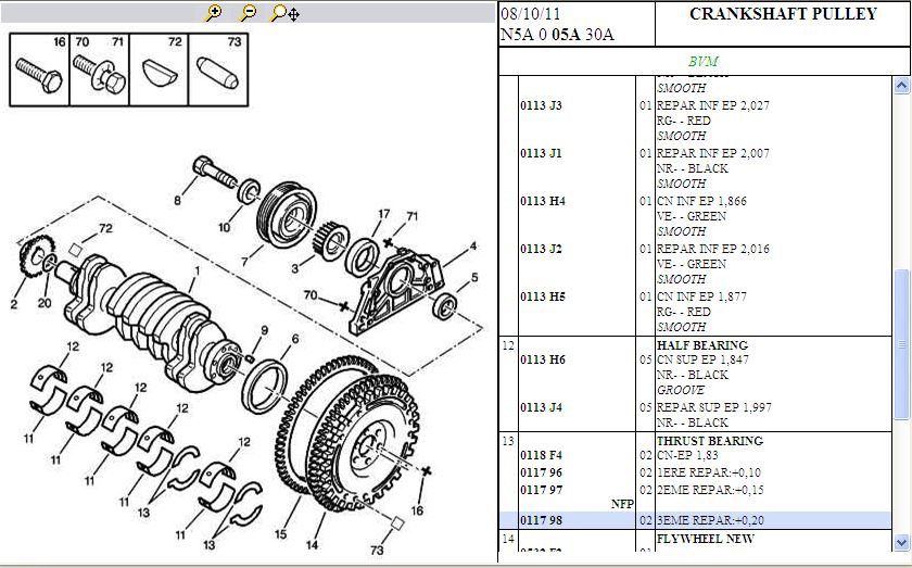

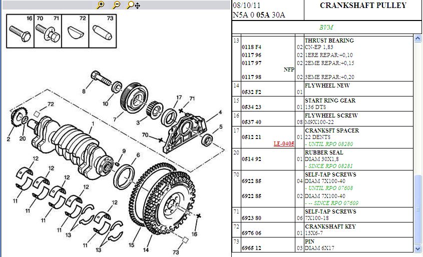

If you can't locate the key it's Peugeot number is 6979.06. I doubt you'll be able to locate a new one but maybe a scrappy will have one. I have a feeling the key will be the same on the HDi's and the GTi-6's but I haven't actually checked that. I'll try & find some time to check on servicebox later.
Attached are the parts diagrams for the pulley / crankshaft etc if that's any help.

If you look closely at the previous diagrams you'll see the dimensions for the key (item no 72) are given as 13x6-7. I'm assuming that's 13mm long, 6mm wide & 7mm deep, but you can correlate that against any remains of the key you are able to recover.

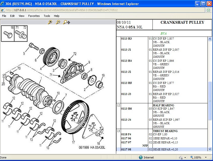

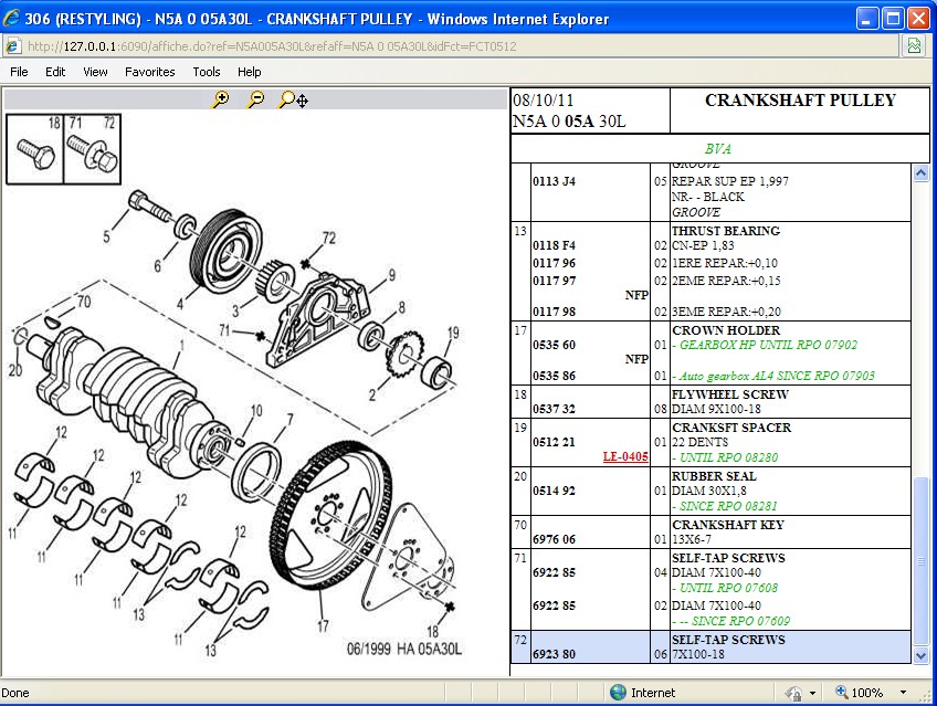

My apologies as the diagrams I previously posted were for the manual not the auto. Only a few differences between them (e.g. no spacer behind the crank sprocket on the auto). The keys & harmonic balancer are the same though. Here are the ones for the auto.
