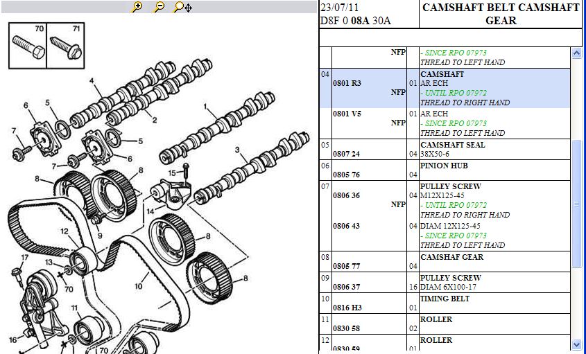

I have misplaced one of my camshaft pulley bolts for my ES9J4 engine
The torx head left handed thread bolt
Does anyone have one i could purchase or knows the thread pitch?
Cheers
M12 x 1.25 by the looks of it. One of these is a really useful addition to your toolbox. https://www.ebay.co.uk/itm/Sealey-AK71SP...:rk:3:pf:0
(25-02-2019, 08:01 AM)Mighty306 Wrote: M12 x 1.25 by the looks of it.  One of these is a really useful addition to your toolbox.  https://www.ebay.co.uk/itm/Sealey-AK71SP...:rk:3:pf:0
Thank you
Really appreciate the information and that tool recommendation, the amount of times one of those would have come in handy already!
