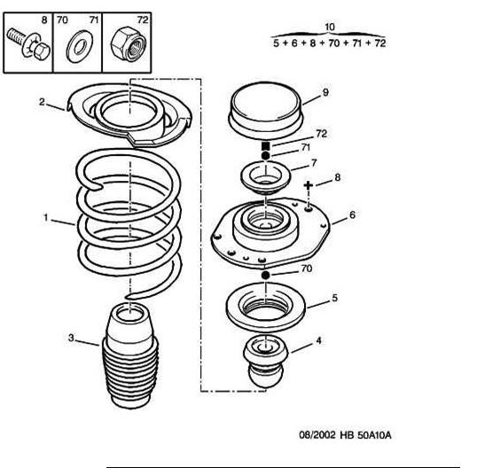

The Monroe shocks are going to be OEM (or near OEM) replacements I suspect.  The bearing doesn't actually sit on the shock ...it sits between the rest cup (which will most likely have been with the car from the factory) and the top mount.
The cup is 2 in the pic below, bearing is 5 and top mount is 6.
