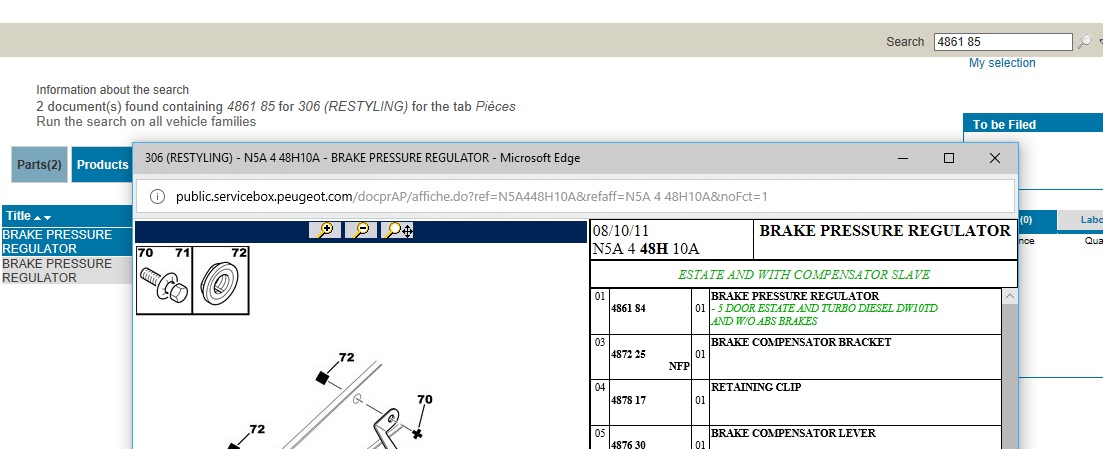

I can't find the 85 on servicebox at all? Searching it still brings up the 84 albeit on different models.

(03-03-2018, 12:31 PM)Toms306 Wrote: I can't find the 85 on servicebox at all? Searching it still brings up the 84 albeit on different models.
Deffo there Tom, although this is a different screen again from the one I saw yesterday and suggests 85 is for the GTi6/Rallye only.....

84 listed for 16v xsi. As it has the same set-up at the rear as the gti I can only assume the difference in compensators is down to the bigger front brakes/master cylinder.
