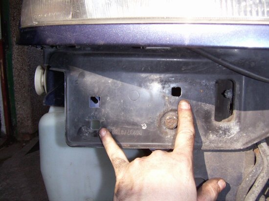

What's the easiest way to remove a bumper buddy?
I need to attack mine at some point and haven't done it in years, I can't remember where it's secured.
[Image: Sig500x130.png]
#80
All the screws at the bottom and 2 bolts either side on you're slam panel
#81
Hmm, is that underneath the grille?
I'm not sure how securely my grille is fitted because it's been smoothed. I'm guessing it should be obvious after I take the grille off though.
Thanks. Stupid bloody foglights.
#82
No there are two on the underside of ye car behind and slightly below the headlights and a bunch across the bottom of your bumper holding it to the slam panel so basically 4 bolts plus the bunch on ye bottom of the bumper if they havnt been broken off XD
    two either side :-)

Jukie88 is spot on, two 10mm nuts on each side as shown in his photo where he's pointing and 3 x 10mm short bolts underneath the front. You need to drop the washer bottle off to access the two nuts on the drivers side, easy job to remove it......disconnect loom plug and rubber hoses, drain the water out and then it's just 2 x 10mm nuts and off it comes.
