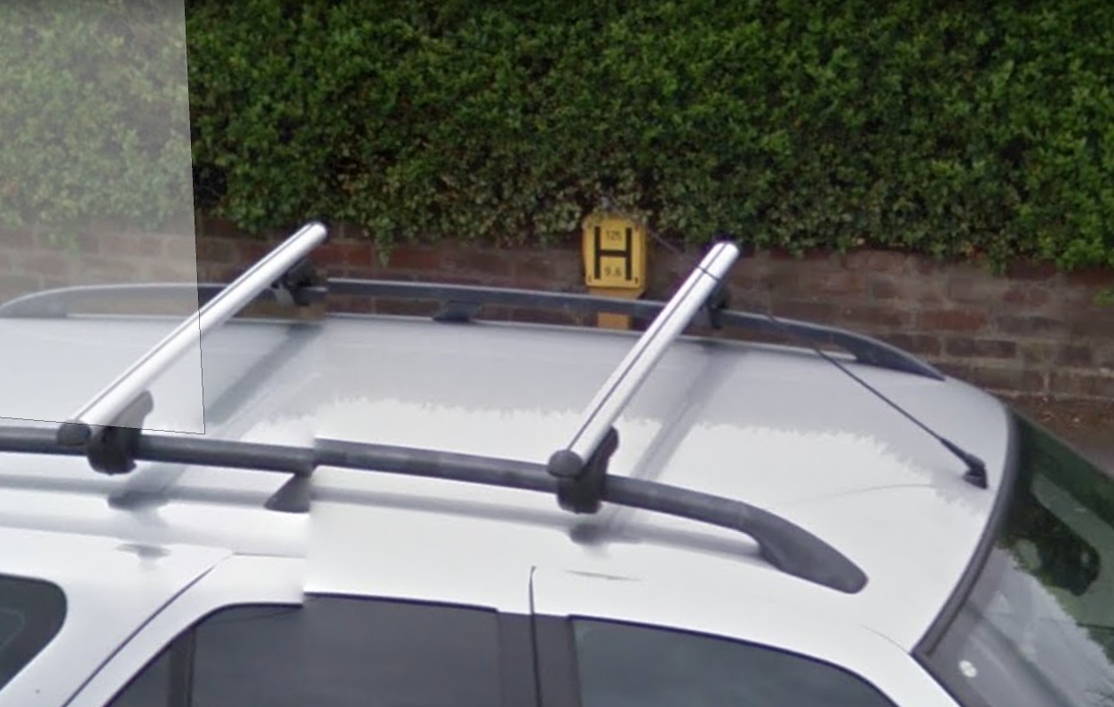

These work totally fine with my Phase 3 306 and radio reception is absolutely fine. It's long, sure. You won't be forgetting to remove it prior to going in a car wash though. Worrying about the roof bars really isn't an issue. You can just adjust the aerial base so that the long aerial feeds underneath.
I found a picture of my car with the aerial and roof bars on, from google maps. Lol. Hope this helps.
