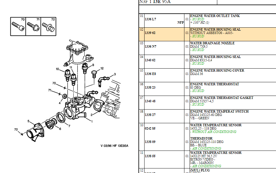

Can anyone help find the part numbers for the following?
[Image: 9b3087aa551698a9ce4cf0bc87775797.jpg]
2- the gasket from thermostat housing to the block.
10/11- 2 small plastic o rings sealing the 2 sensors on? (Not in diagram)They disintegrated on removal, however i was just going to use a general o ring for these if possible.
Help appreciated
10/11 should have copper washers on from memory they come on the sensors. I think i have a couple of spare sensors banging about somewhere can look tonight for you and send them in post if you cover the postage. Dont want anything for them. As for the other gasket you can buy them in the head kit or singully off ebay if you get the part number from service box. Only a few quid for the head kit.
When i removed them there were what i presume were plastic washer that just fell to pieces when they came out, if you have some ill take them, thanks mate.
Thats it, I've always had problems accessing service box otherwise i would have checked the numbers on there.

I haven't found those washers yet, i don't know if the seal was part of the sensors/ plugs as they arn't there on the exploded diagram as a separate piece, so presume the sensors sealed themselves.
