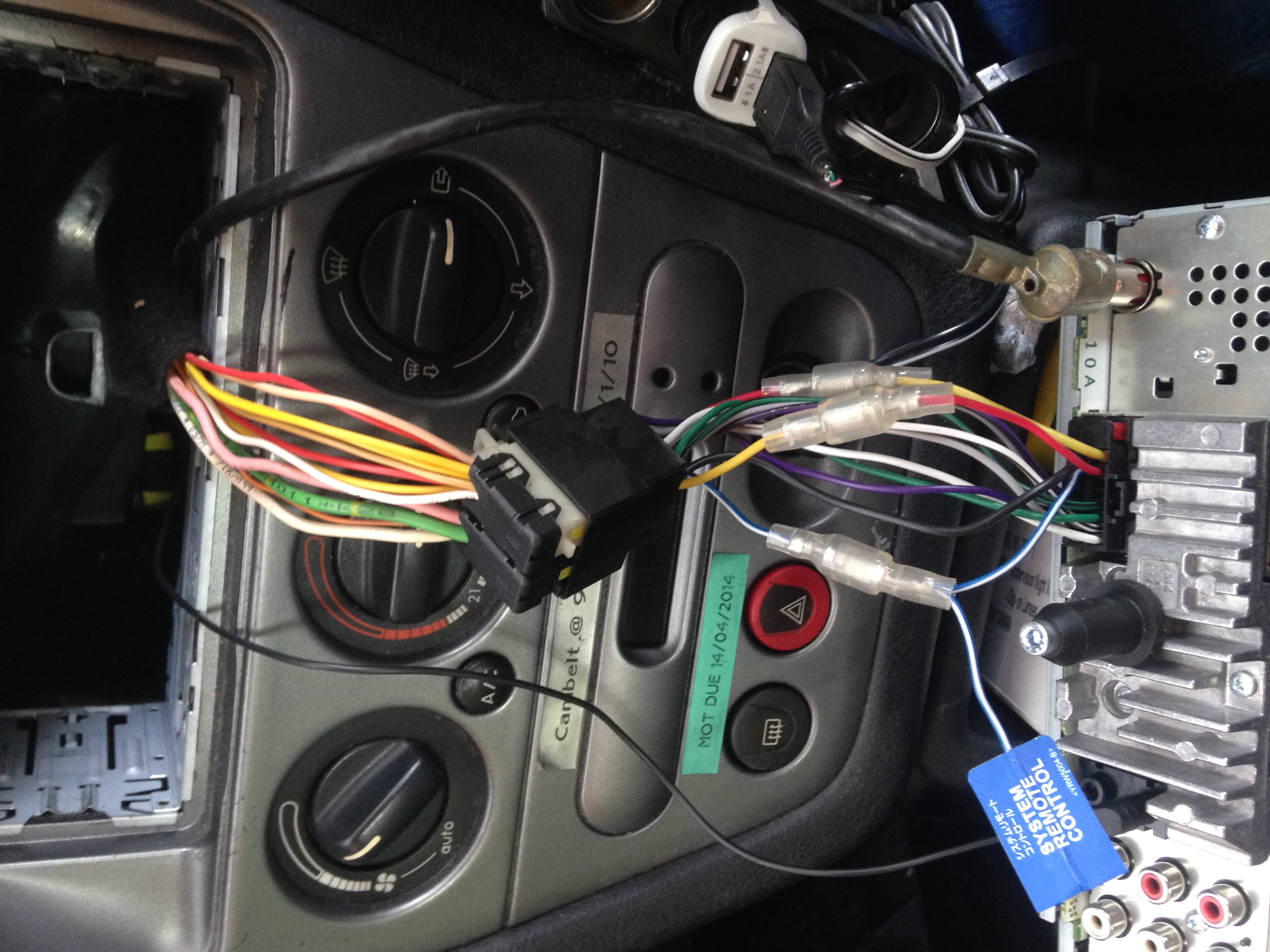

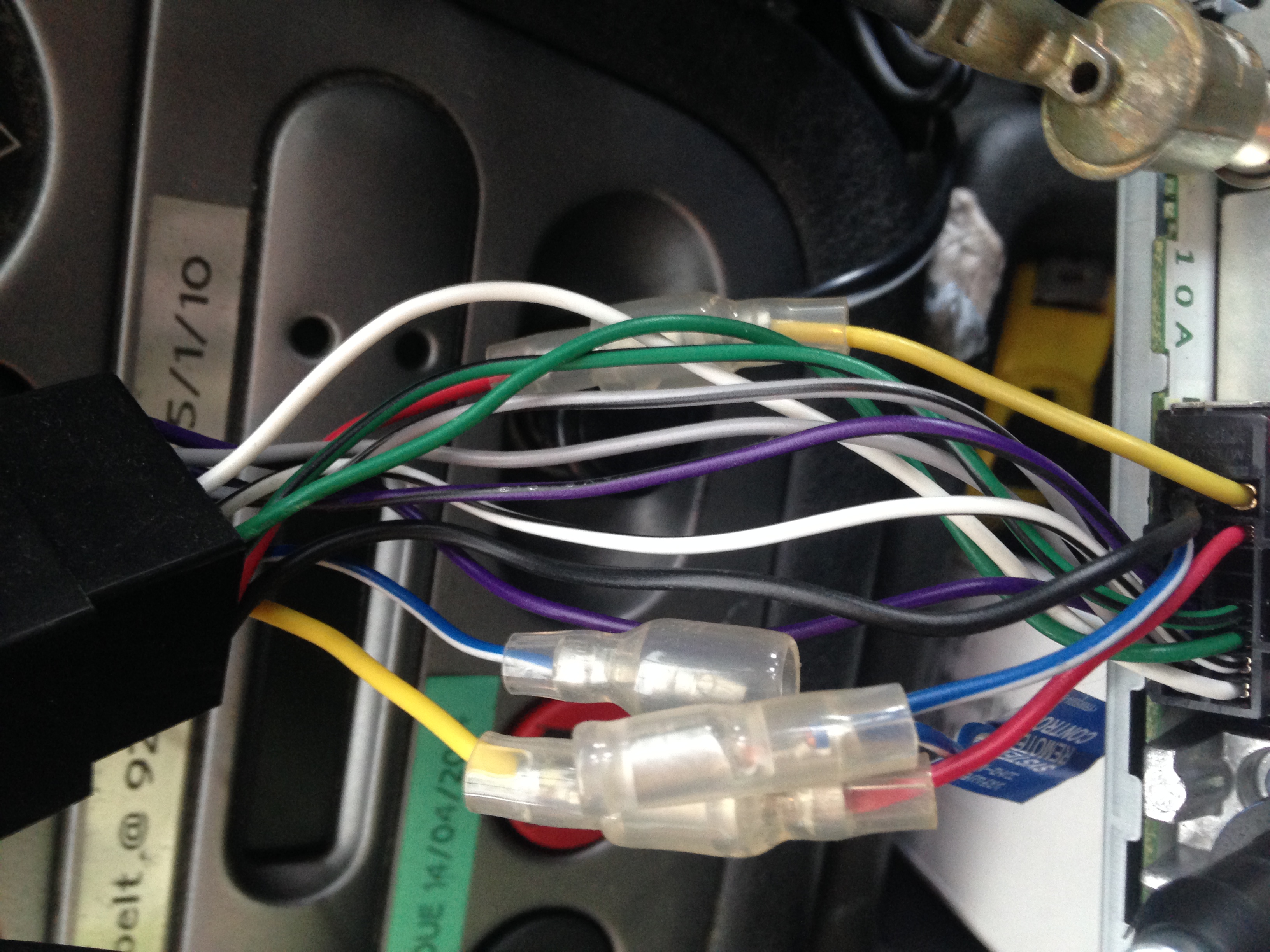

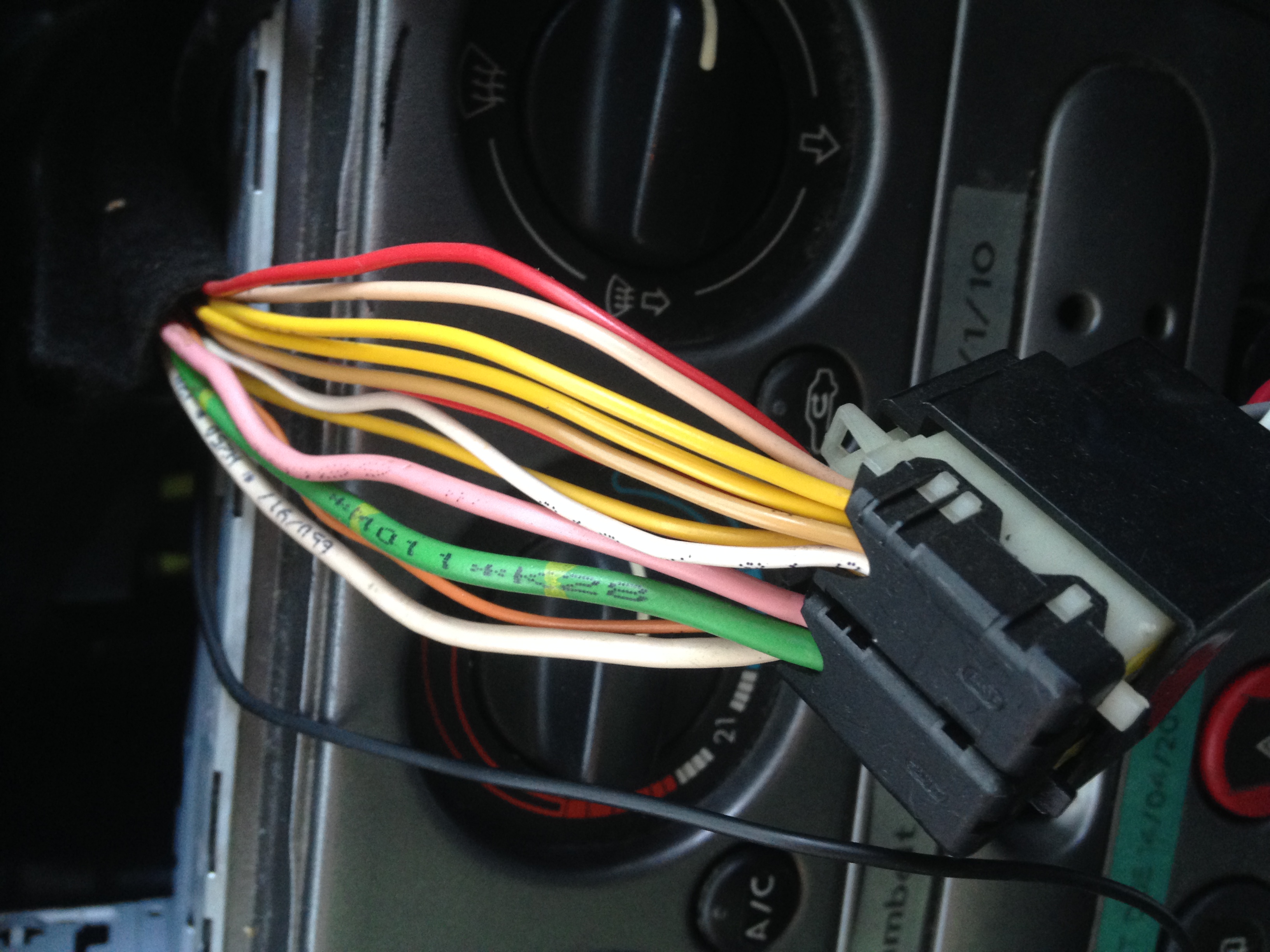

Hi guys,
Basically when I bought my 2000 reg hdi the stereo cables had been messed about with. I want to install a new head unit and I was wondering if anyone could share a picture or two of their standard wires and ISO plugs so I can reverse whatever has been done to mine.

should have some pix up this eve, after I've been to halfrauds for some release keys.
Hate Housework!
(19-05-2017, 05:18 PM)partybish Wrote: Oh nice, thanks!
ok, I've got some pix. hope they help.
Hate Housework!
I'm an audio install tech I can tell u all the colours and what they are if you would like and how to get a switched ignition live without install steering controls if your still having problems with it that is
(22-05-2017, 08:48 PM)Apugnamedreah Wrote: I'm an audio install tech I can tell u all the colours and what they are if you would like
you realise Peugeot don't use constant wire colours for cabling?
 all their wires are number coded not colour coded
