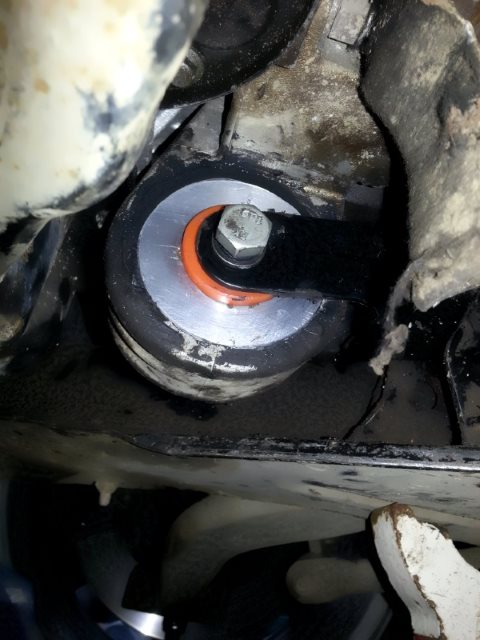

I've a half and half ally/poly on my 406 and it's lovely, no extra vibration noticable bar a slight vibe to the rear mirror when idling:
[Image: file.php?id=4279]
yeah but its a lovely V6! AdamB had a solid Nylon one on his in the 306 and that was smoother than a BBM bush in a 205 on a 4 pot
