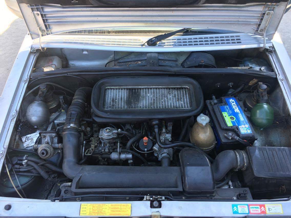

Can anyone please confirm if the Bosch set up on a 1991 Citroen BX TZD 1.8 diesel turbo is the same as the set ups for a 1.9 XUD? Wasn't too sure with it being a different engine size.
Thanks.
Just to say guys this is a setup im trying to sell the guy via my work so any input is appreciated Smile

i don't know but i would guess it would be very similar, does it look the same Matt, boost compensator on the top and such?
Only two photos we have buddy
Don't know why they never sent

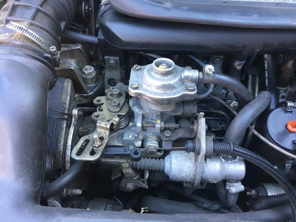

2nd attached
It has a strange looking vacuum/boost operated advance control at a guess, which I've never seen before, probs work but it is a little different to what I've seen over the years Smile
(03-10-2016, 04:19 PM)Mattcheese31 Wrote: It has a strange looking vacuum/boost operated advance control at a guess, which I've never seen before, probs work but it is a little different to what I've seen over the years Smile
Just a water operated cold start mech - tips in more advance than hole coolant is cold
ahhh yes, could see it was going to the advance doohicky, should have realised that was coolant from the diameter of the pipes, not seen that before, be easy enough to plumb in then i imagine . . .  Smile
So is it usable to for my XUD? ? I'm fairly new to the whole d turbo scene to be honest

(03-10-2016, 06:29 PM)Stuart C Wrote: So is it usable to for my XUD? ? I'm fairly new to the whole d turbo scene to be honest
Should be fine, no need to hook up the cold start mechanism either.
