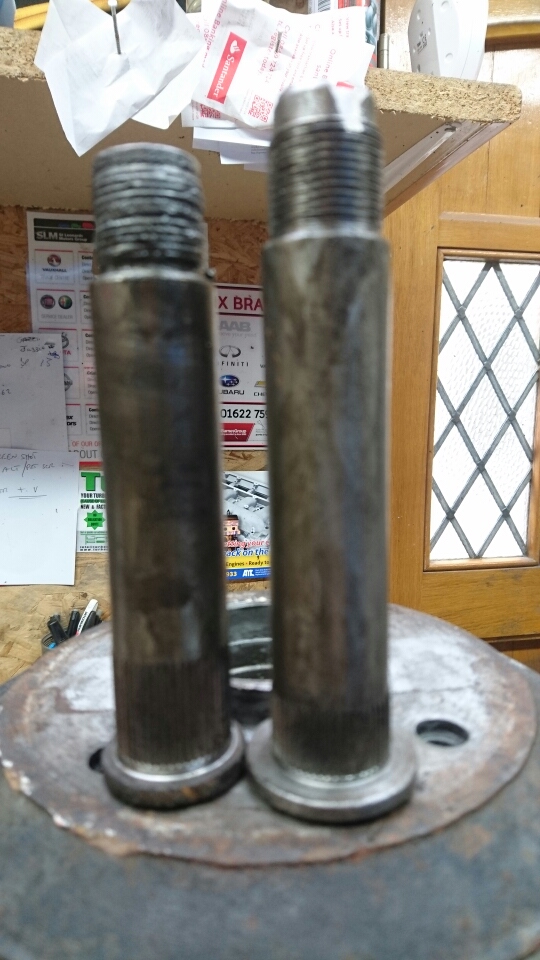

The rear stub axle pin on my 306 needs replacing. I ordered the part in the link below last week, but it didn't fit the car (the length was originally advertised as 129mm but, after my complaint and subsequent refund, has now been changed to 133mm).
http://www.ebay.co.uk/itm/331251959397
I have tried attaching a photo of the old part and the one I sent back next to each other, and they are clearly different sizes.
Anyone know where I can buy the correct size? The car is a '95/N (phase 1) D Turbo if that helps.
Thanks,
Liam

I don't have the exact lengths to hand, but drum and disk stub axles are different lengths, as are the early stubs (eg 205's) and later ones (eg 306) for a given type.
I do have a few spare at home that I can check if I've got the length you need no one sorts you in the meantime.

(21-06-2016, 06:46 PM)powerandtorque Wrote: I don't have the exact lengths to hand, but drum and disk stub axles are different lengths, as are the early stubs (eg 205's) and later ones (eg 306) for a given type.

It's a phase one 306 with drums on the rear. The length of the old one was between 125mm and 126mm.
If you happen to have one that size going spare that would be brilliant, just let me know how much you'd want for it.
There's 2 different drums, most ph1 have the small ones, and ph2 have a mix ph2 dturbo have the bigger flat drum with the longer pin iirc...I'd say I have the pin you need.

(21-06-2016, 06:59 PM)ConorTRG Wrote: There's 2 different drums, most ph1 have the small ones, and ph2 have a mix ph2 dturbo have the bigger flat drum with the longer pin iirc...I'd say I have the pin you need.
That explains the different sizes! Mine's a phase 1, I'd say the length of the pin is between 125mm and 126mm.
If you've got one going spare then let me know what you want for it!
