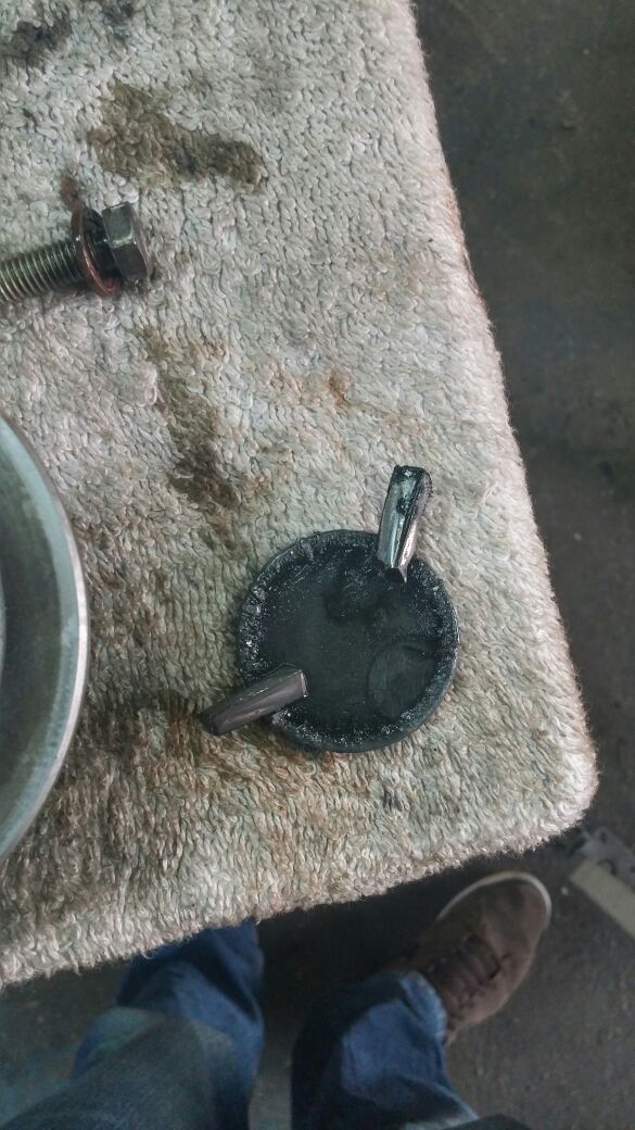

spotted the 2 teeth and where they are from, but what is the blackish round thing they are on in the lower picture??
Presumably just a magnet to pick them up.
The MA boxes have a magnetic drain plug but the BEs don't for some reason. Confused
Be has a magnet in them
Ah so is it loose then? Makes more sense to put it on the drain plug tbh.
no not loose, it sits in a slot in the bottom of the main casing
