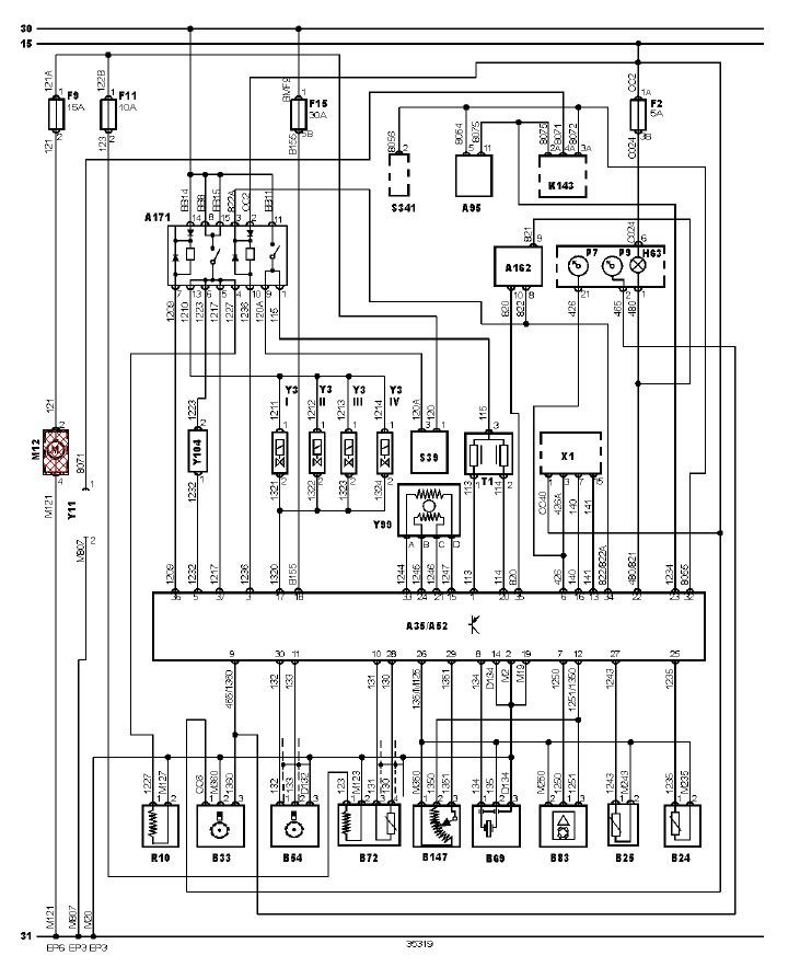

don't know if this is any help
GTI6 Info
Thanks given by: insomaniac45
#42
Nice job Cully Smile I did see another diagram of that, but it was quite blurry, hence why I thought it was 16 not 18 Smile
Well those have helped tons Smile
So, all is good on that front, ECU is getting power, and it has good earths.. So the only thing i can think of now, is that the ECU is not receiving the unlock code from the security box.
