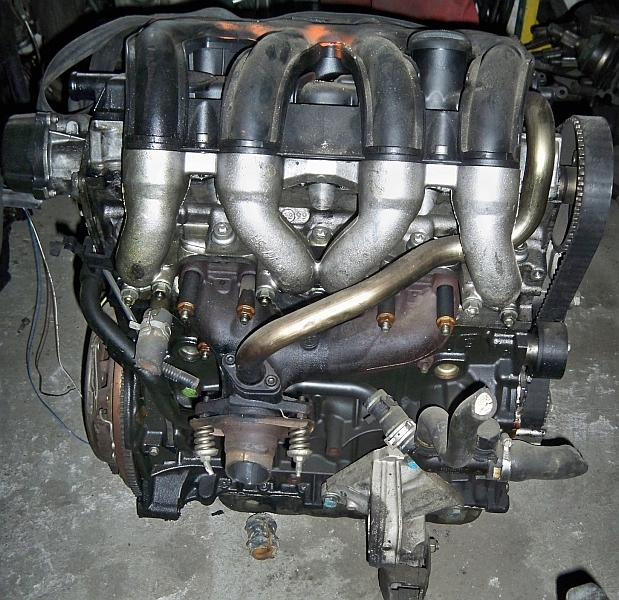

kinda sorta found what i was looking for..thanks! next question.. on the DW8 immediately under the first runner of the intake manifold there is an outlet, about a finger's width, and i sincerely forgot to where it is supposed to go.. is it water? or oil? i imagine it's water but i don't want to risk it :/
here's a pic i found online.. in it there's the remaining part of a pipe and jubilee clip attached to said outlet.. also someone knows where it leads to? thanks again guys! Smile
Attached Files Thumbnail(s)
EGR. Ewwww.

(10-04-2016, 03:30 PM)089 Wrote: kinda sorta found what i was looking for..thanks! next question.. on the DW8 immediately under the first runner of the intake manifold there is an outlet, about a finger's width, and i sincerely forgot to where it is supposed to go.. is it water? or oil? i imagine it's water but i don't want to risk it :/
that is a water pipe out of the back of the head
