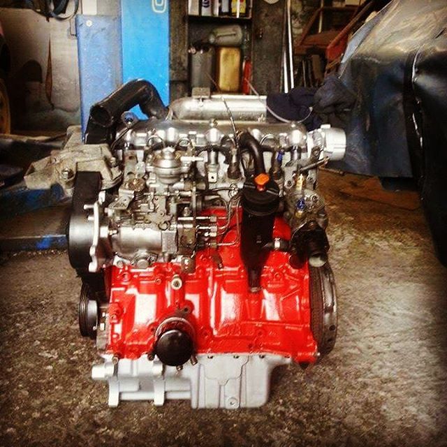

My rebuilt lump because I'm a shameless showoff.
