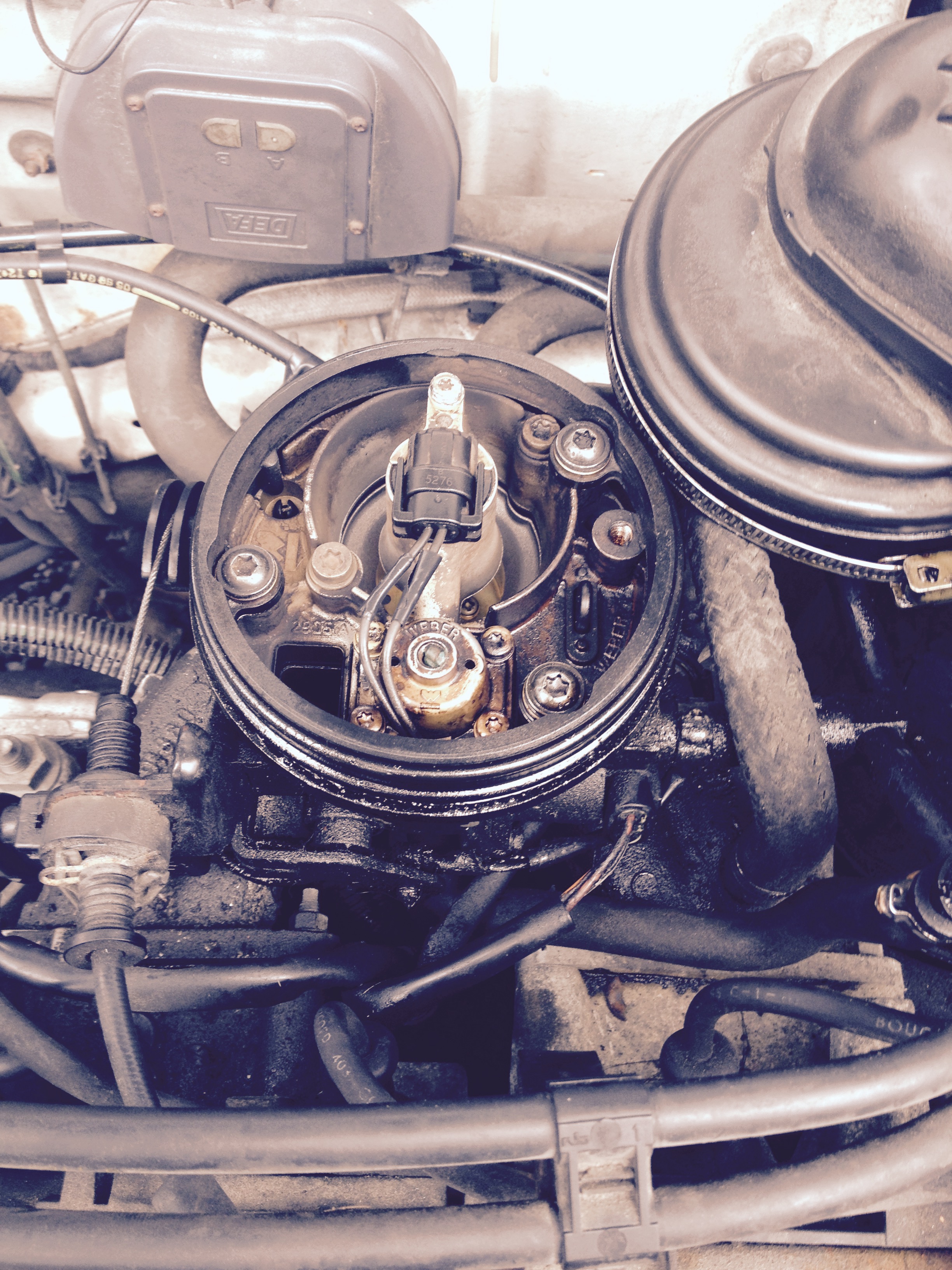

my peugeot 306 wont start. I checked alle the fuses, relays.. ok.   Alle the earthing connection are ok. Its sparks on the plugs.. but it still wont start. when i poor some petrol in the manifoil the motor engnite but stop when the petrol is burn up.. But when i turn the key around, the starter turns but the engine wont start. I also checked the petrol pump and this is ok. Can anyone help me here..?

Fuel to the manifold, but not from the injectors? Is this an SPi or MPi 1.4?

(16-08-2015, 08:37 AM)benny123 Wrote: my peugeot 306 wont start. I checked alle the fuses, relays.. ok.   Alle the earthing connection are ok. Its sparks on the plugs.. but it still wont start. when i poor some petrol in the manifoil the motor engnite but stop when the petrol is burn up.. But when i turn the key around, the starter turns but the engine wont start. I also checked the petrol pump and this is ok. Can anyone help me here..?
Its fuel from the injector      on the top, when i put on 12v directly from the battery to the injector, but no fuel when i try to start the engine.. See picture..
In tank petrol pump ok?

So, you get spark but no fuel?
Pump is priming from your description but no fuel to injector/manifold? I'd be tempted to pull a fuel pipe and check it's getting through.
Could be fuel filter.
