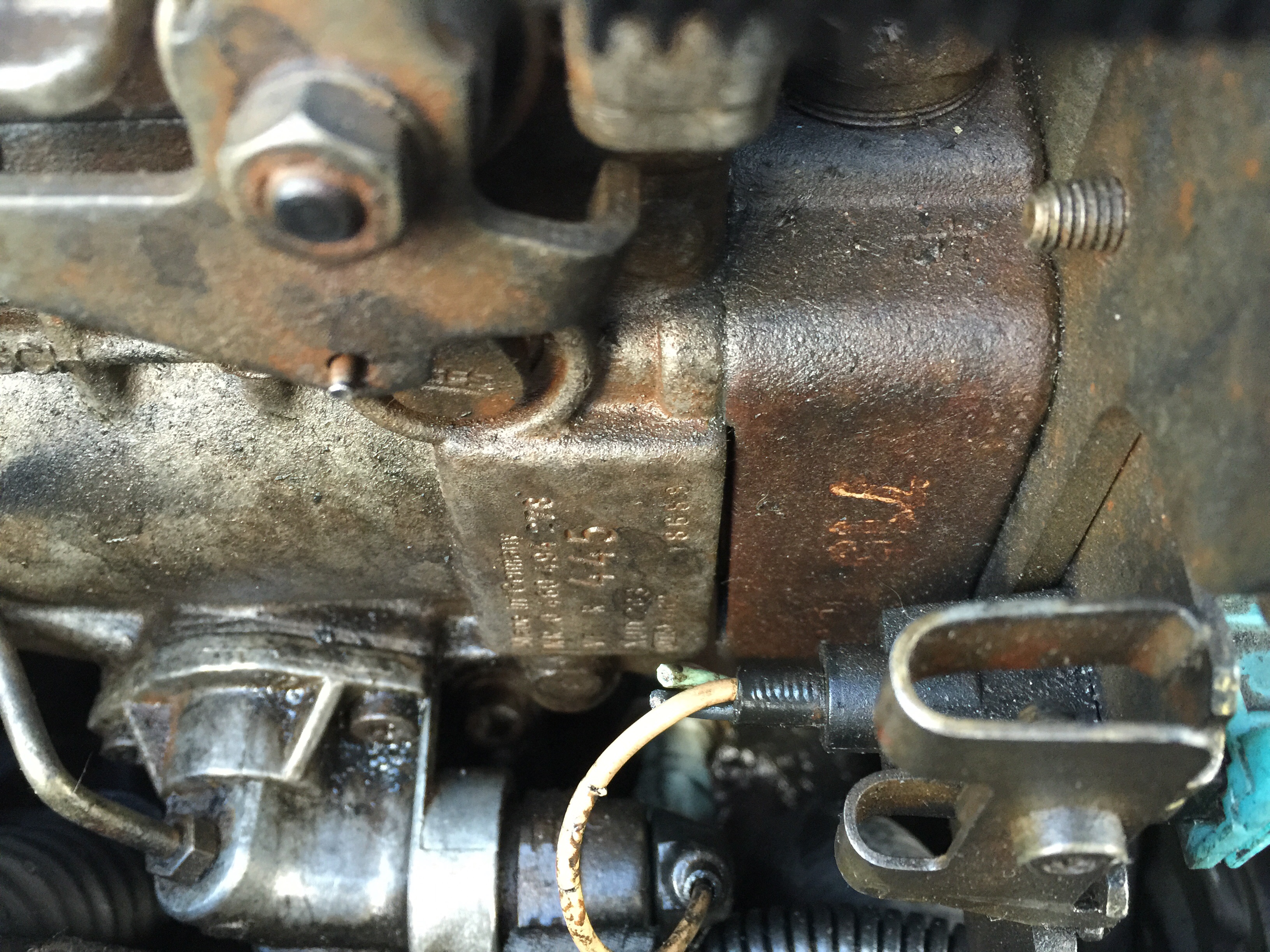

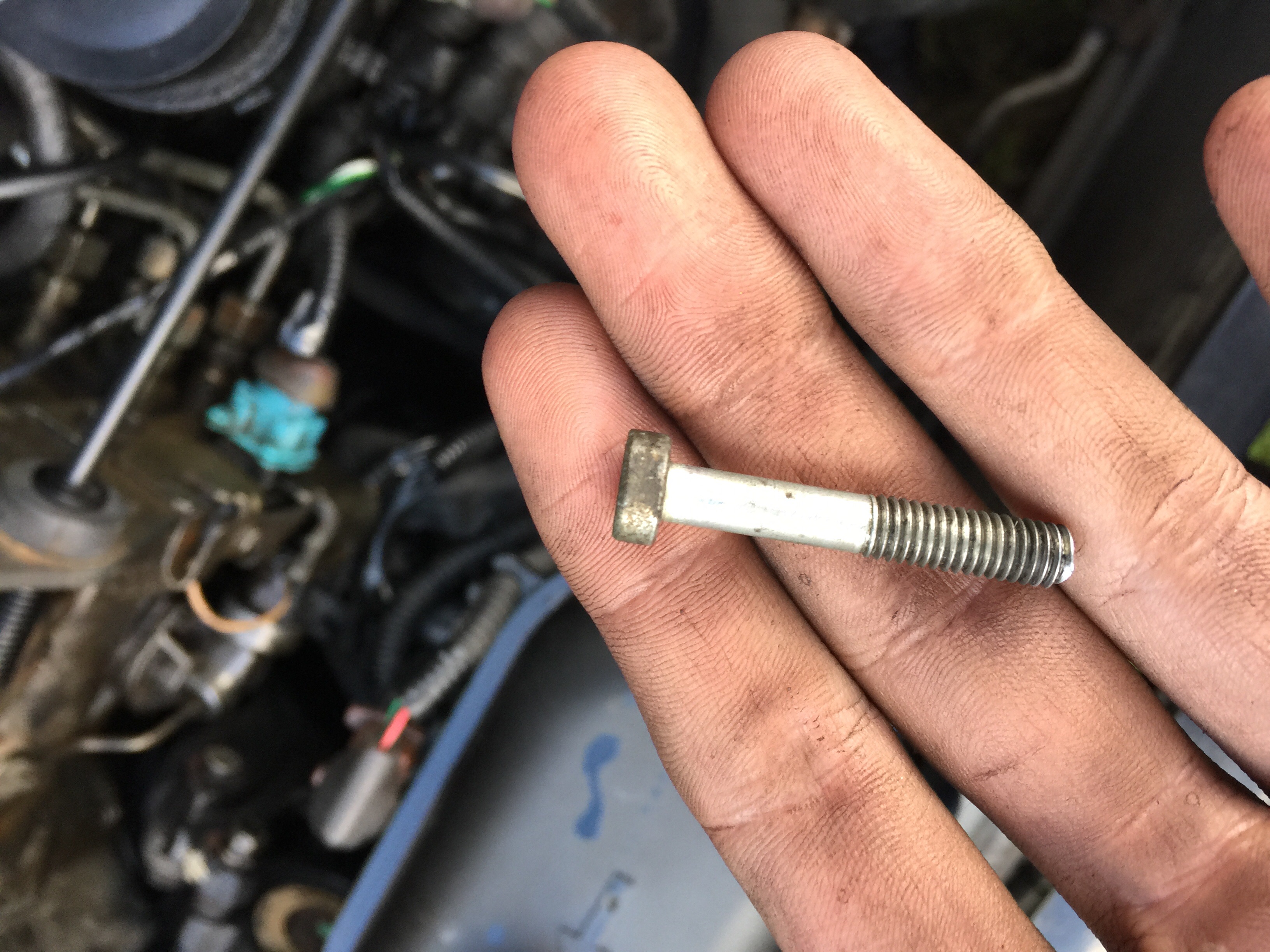

Took the 306 for a spin today. Was going to the fuel station and it cut out, I put it down to low fuel but after looking a bit more I found my problem. The bolts apear to have snapped off that hold the two parts of the pump together and has seperated. It just started pissing out fuel at the station. Any idea how this could of happened? I'm guessing I need to replace the fuel pump?
No idea how it happened. Just pull the pump off. Give it a reseal and ive got four of those bolts spare i can send you for cost of postage. Job done then. Smile
Over-tightened previously maybe...?
Yeah never seen that before!
As tom bash said
(02-08-2015, 08:04 PM)bashbarnard Wrote: No idea how it happened. Just pull the pump off. Give it a reseal and ive got four of those bolts spare i can send you for cost of postage. Job done then. Smile
That would be awesome mate, any idea where to get a seal kit from?
Ebay Smile
What matt said. Ill dig the bolts out today
