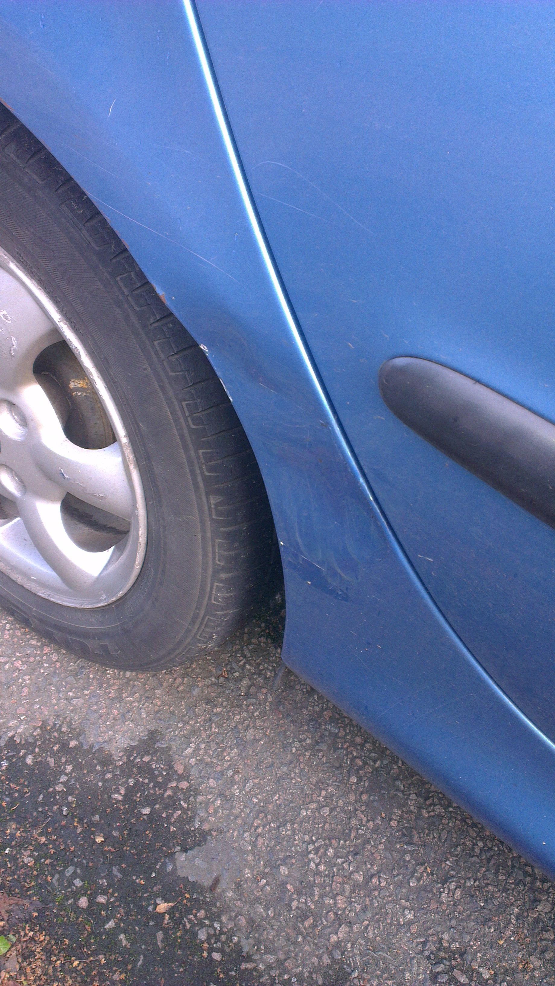

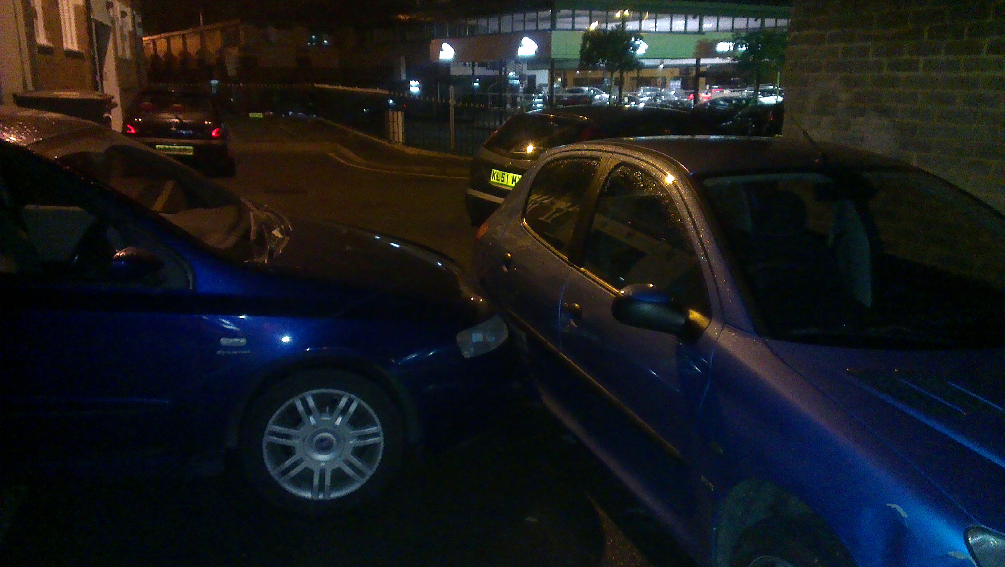

My brother has 206, someone (who turns out is actually un-insured) hit my brothers car after leaving the handbreak off down a slope.
I've got some pictures, which I attach. His insurance is due for renewal in 2 days and we don't know the extent of the damage. Apparently the gap between the wheel are the arch is about 1mm and nearly touching.
I was wondering if anyone could offer some advice and guidance on what we think might be broken/bent? Obviously there is no point in him insuring a broken car if it needs to be replaced.
He's also talking about claiming on his insurance, which i think is retarded. But anyway, could anyone take a look at the pictures and advise? or worst case pop down and see him to take a look?

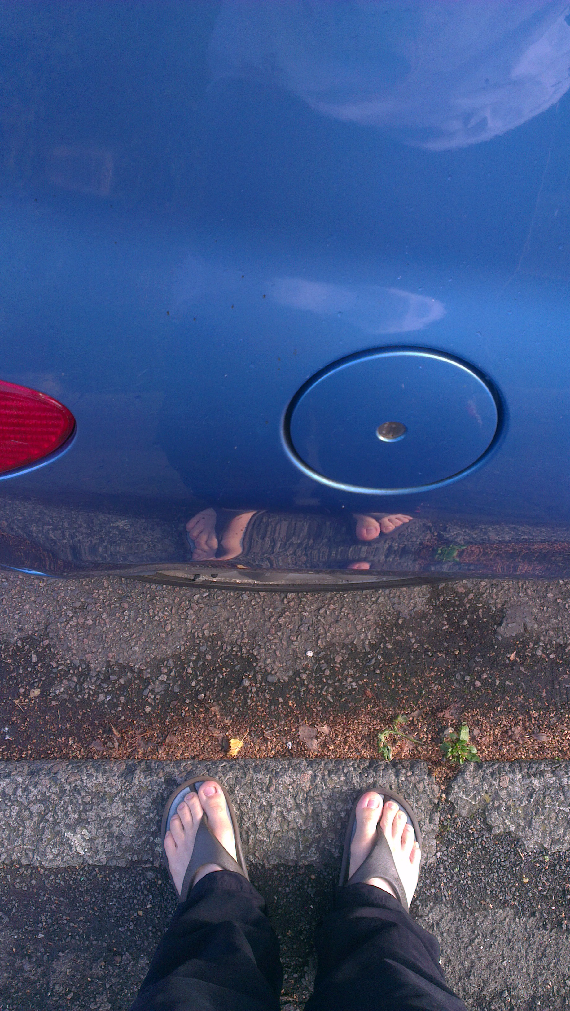

Points for appropriate footwear! It looks fine!
Car barely looks damaged. Get a quote on dent repairs. Doubt itll cost much.
Whereabouts in Northants is he? I'm in Leics but work in Northants. Pictures look OK, beam looks like it might be going but that's probably unrelated.

The only thing I would be checking is the beam.

He is more concerned at the clearance issues he has with that wheel with his arch, apparently its been "knocked in".
The dents are dents he is not going to cry about it, he's just concerned about damaged suspension/beam considering it was fine before the accident.

possibly bent both trailing arms
the one thats hit
and the oposite side where its hit the curb
maybe a new beam needed

Possible new beam, but a beam isn't at all exspensive really, if its drum.
(29-10-2013, 08:35 PM)Dean Wrote: Possible new beam, but a beam isn't at all exspensive really, if its drum.
£80-100 for a replacement beam around this part. Easy job to replace, only hard bit is finding female torx bits.

Where in Northampton is he mate? anywhere near my HP21? I'm off work tomorrow if he wants to pop round for a better opinion as IMO that doesn't look particularly damaged at all and ill knock his arch out a little bit for him too.

He's probably not too far, but i guess the major issue is, is the car safe to Drive?

As long as the wheel isn't rubbing or there's no sharp edges to catch it'll be fine.
