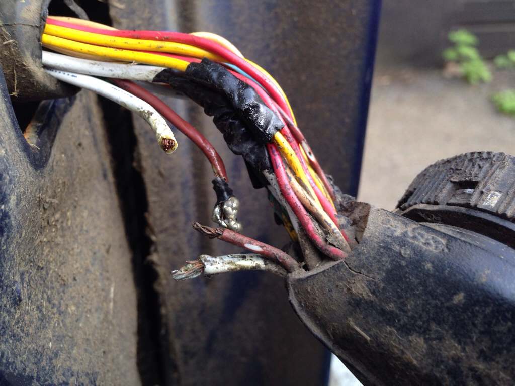

My driver side window control switches have just stopped working, the passenger side is all good. Previously it only worked when the door was shut.
Any ideas? It's a ph2 GTi-6
Just started working now. Dafuq?
Now stopped working. Whaaaaa
wiring in door loom.. it should work with door open and shut ...so points to wiring in door loom to me
What Piggy said ^^^^^^^^^
I've got the same problem with my central locking on my drivers door, if I wiggle the loom about it works again. Gonna have to either buy a new loom to solder in or replace the individual wires
Fixed it Wink looks like someone had tried this before!
nice!
good find though!
Is the loom easy enough to replace should I need to? I can't see where it goes behind the dash. Or should I just repair the wiring should it happen again?

its been repaired like that year and half, my first soldering job Smile
I was planning on replacing the loom but then looked at it and it appeared easier to solder the wires rather than trace them back, surprised its gone tbf

I wouldn't worry about it mate, all fun of owning a 306 Wink

(29-08-2013, 10:55 AM)callumcull Wrote: I wouldn't worry about it mate, all fun of owning a 306 Wink
I think just car in general, well french car.
I'm surprised its broken again though, I'd resolder them again if I was you, would be a nightmare trying to splice in new wires and would need soldering inside still
