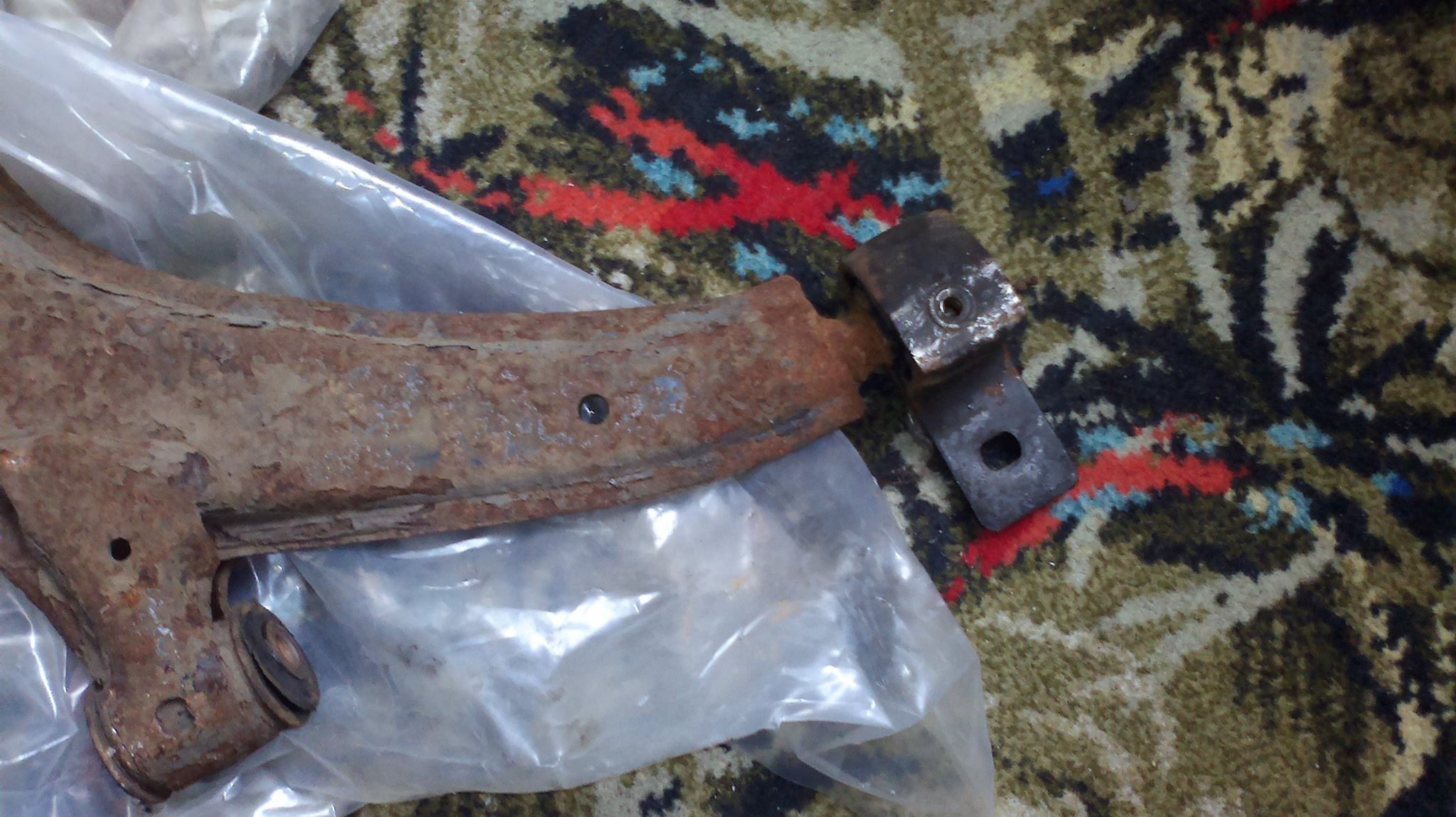

just changing my wishbones again and in a nut shell i've sheared the small bolt off that screws into the P bush . . . .guess i could drill it and tap another bolt in if need be but i'm strapped for time a bit . . .
anyway do we think it'll live without it? doesn't seem to do much . .
pic just for reference it's the upper bolt hole in the picture, new wishbone is on the car now . .
Absolutely not.
Prevents axial movement of the rear bush around the larger bolt.
Yep, you need that one.
drill and tap another one then i guess . . .Sad . .why do i always break something? . .lol

If you slip up with drilling/tapping it, tap it out to M10 and fit an M10 bolt instead, the subframe hole is large enough for one, as that's what I use on my wishbone mounts.
(19-08-2013, 04:05 PM)Rippthrough Wrote: If you slip up with drilling/tapping it, tap it out to M10 and fit an M10 bolt instead, the subframe hole is large enough for one, as that's what I use on my wishbone mounts.
what all the way through the P bush you mean? . . .
sorry . . forget that i know what you mean . . .Smile
do you know what size bolt it's supposed to take Phil?
M8x1.25 most likely I don't think there a fine thread

Looked at the new ones I have here its m8x1.25 like Jenk said
(19-08-2013, 05:14 PM)306Dan Wrote: Looked at the new ones I have here its m8x1.25 like Jenk said
beauty . . how long mate? . . .Smile
normal bolts are 15mm iirc the threads on these new bushes go 12mm in plus 3-4mm for the sub frame
(19-08-2013, 05:27 PM)306Dan Wrote: normal bolts are 15mm iirc the threads on these new bushes go 12mm in plus 3-4mm for the sub frame
legend . . .now, wonder where i can get a couple tomorrow? . . . .Dodgy
most motor factors have random bolts in boxs and m8x1.25 is quite a common size, failing that if your near a scrap yard a 306 shock top mount bolt is the right size

thanks Phil, i haven't got a tap and die set or for that matter have i ever tapped a hole (giggady), so . .gonna remove wishbone tomorrow and hope there's a bit sticking out so i can remove it . . . . Undecided

How did you do them so tight?! I done mine with a heavey handed 1/2inch ratchet and they didnt break!

result today . . . . managed to stake the remainder out with a screwdriver, found a suitable bolt off an old Bosch pump and fitted it . . . .not so good result, just finishing other side now and they've given me an 18mm balljoint wrongly and it's riveted on ffs . . .phoned parts place now and they're phoning me back if they've got one in stock . . Sad

Didn't forget the washer did you?
If they bottom out in the thread they'll snap very easily.

no . . . .tbf it's an 18 year old bolt, it's had a decent life . .Smile
