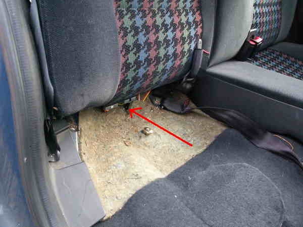

Grant. The box that controls it all is under the rear bench, drivers side. There is a lock and unlock signal wire in there somewhere (seen it mentioned with wire nos either on here or the GTi forum) presuming they will be positive trigger.

(16-08-2013, 09:16 PM)Chris Wrote: Paul, if you want the rf locking its likely to be easier to do a full ph3 loom conversion.
Reason being all the ir stuff is done through the box under the rear seat, while the rf is the bsi box wich also controls all the indicator wiring too.
But if anyone can do it without changing the loom I'm sure you could.
I've not come across a box under the rear bench mate?
My interior is fully stripped and the only black boxes are under the drivers seat and behind the drivers rear quarter Smile
On the ph1s its tucked up under the black tin shit.
On the ph2 it may be in the rear quarter, black box iirc with two big multi plugs going into it one white and the other grey.
[Image: sig.jpg]

[attachment=9678]
Sounds like the one in the rear quarter.
Mines Ph2 y'see Smile
[Image: sig.jpg]
Definitely not got that lol

On my phase one, it was the box under the rear seat, the plug had 2 orange wires going to one terminal and 2 purple wires going into another, negatively triggered. I tapped into one orange and one purple and now i can lock and unlock from 100meters away Smile

The lock and unlock wires are easyest to find under the drivers side rear bench seat

I do not hoever have a box under the bench. I have one under my drivers seat?
