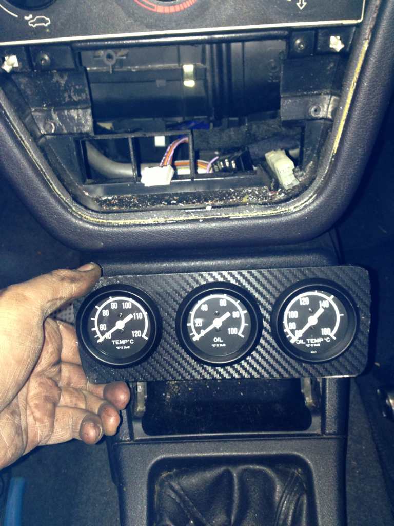

Right so I'm getting pissed off with having no gauges to look at other than boost, my fuel gauge is dodgy, no oil gauge, no water gauge, no rev counter, speedo currently broken etc.
Want to buy a load of cheapo eBay gauges just to give me a bit more awareness of whats happening..
I already have:
- Autogauge 52mm 30 PSI gauge (white face)
- Stack EGT Gauge 52mm (black face)
- Volt Gauge 52mm (white face)
Boost gauge is plumbed in, volt gauge isn't and probably won't be. EGT gauge I was going to save until I went GT/newer/expensive series turbo but it could end up on the TD04-13T.
So what else do people reccomend getting?
Oil preasure?
Oil temp?
Water temp?
What sort of min/max range do I want for the above?
Suggestions welcomed..

oil ranges normally quite universal, xud water temp from 60/70 - 120 should be more than enough.
I got some TIM mechanical gauges oil temp, pressure and water temp and they are awesome
Didn't have a lot of luck/faith with cheap electric gauges and senders
Cheers so water 60~120 +/- 10.
Oil gauges I've seen between 50~150 and 100~300. So the 50~150 will be suitable.
Then for oil preasure 0~80?
All look ok?
