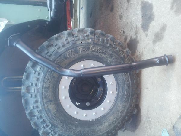

This is standard cat with the box cut out (and painted)
Then my mid pipe/box with the a straight pipe in place of the back box (looks long because its an estate)
