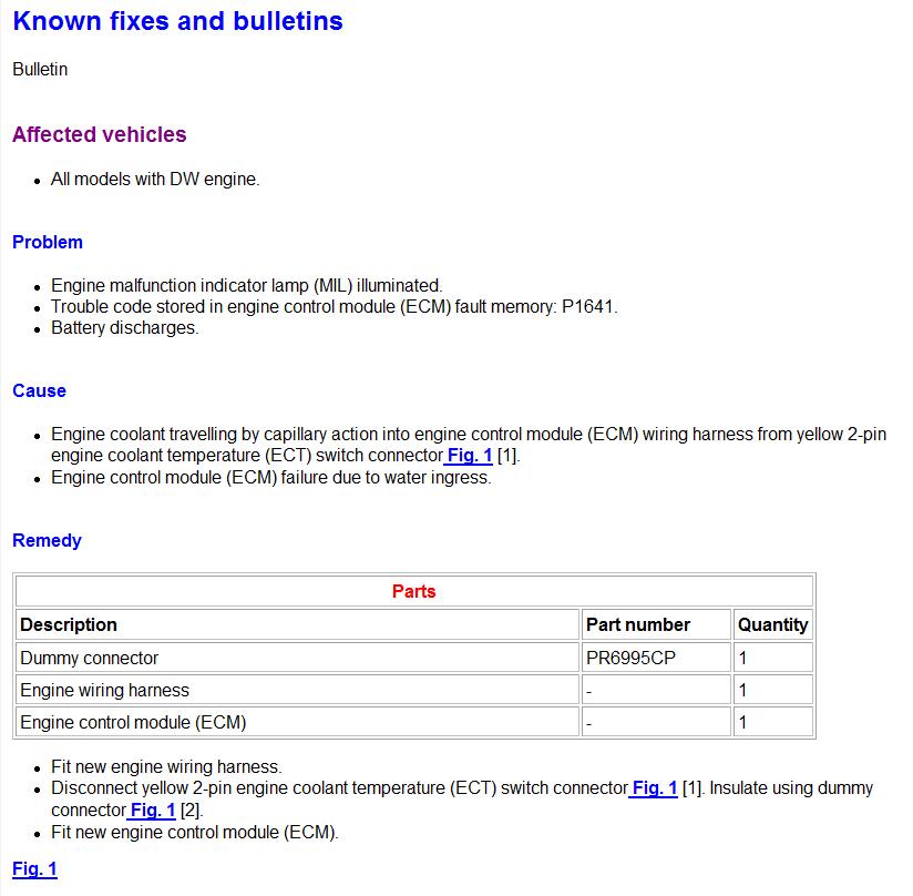

according to auto data there is a know problem with the coolant temp sensor that tracts coolant to the ECM!
.pdf   dw8.pdf (Size: 66.26 KB / Downloads: 230)
(30-03-2013, 06:24 PM)cully Wrote: according to auto data there is a know problem with the coolant temp sensor that tracts coolant to the ECM!
Hi Cully,
Thanks for the info I'll check that out tomorrow. Any idea where I would get these parts from is it Peugeot main dealer?
Cheers Ash.
probably pug main dealer for the upgrade kit
ecm is the ECU!
(30-03-2013, 06:37 PM)cully Wrote: probably pug main dealer for the upgrade kit
ecm is the ECU!
