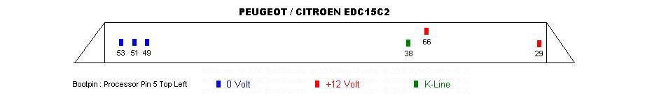

Pin map for EDC15C2 1 plug
Channel No. Description
1 +12 volts supply (after double relay)
2 Output:control of injector N° 1
3 Output:control of injector N° 3
4 Output:control of injector N° 4
5 Output:control of injector N° 2
6 Output:control of injector N° 2
7
8 Diagnostic line for the coils of the fan unit control relays
9 Diagnostic line: CAN H network
10 Diagnostic line l
11 Input:air temperature sensor IAT
12 Input:Camshaft position sensor CMP
13 Input:Mass airflow sensor MAF
14 Input:Crankshaft position sensor CKP
15 Input:accelerator pedal sensor APP
16 ---
17 Cruise control switch
18 Input:camshaft position sensor CMP
19 Input:vehicle speed sensor VSS
20 ---
21 Input:Cruise control clutch pedal switch
22 GND for APP,FTS,IAT,MAF
23 Output:engine coolant temperature information (gauge and warning lamp in the instrument panel)
24 Output: Swirl control electrovalve
25 Output:control of fan unit group 1
26 Output:boost pressure regulation electrovalve
27 Earth:air conditioning pressostat
28 Output: inlet air heater throttle control electrovalve
29 +12 volts supply (after double relay)
30 Output:control of injector N° 1
31 Output:control of injector N° 3
32 Output:control of injector N° 4
33 Earth
34 Input:Fuel pressure Sensor
35 ---
36 Engine immobiliser serial line
37 Diagnostic line:CAN L network
38 Diagnostic line k
39 Input:fuel temperature sensor
40 Input:camshaft position sensor CMP
41 Input:Crankshaft sensor CKP
42 Input: differential pressure sensor
43 ---
44 Input:Accelerator pedal position sensor APP (5 volts)
45 Input:Engine coolant temperature sensor ECT
46 Input:Engine coolant temperature sensor ECT
47 Input:air conditioning on information (AC/ON)
48 InputConfusedtop lamp switch connection
49 Earth
50 Output:fuel pressure control solinoid
51 Earth
52 Output:Exhaust gas recirculation solinoid 1 (EGR)
53 Earth
54-
55 Output:Exhaust gas recirculation solinoid 2 (EGR)
56 Output:preheating warning lamp
57 Output: fan unit control: mid speed
58 Output:Engine coolant heater relay1
59-
60 Cruise control switch
61 Cruise control switch
62 Output:engine speed to instrument panel
63 Output:fuel consumption at any moment (trip computer)
64 Input:accelerator pedal sensor
65 ---
66 Engine immobiliser serial line
67 Output:Glow plug timer relay
68 Input:Accelerator pedal position sensor APP
69 After ignition +
70 Input:catalytic converter temperature
71 Input:inlet manifold air pressure
72 ---
73 Input:unused brake switch
74 Input:fuel pressure sensor
75 Air conditioning pressostat (26 bar control stage)
76-
77--
78 Input:AC refrigerant triple pressure switch
79 ---
80 Output: 3rd piston cut off solinoid
81 Output:engine coolant temperature information (instrument panel)
82 Output:diagnostic warning lamp (instrument panel)
83 Output:Engine coolant blower motor relay
84 Output:AC compressor clutch relay
85 Output Engine coolant heater relay
86 Output:double relay control
87 Output:Fuel shut off switch via double relay control
88 Output:Glow plug timer relay
please dont take this list as being correct for your car check before doing any diagnostic work as i have included sensors in the list not used on the 306 HDI
