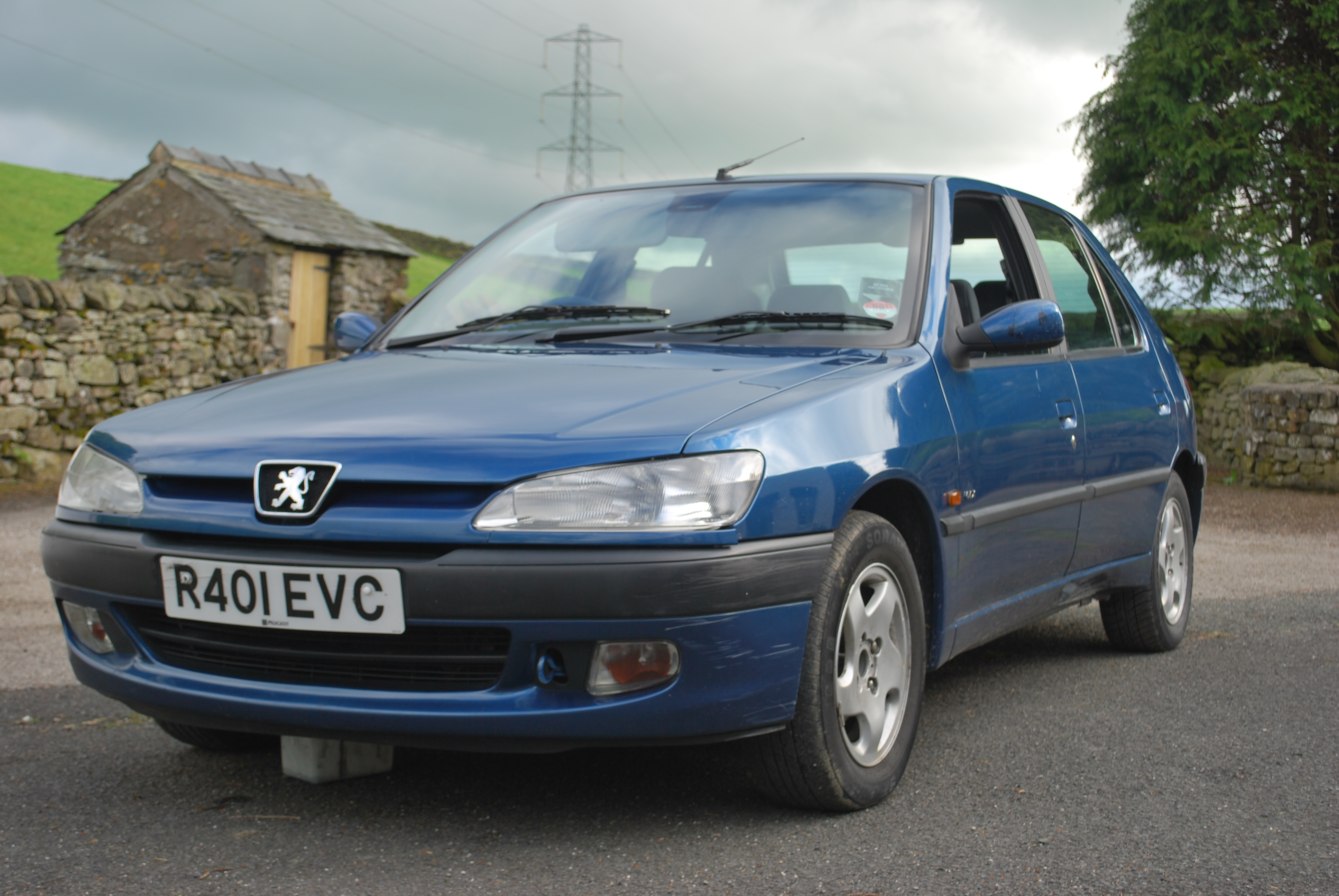

I finally got round to picking up my 306 earlier this week.
It's an R reg, 1.9 TD on 67,817 miles and everything is completely standard, even the brakes unfortunately, as it would be nice to actually stop.
There are scratches here there and everywhere, so will probably need a total re-spray at some point. Will also need to change the seats, think they are a bit of a bio-hazard at the minute. Only cause for concern at the minute is someone decided to take it off roading and has buggered the sump, which is leaking through two bolts as far as i can tell. Should have replacement by this weekend though.

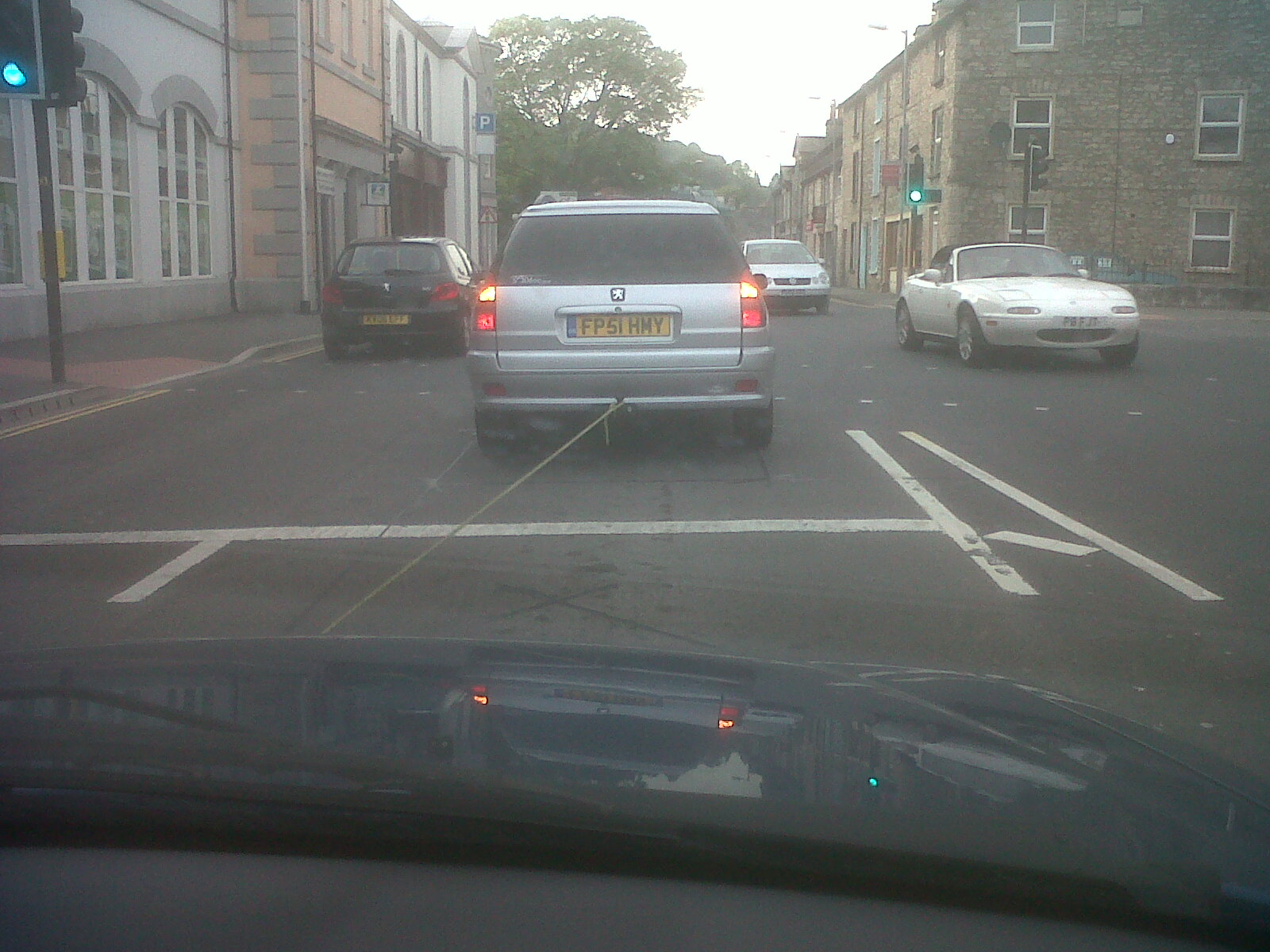

Went to accelerate earlier, then lost all power. Rang Jonny and we had a good look, it seems there's a fuelling restriction as there's no smoke but no power. The injection pump's making a funny noise too :nope:
So we towed it to my house and I'm just going to leave well alone until after FCS, then try changing the pump over for a bosch.
See you all at FCS, I have a stand pass going if anyone needs it.
Jonny towing me through town Sad
[attachment=0]
Fooking gutted mate, I have been thinking about this since you rang,
try locking the timing as the belt may have jumped which would explain it running but no power!
Team Orange Engine Bay
Yeah I guess it could be timing, but I'm pretty sure it's pump related, it runs smooth on idle and revs nicely but just won't pull, hence my thinking that it's fuel restriction or pump giving up.

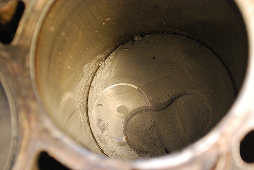

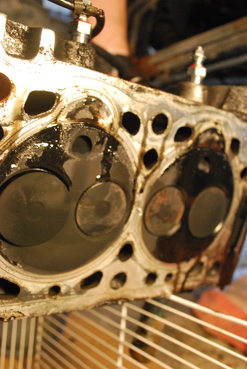

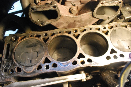

We believe that pistons have had a disagreement with the valves, which may explain the loss of power. I've attached some pictures which show where the pistons have it the valves.
Gasket is pretty buggered as well, blown between two pistons.
Thinking of starting by getting another head, there's no way an impact that "small" would have bent a conrod is there?
Both of us are starting to run out of knowledge on this one, any input welcome!
Well that looks like it was recent, the mark still looks shiny and everything!
I can't see anywhere in those pics where it looks like the gasket has gone though but then there will be no awards for the quality of the photography Tongue
Also, did you swap the rad over and see if it was pressurizing? because as I pointed out to Jonny the other night, you have a hole in your rad so it will never pressurize when its like that.
The rad was swapped Mark, found a nissens in the scrappy, it wasn't pressurising, but the HG is blown between cylinders.
Bear in mind this has ran for maybe 5 minutes since the sudden loss of power, so it is recent!
