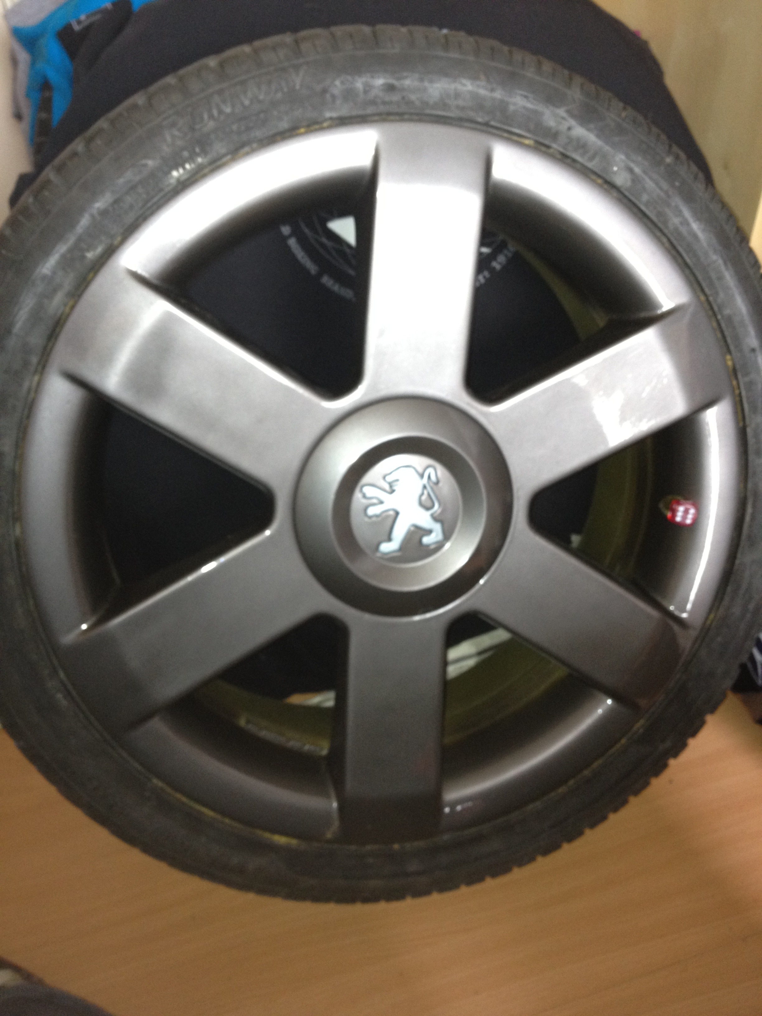

Right here we go. I'm not 100% happy with the down to my spraying. They still need flitting and polishing which I'll do Wednesday. But I love them Smile.
My bedroom is too bright so they look darker.

Looking good mate, bet you can't wait to get them fitted eh!

I can't wait. Like I say they really ain't perfect one needs redoing before fcs.
