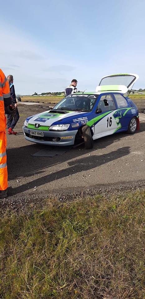

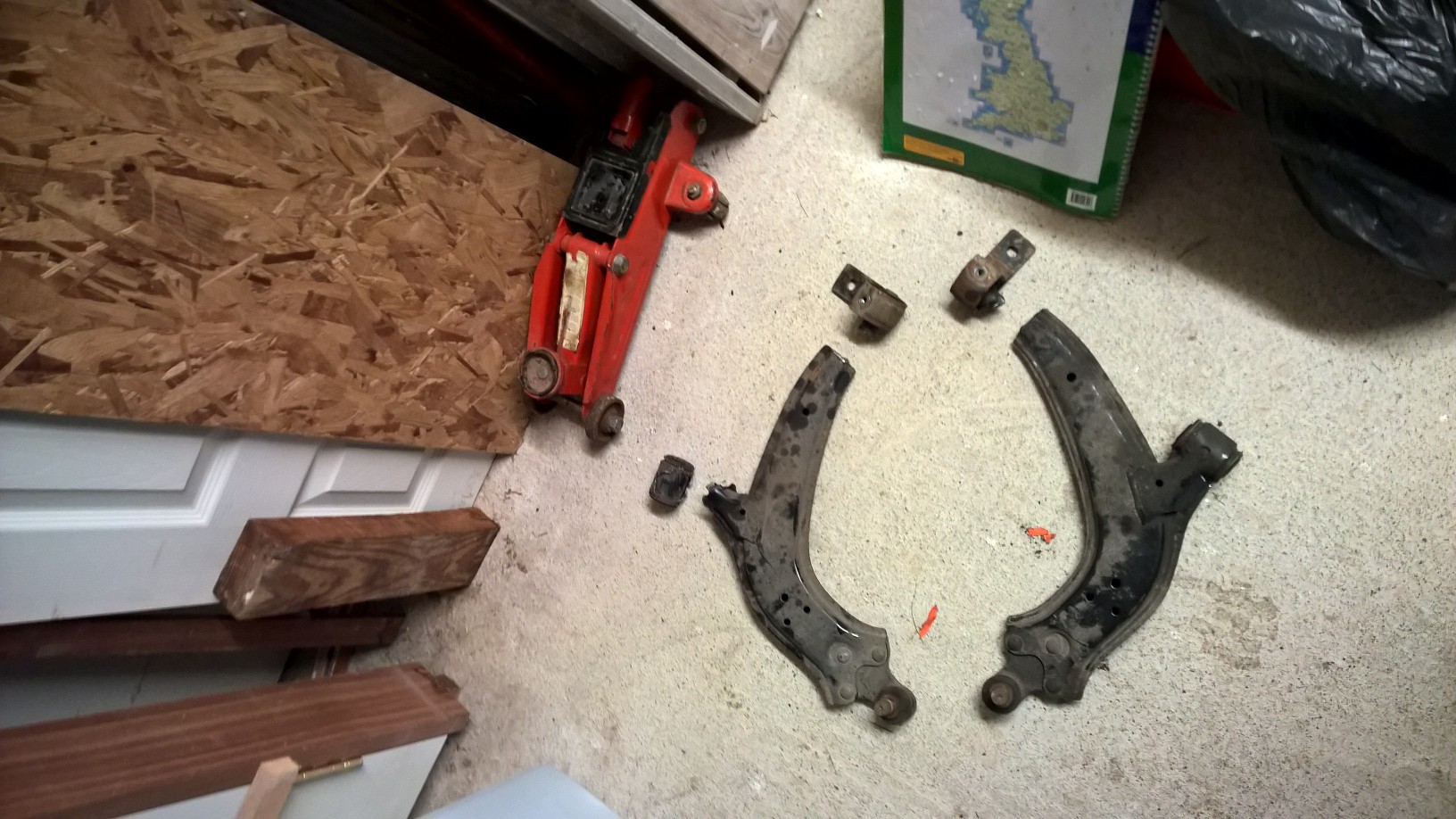

They were OEM albeit of dubious age.  The first unit failed at a hairpin at the end of a long straight on an airfield. The surface tarmac was rippled with a lot of loose on the surface.  It felt like we had a puncture until braking for the hairpin when the suspension collapsed and the nearside wheel was forced back into the wheel arch.  On the 3rd stage we again thought we had a puncture at the same place and carefully brought the car through the stage and into service.  On this unit the stub going into the P clamp had sheared and there was evidence that the bobbin mounting was beginning to tear away.  This, I think, was the sequence of events with the first failure but with heavy braking the pin sheared then the mounting ripped off.  I have replaced both with MOOG units from Spoox motorsport.  Any good ?

Pretty sure those weren't genuine wishbones as the ball joints are secured with rivets. Originals have bolt-on (& hence replaceable) ball joints, as do most better quality aftermarket replacements. Not sure on the quality of the Moog ones but have often seen Lemforder recommended as decent aftermarket options.

No corrosion evident.  The pins look to be cast - maybe steel pins would last longer.  I guess with suspension parts there has to be a 'sacrificial' weak link so if the wishbones were made bomb proof, the sub frame would take all the pain.

Moog are really really cheap, I;d be temped to try TRW as these where OE spec at £40.00 each with some Vibra Tec 'P' bush's, I've got Motaquip ones on mine and these have coped with bouncing off Kerb's to date
Seen the breakage a few times before even after a few miles in some cases, Got to love aftermarket parts and to me the lack of testing of them plus companies willing to sell them to make more margin over decent brands

moog is just cheap motorfactor stuff, no need to go to a expensive 'motorsport' supplier for stuff like that!!
Go for TRW, I paid £40 for each wishbone a few years ago and they are still spot on now with a lot of miles on them. I've heard the roller bearing wishbones are an upgrade - think there's a possible group buy on going for them also (not cheap however). Nice car by the way.

If i was you i would try and get hold of some second hand genuine bottom arms and get some decent bushes put on them. I've seen it a lot with aftermarket arms breaking.
