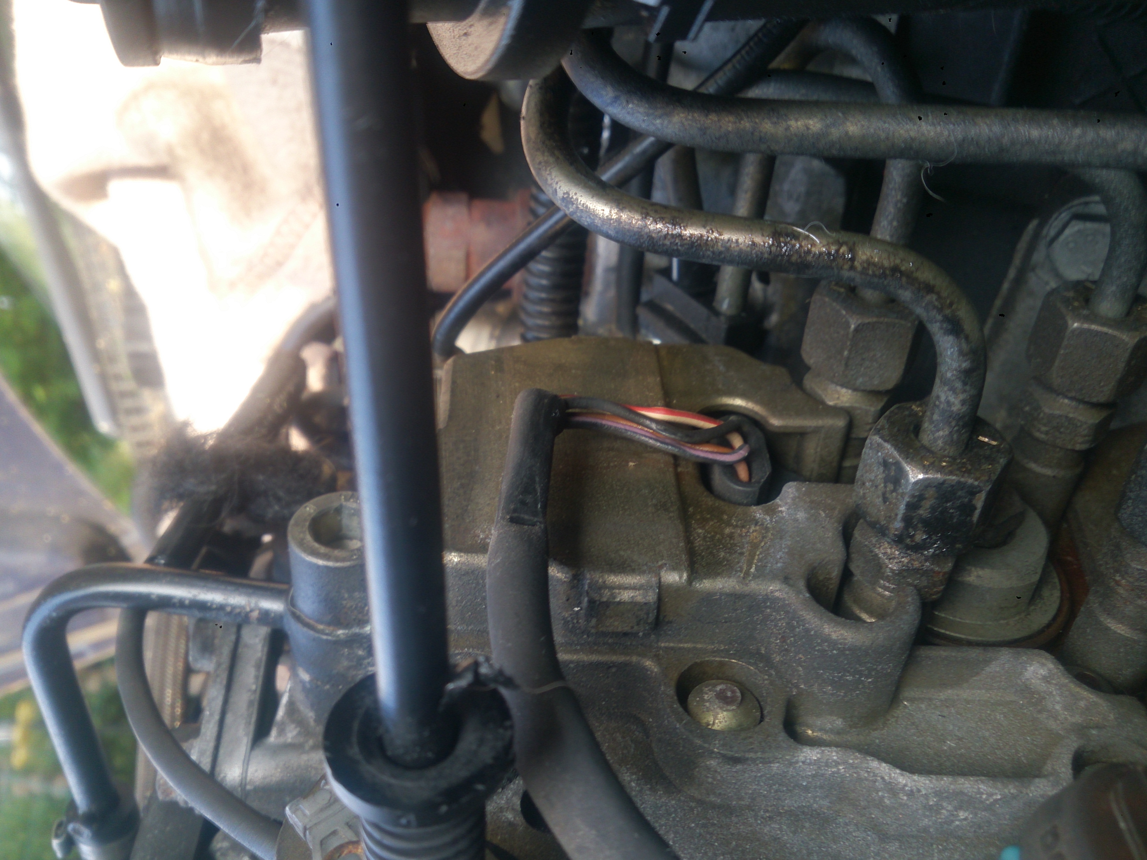

Yes. I have an idea.
Is that your actual pump in the top pic? Because I believe that "solenoid" you've removed isn't a solenoid.
Your actual stop solenoid us underneath a steel armour - which I can see in your very first photo isn't removed.
Can you show a picture showing where you removed this valve from?
Underneath that armour houses the immobliser chips as well so you can't simply cut through it, you need to remove the bolts.
My money is on an immobliser fault, not the pump. These pumps simply don't break in an unmodified state.

[attachment=31554 Wrote:Martin306 pid='622727' dateline='1528823464']Yes. I have an idea.

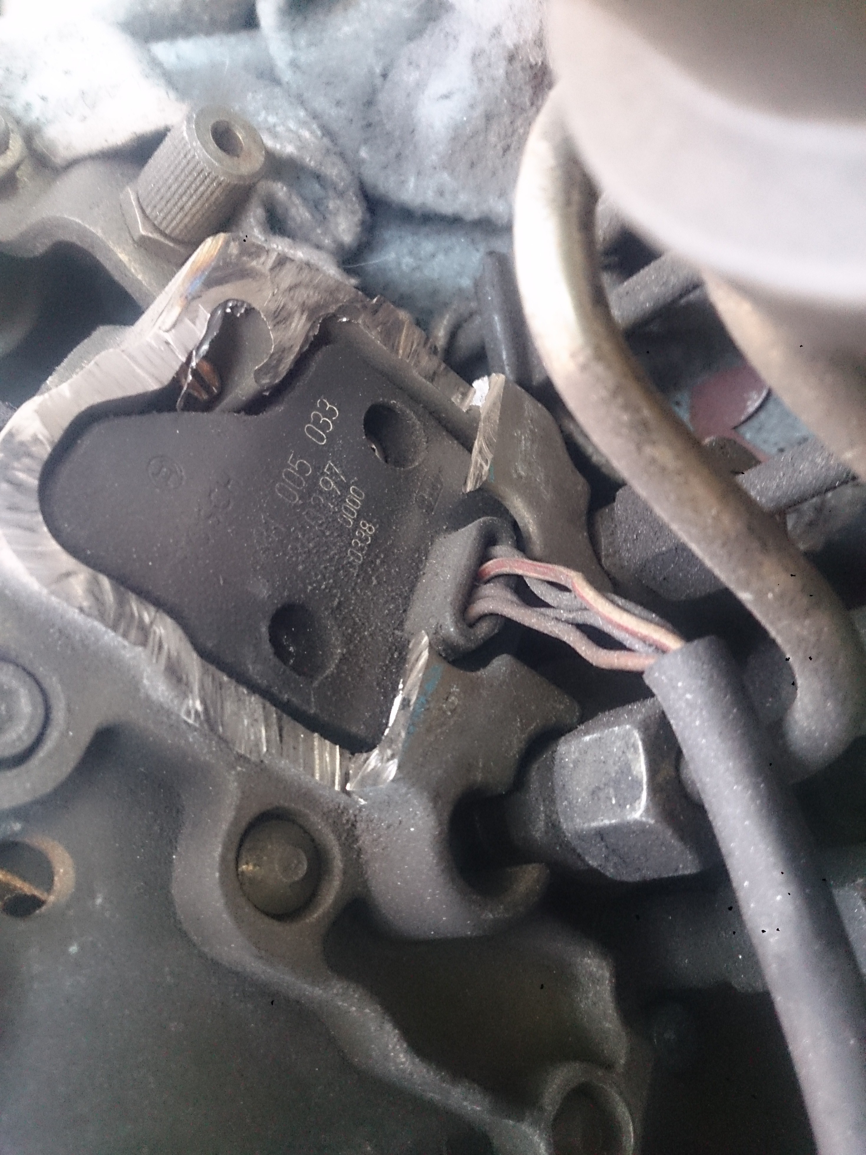

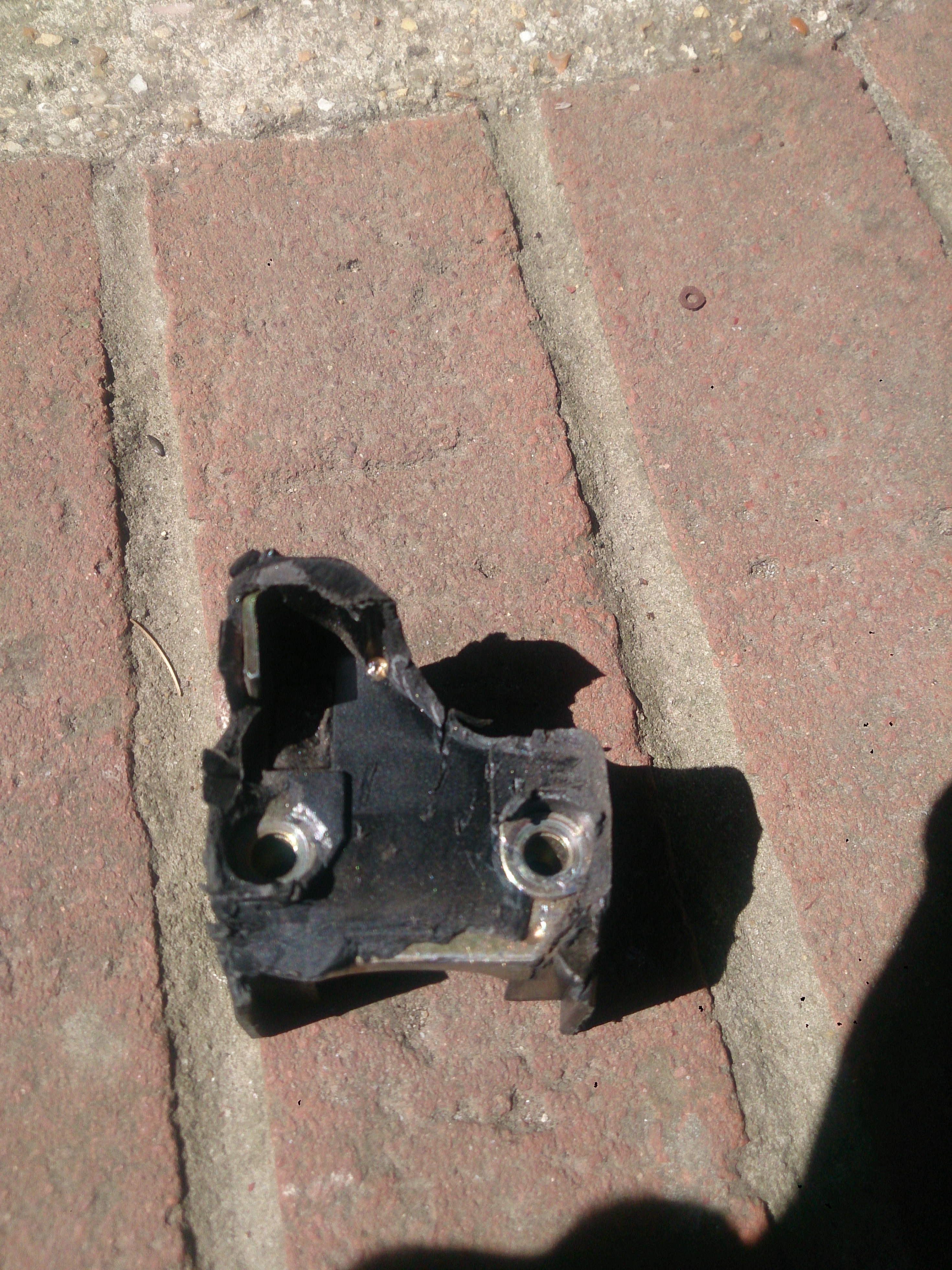

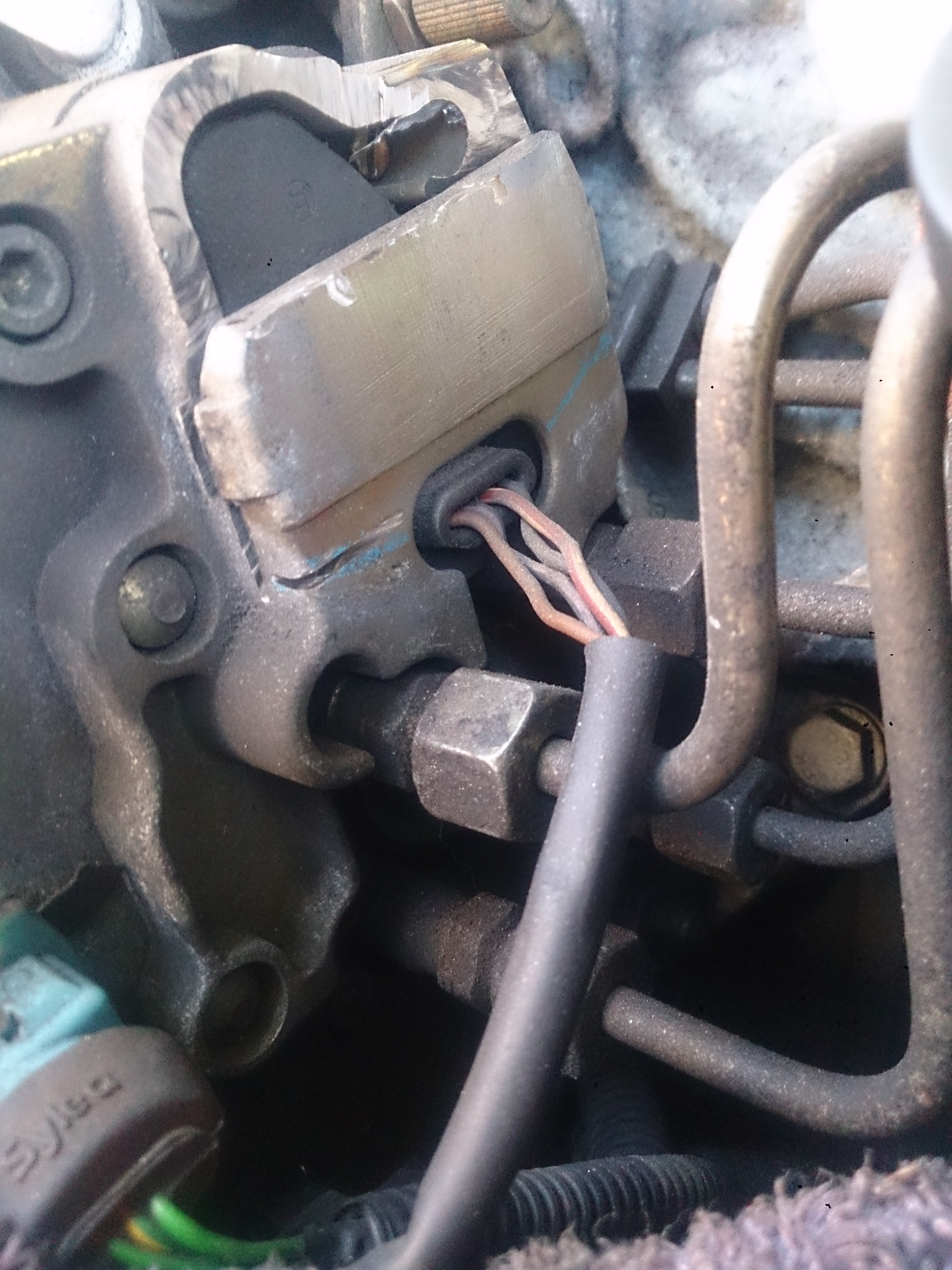

Can armour really be cut with the pump fitted?
(16-06-2018, 05:27 PM)modmytop Wrote: The oil pressure switch on this engine appears to be normally closed. With cable disconnected , light is off. Grounding wire brings light on. But no sound of solenoid click.
Yes if you undo the hard fuel lines and very carefully.
For me the hardest part was getting the lock pin out at the top of the armour. I can take pictures and post them tonight showing where you need to cut if you like?

I took a short video, my internet is terrible at the house but it's uploading now. I'll link when it's finished!
https://youtu.be/t4sxCXsVUxI
https://youtu.be/sXycYfUf7fk
Didn't even bother editing them haha just a general idea.

Hi all. Decided to tackle armour with pump still fitted. Probably not best decision, but was concerned about the tamper proof bolts.
5 inch grinder across top right edge, front and back edges.
Then used (Lidl bought) Dremel type tool to make horizontal cut.
Have to say pretty impressed with the tool. Thought the little cutting wheels/discs wouldn't last, but because they are thinner than the angle grinder discs you cut less metal. The problem is you have to hold the dremel absolutely vertical. If not, the disc breaks.
After removing top section for a look, decided to cut sides down further. Then used the hole that the immobilizer wires enter to save a bit of cutting. Unfortunately I should have gone a bit lower, as mentioned in a while.
After removing this 2nd section, I could see what I assume was the immobilizer module. I hacked into this with hammer and chisel. You work through the circuit board followed by some gelatin like sealant.
This revealed a plastic base held by 2 allen bolts, with a wire visible at the top going behind the plastic (to the solenoid). The hole I made wasn't big enough get this plastic base out, so I hacked at the bottom of it. Then I realised the top half was actually a metal box covered in plastic. It slid towards the hole, but was just slightly too big. So dremel again to cut a bit of the armour around the original immobilizer wire hole.
Eventually the metal box slid out to reveal the shut off solenoid. Red wire from the immobilizer loom, previously measured as switched 12V, connected to solenoid wire.
Then she started first turn of the key!

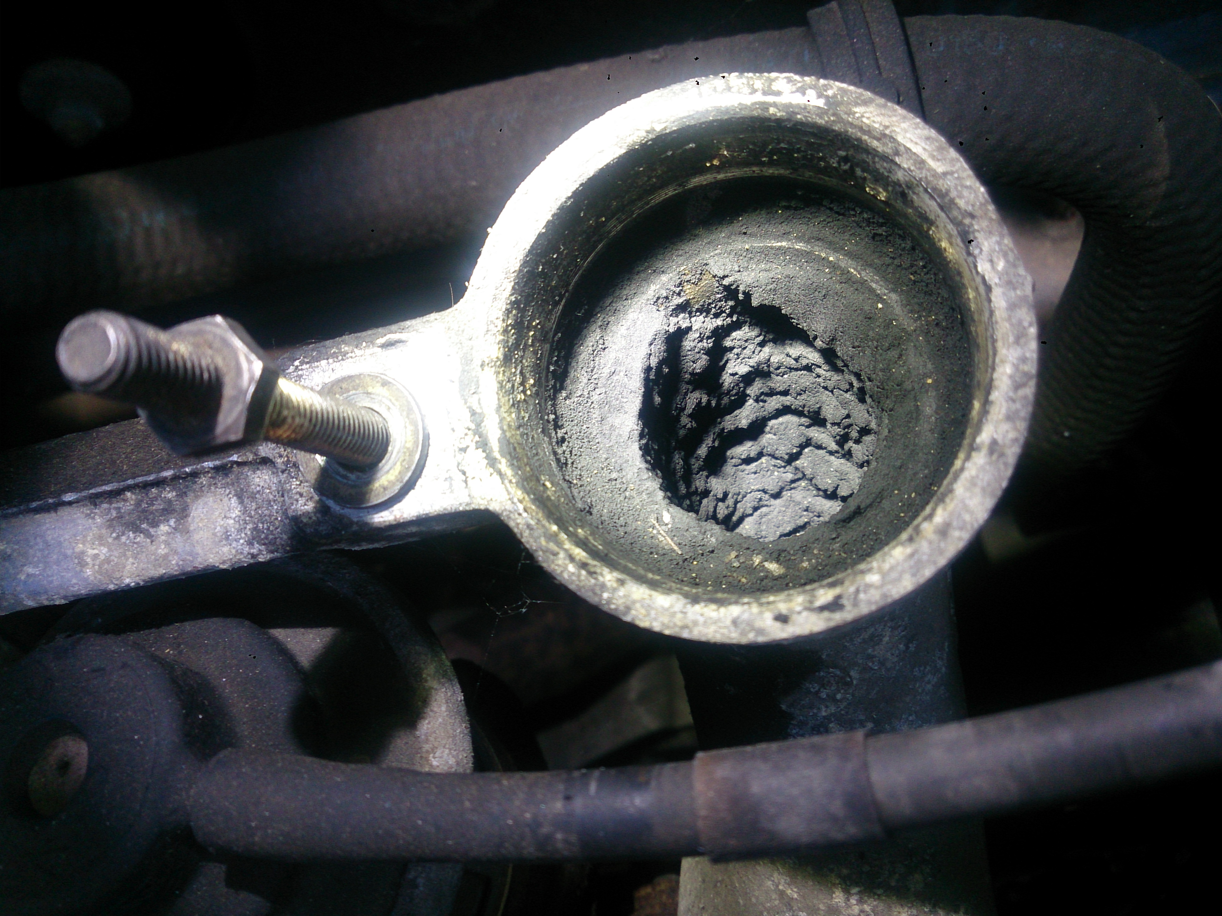

Inlet air pipes look pretty bad. The ones closer to the battery are the worst. Presumably crankcase breather fumes being recirculated through air distribution chamber.
Glad you've got it going! Smile
It must have been unable to read the key for some reason. Not that is matters now!
My 106 inlet was like that, I put a wire pipe cleaner into a drill to do my inlet manifold. Not much else can go up there!
