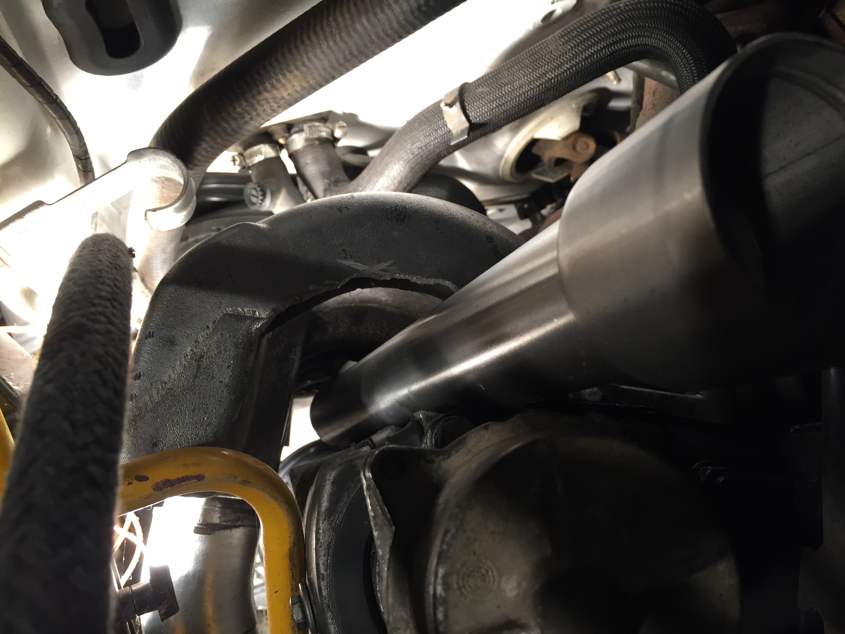

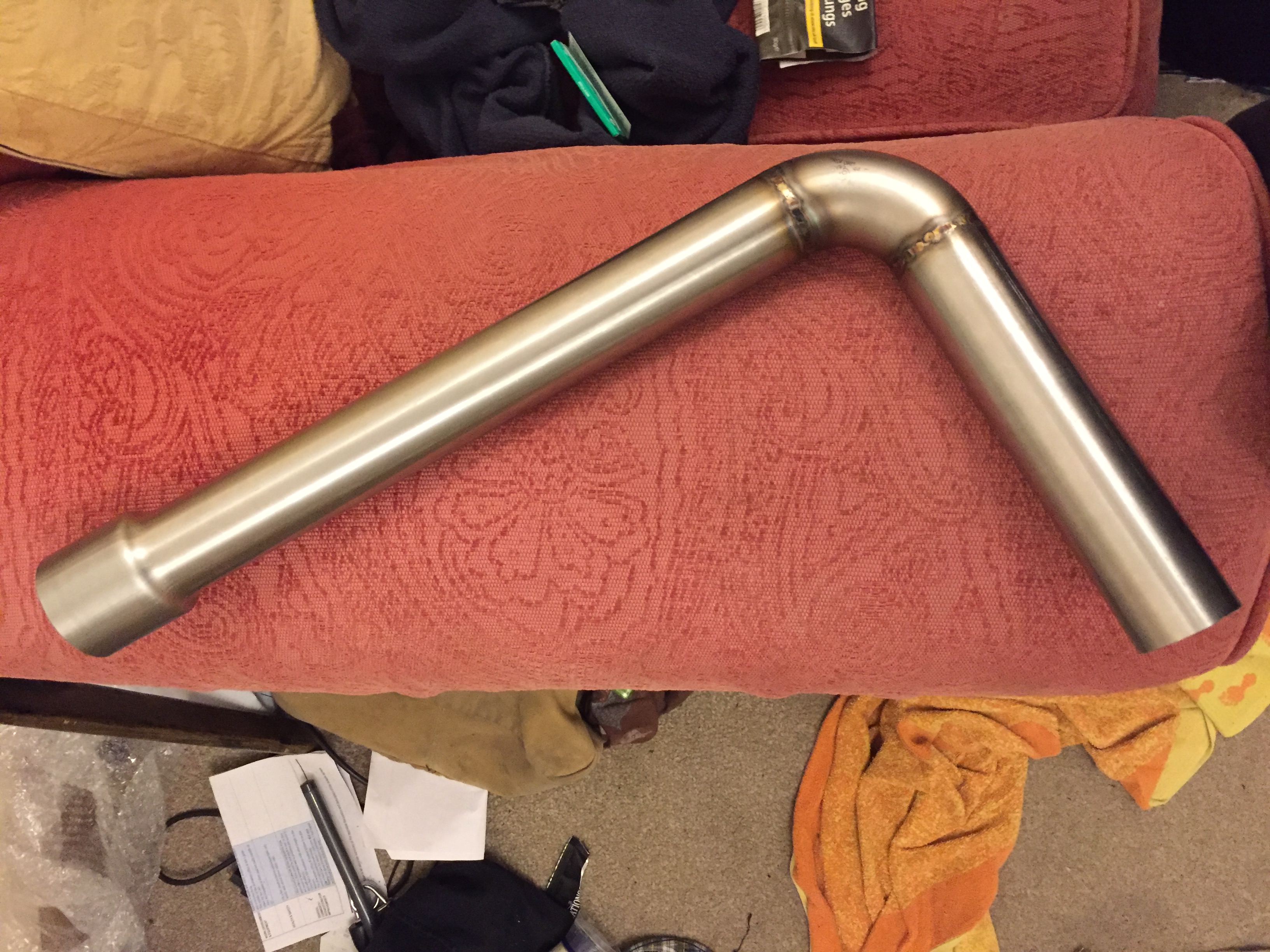

Ite so took a step backwards this week as i wasn't happy wiith how the turbo pipe was clashing with the master cylinder so i decided to route the pipe the other way. IF ONLY I DID THIS WHILE THE ENGINE WAS OUT!
I did a quick drawing on my lunch break of what i needed, estimating most of the sizes from pictures. I went to an exhaust place to check if they had what i needed and came home with some pipe, later realising i hadn't checked any of my dimensions... whoops
luckily my guesses were spot on which im going to put down to being a draughsman Smile
My friend welded up the pipe for me and came to lend a hand.
I had to take off intake mani (again) and modify the other side of the for the pipe to fit. then we fitted it back on along side the new stainless pipe. this was done with the usual "can you put it in? ...i cant find the hole... grip the shaft.... its really tight"
we messed around with some piping and did a good enough job to start it up and listen to turbo noises and called it a night there

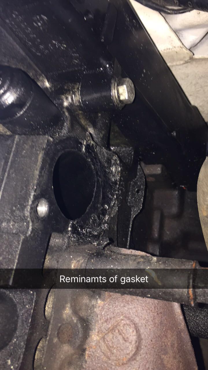

When i took the intake mani off to swap the turbo pipe i forgot there was a gasket, Doseph strikes again! so i'm only making 10psi when i should be making 16-18 and there is no top end power. Ive got the gasket to put on but its cold outside.

I fixed the intake gasket at the weekend  TMI
first time putting my foot down was mental the acceleration feels almost scary, it all seems sort of worth it now.
Weirdly im making more boost than i was before, I'm putting this down to replacing the interwarmer with a pipe...?

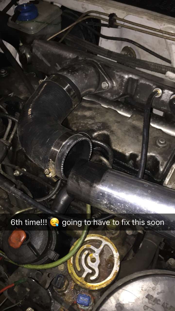

so this keeps happening Censored
I think I've got to the source of the problem... I need a bigger turbo  Itwasntme
you need a bead roller, or some weld.
re glow plug switch. a simple 555 timer circuit & relay would sort that.
Hate Housework!
yeah need a bead roller, although some people swear by hair spray Big Grin
his popping over tonight so i can have a fiddle to sort this issue. Also his gonna take a work friend in this as well as he doesnt belive fast diesels are a thing

That night me and Bash fixed the pipe with some Tresemme and a non-chinese clip, i scared his friend and it has been boosting ever since.

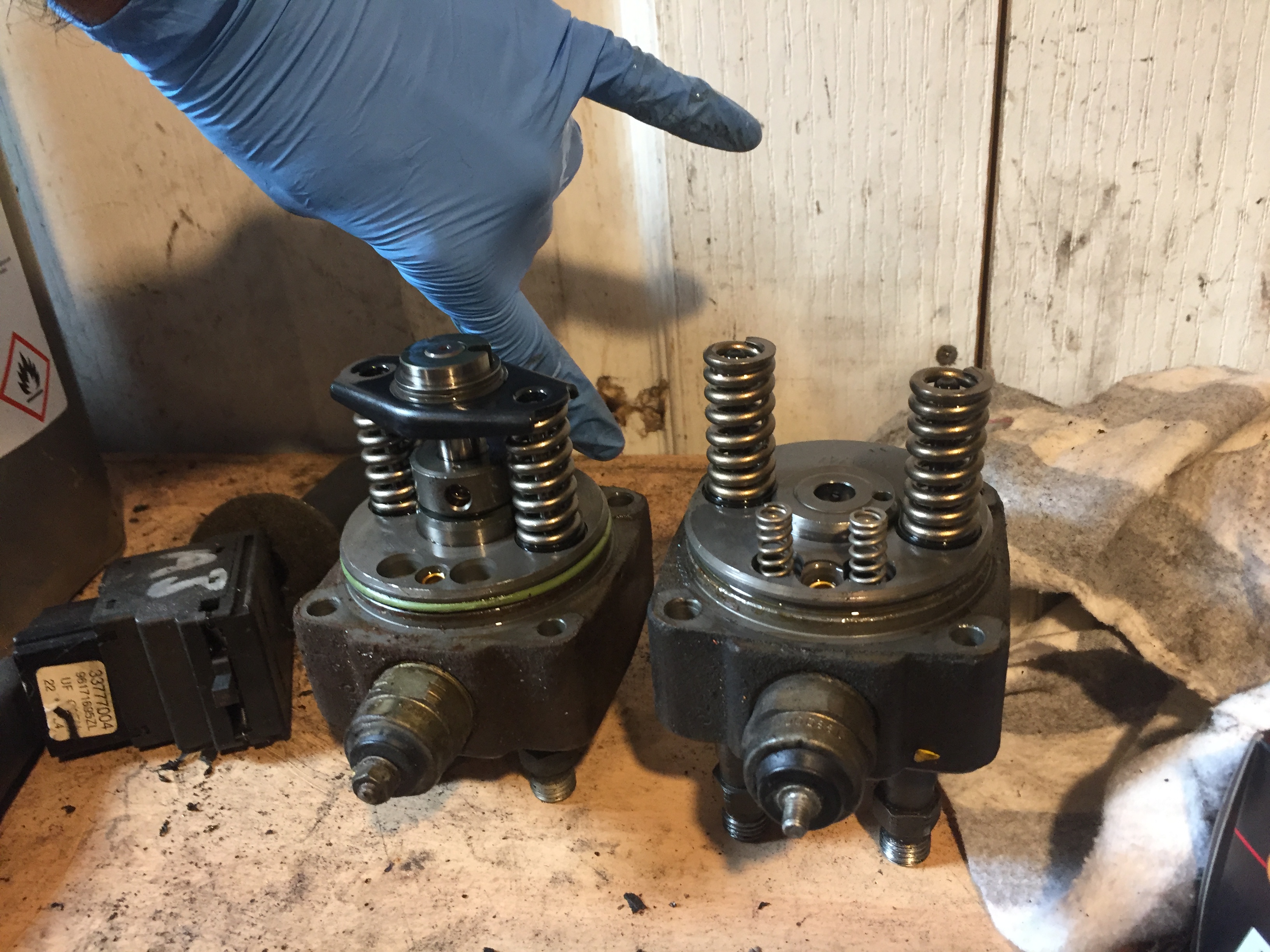

So Bash came over with a set of allan keys (which he borrowed) to do the gov mod.
Things started of well for the fist 10 or so minutes, about untill Bash was taking off the top of the pump.
Now we have to understand something here, past-Bash is an arsehole and does not like future-Bash. Becasue of this past-Bash left the hot/cold spring in the pump when i resealed it a few years ago, something he told me he removed.
So as you would expect the spring dropped straight into the pump body when bash took the head off.... not good. We tried to recover the spring for "some time" which involed me getting a mouthful of diesel.... still no spring.

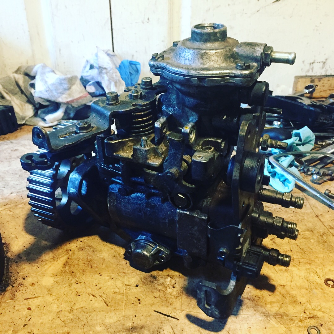

The next day bash arrived at mine, removed the fuel pump in about 2 minutes and had it completely apart in 20, even though some pikey had screwed up the torx head, (past-Bash strikes again).
We found the spring:
Once the pump was re-assembled and back on the car it wouldn't turn over smoothly, so the pump had to come back off. Turns out something had broken inside.... Now i think this was deliberate vandalism so i had to upgrade to a 10mm head.
So after a little road trip we had a fuel pump which now has all the modifications I want and no more pikey torx bolts.
- re-seal (was done a few years ago because it was leaking on veg oil)
- LDA grind (also done a few years ago with the re-seal for that aggressive throttle response)
- Gov mod (22% more fuel per stroke, no rev limiter)
- 10mm head (more fuel over a shorter duration)
