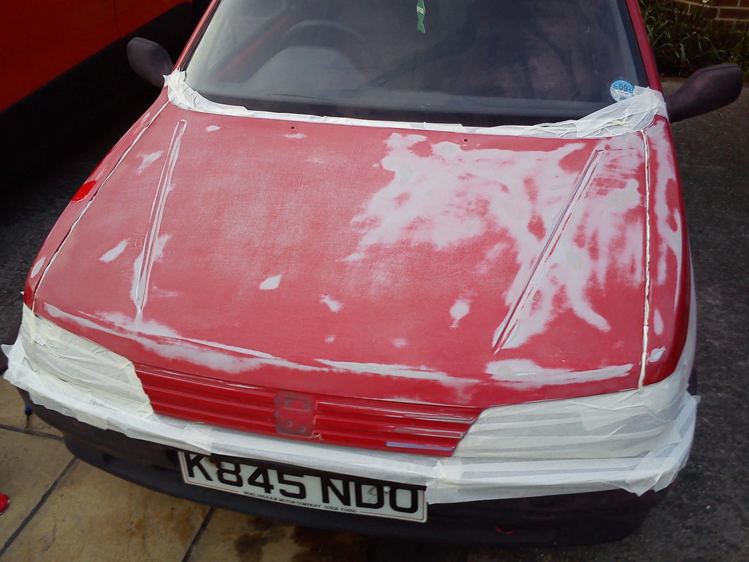

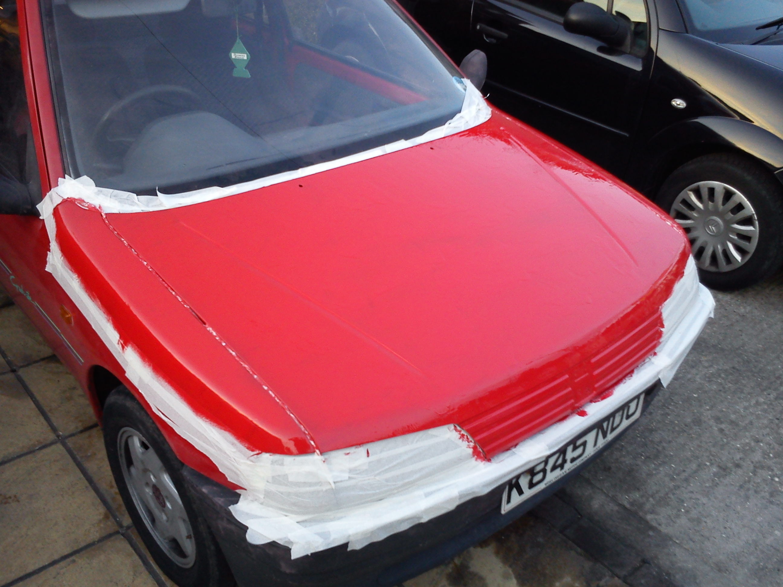

I also started sanding and painting the bonnet (red hammerite FTMFW)

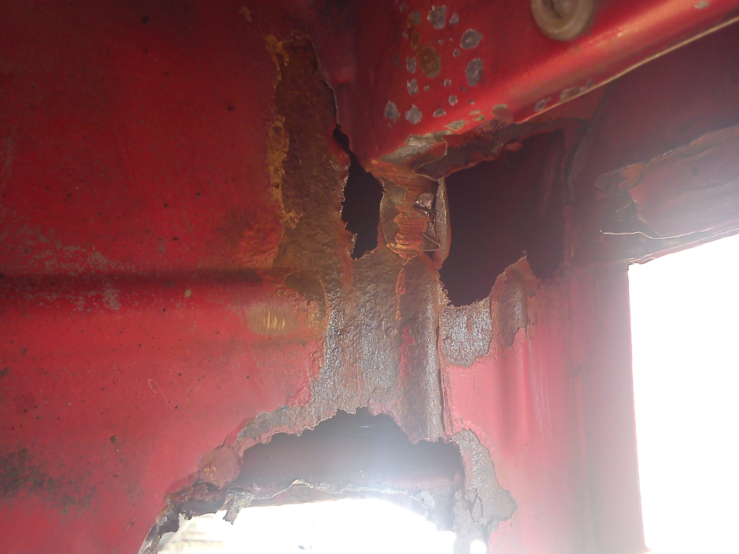

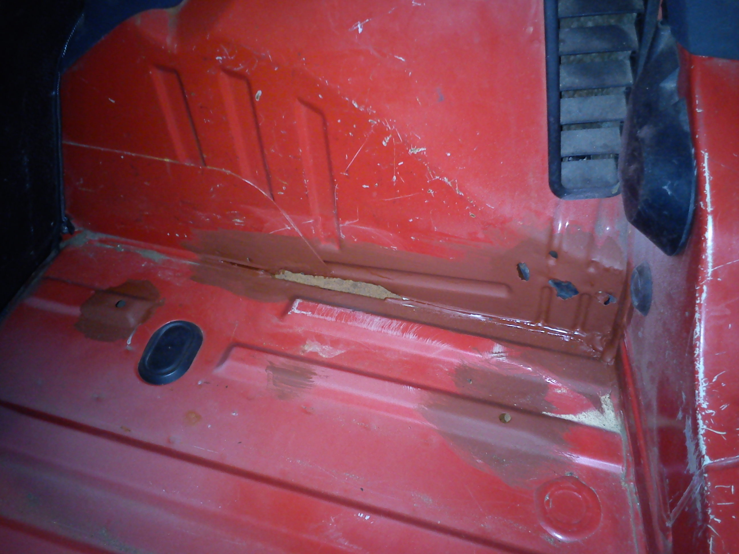

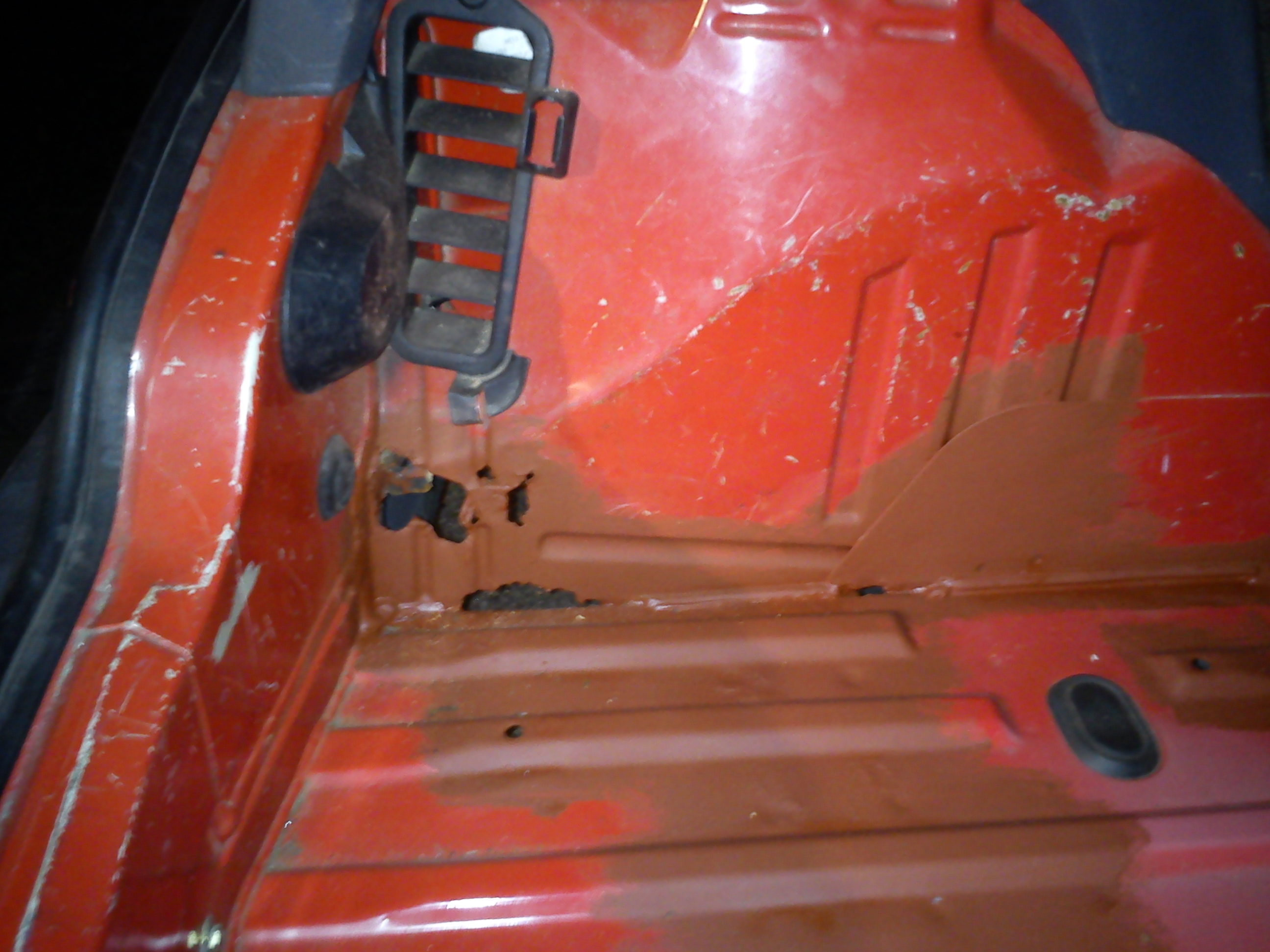

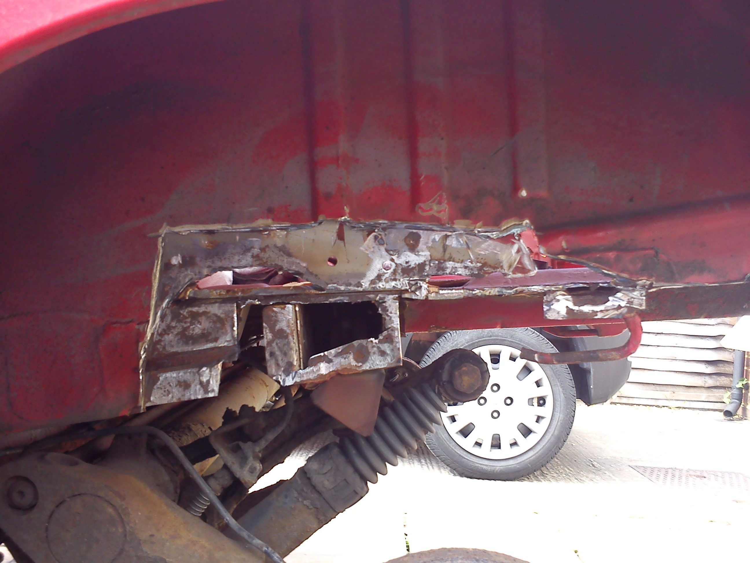

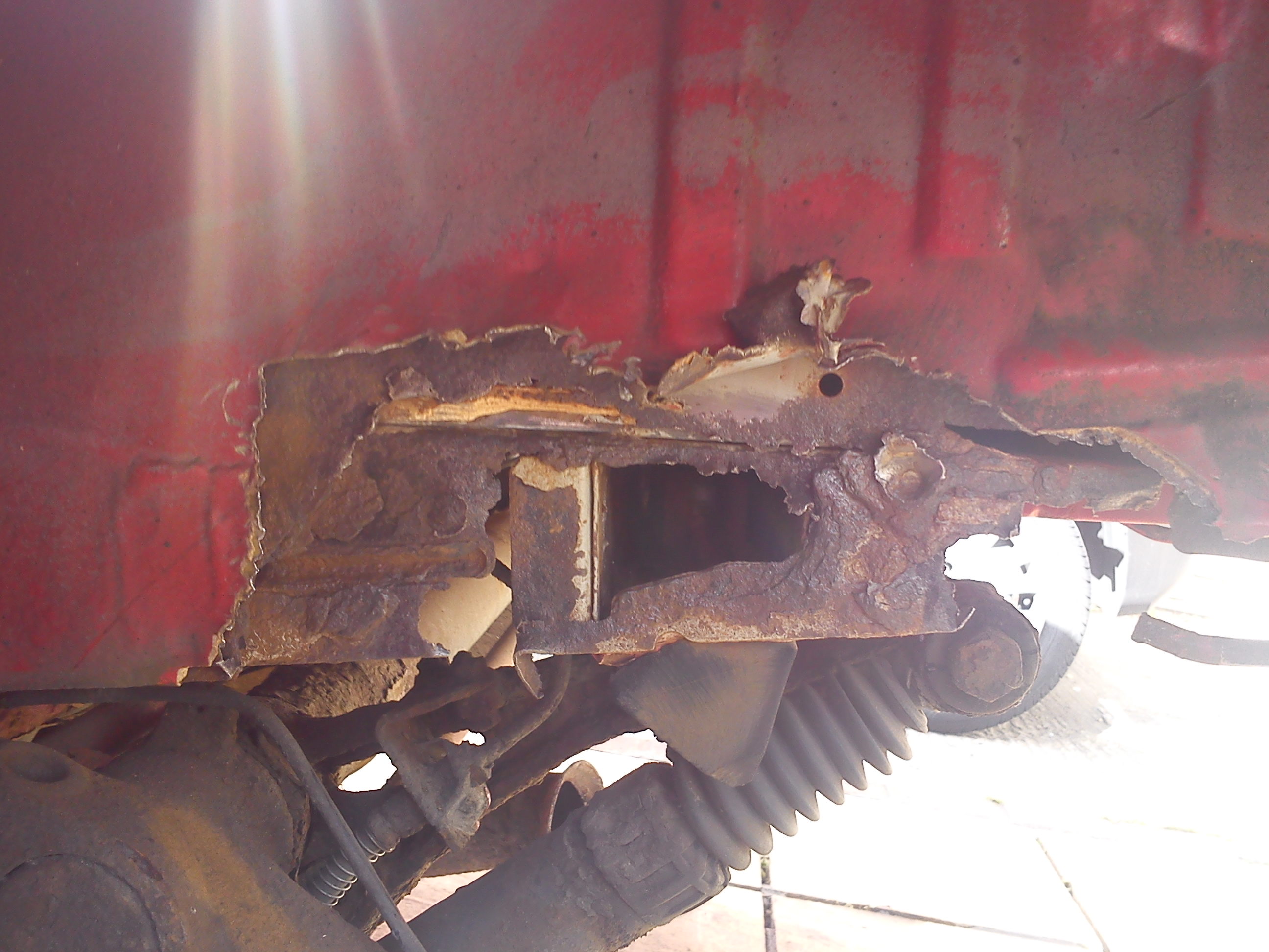

I stupidly made the mistake of deciding to paint the small patches of rust in the boot, anyway it turns out the boot floor is hardly attached at the sides. These pictures dont show really how bad it is as id only cleaned up the inside at this point. Now ive done the outside bits it looks really bad. Im gonna get some more pics and have to plate it tomorrow.
Got a load of hammerite, waxoyl and red oxide primer to keep any further corrosion at bay.
Cant believe it passed an MOT like that 2 weeks ago. Gonna report it to VOSA.

nice rust! my 106 was the same, pretty standard place to rot... still a big fan of them, i want another one for a daily

samass Wrote:nice rust! my 106 was the same, pretty standard place to rot... still a big fan of them, i want another one for a daily
Yh dads 106 van went the same, just patched his last week

not to bad with a rattle can are ya.
#77
kingy Wrote:not to bad with a rattle can are ya.
No im not but this was red hammerite brushed on and its terrible, runs everywhere after i jacked up the back.

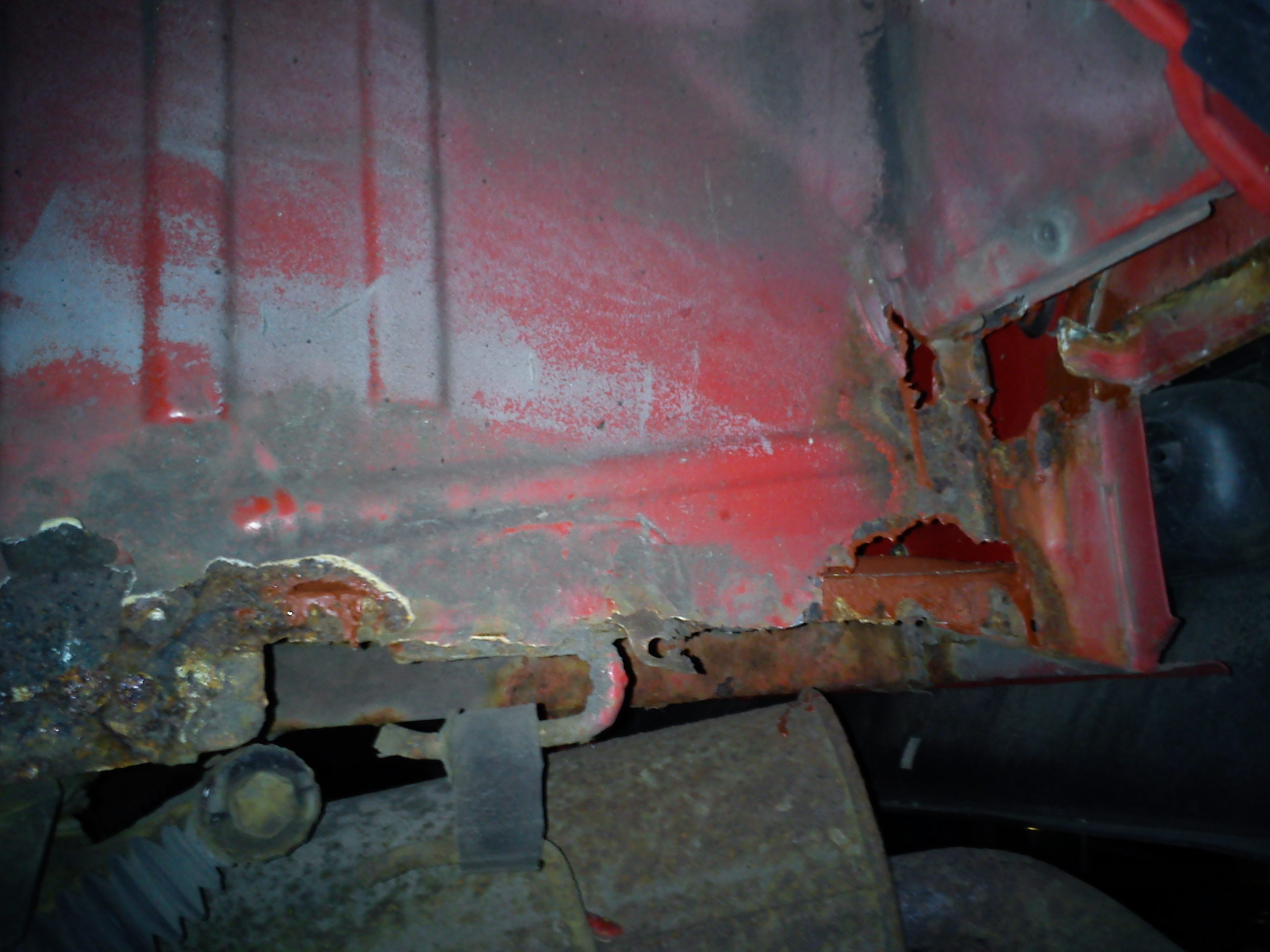

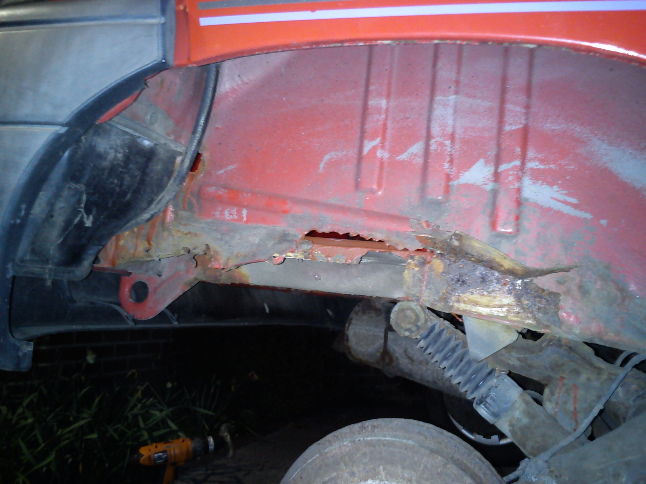

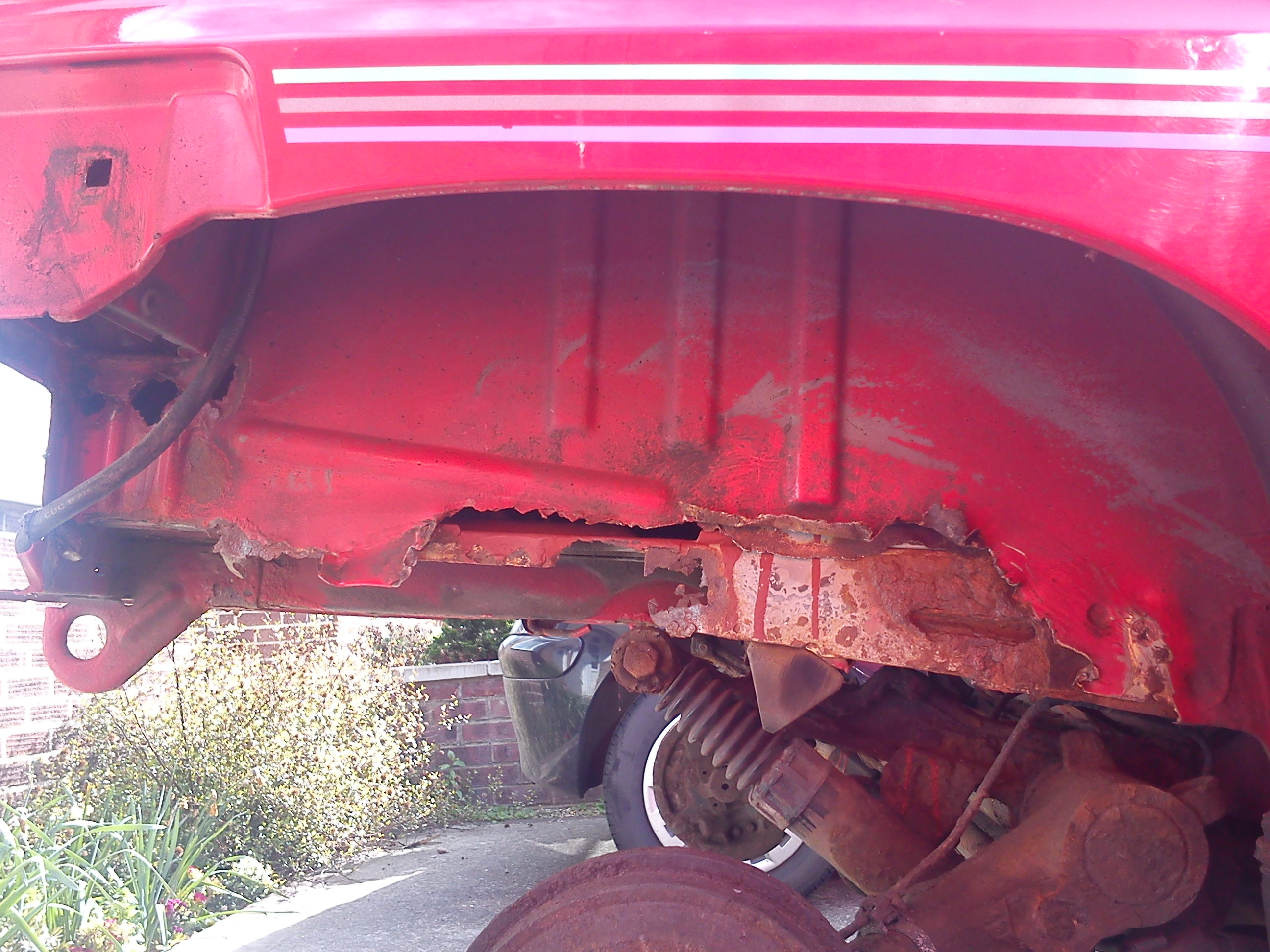

Heres the rust after last nights wire brush and scraper action.
Gonna get the grinder out and cut off some bits so ive got better flat surfaces to plate. Dont have a welder ATM but may hire one on pay day or actually buy one so it may have to survive being pop rivited for a week.

the rust there is a common issue my 106 was the same i welded up one side but the hole just grew and grew ended up trading it in for the 306 i have now

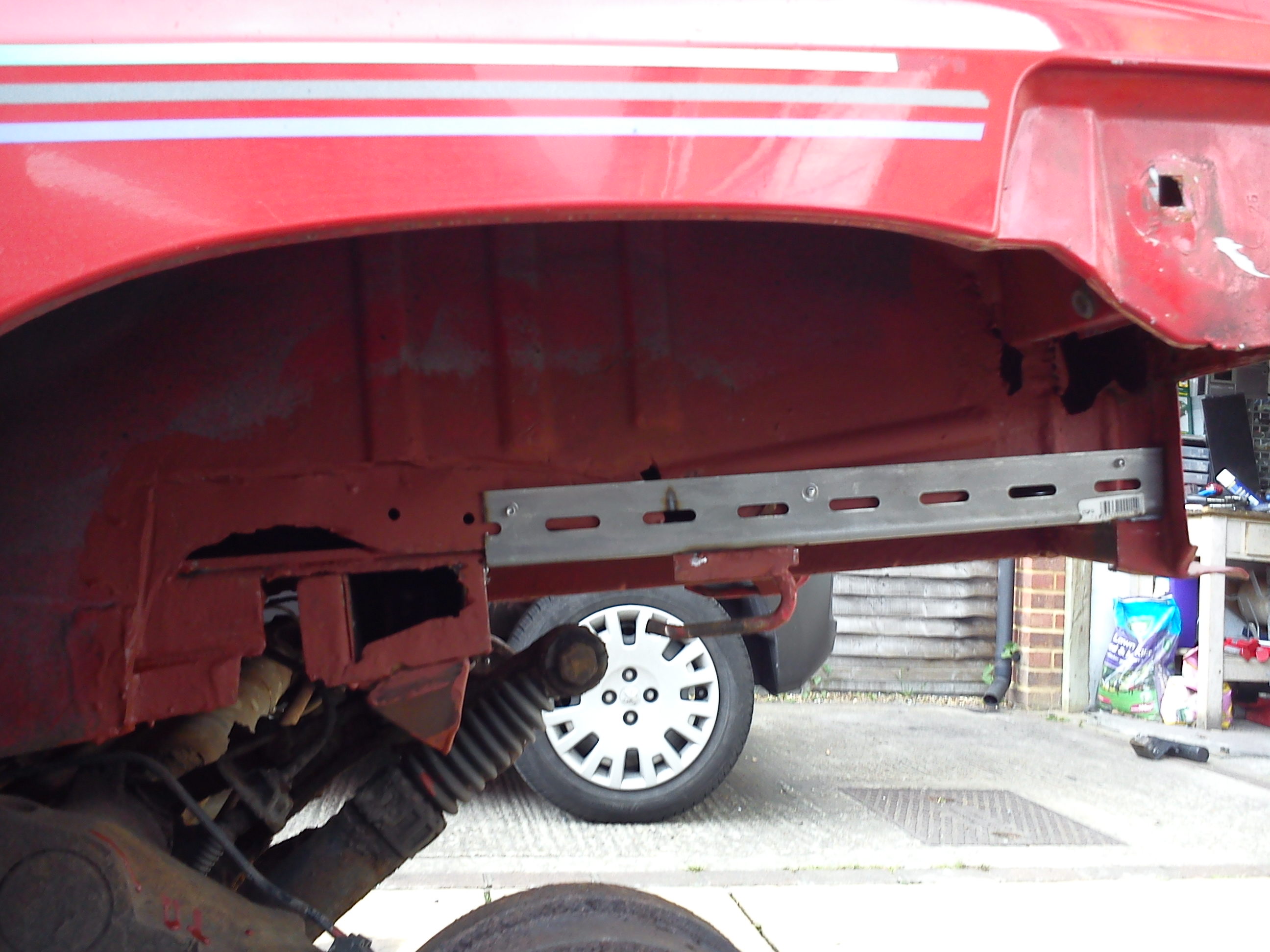

Got all the bad bits cut out with straight edges. Ground most of it back to bare metal.
Then gave it a couple of coats of red oxide and started making up plates which are rivited till i can get hold of a welder
