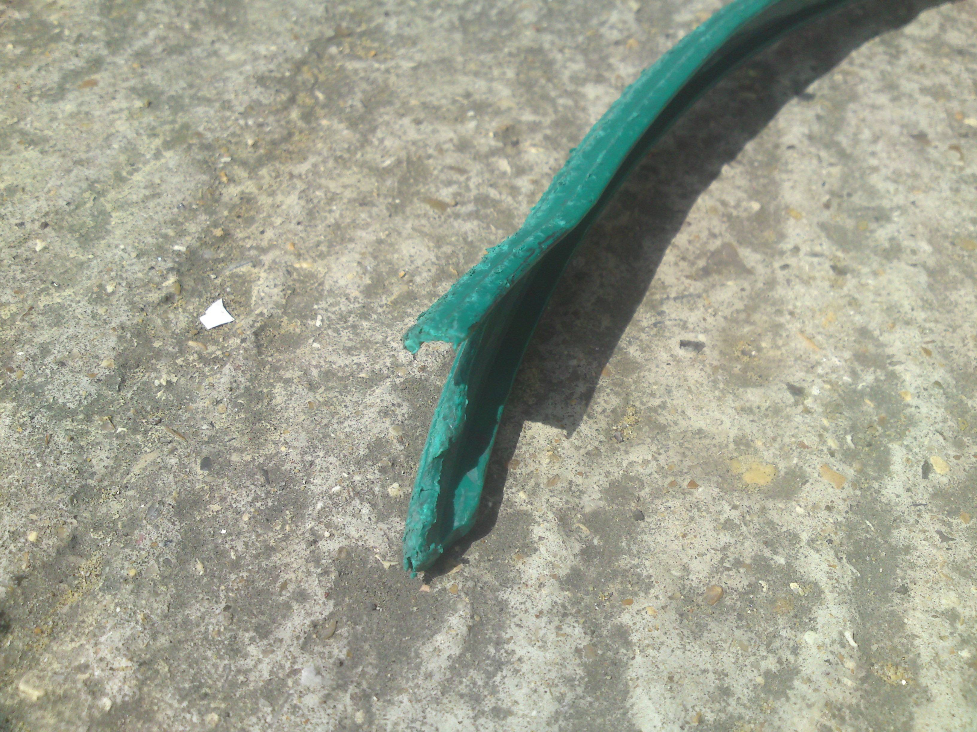

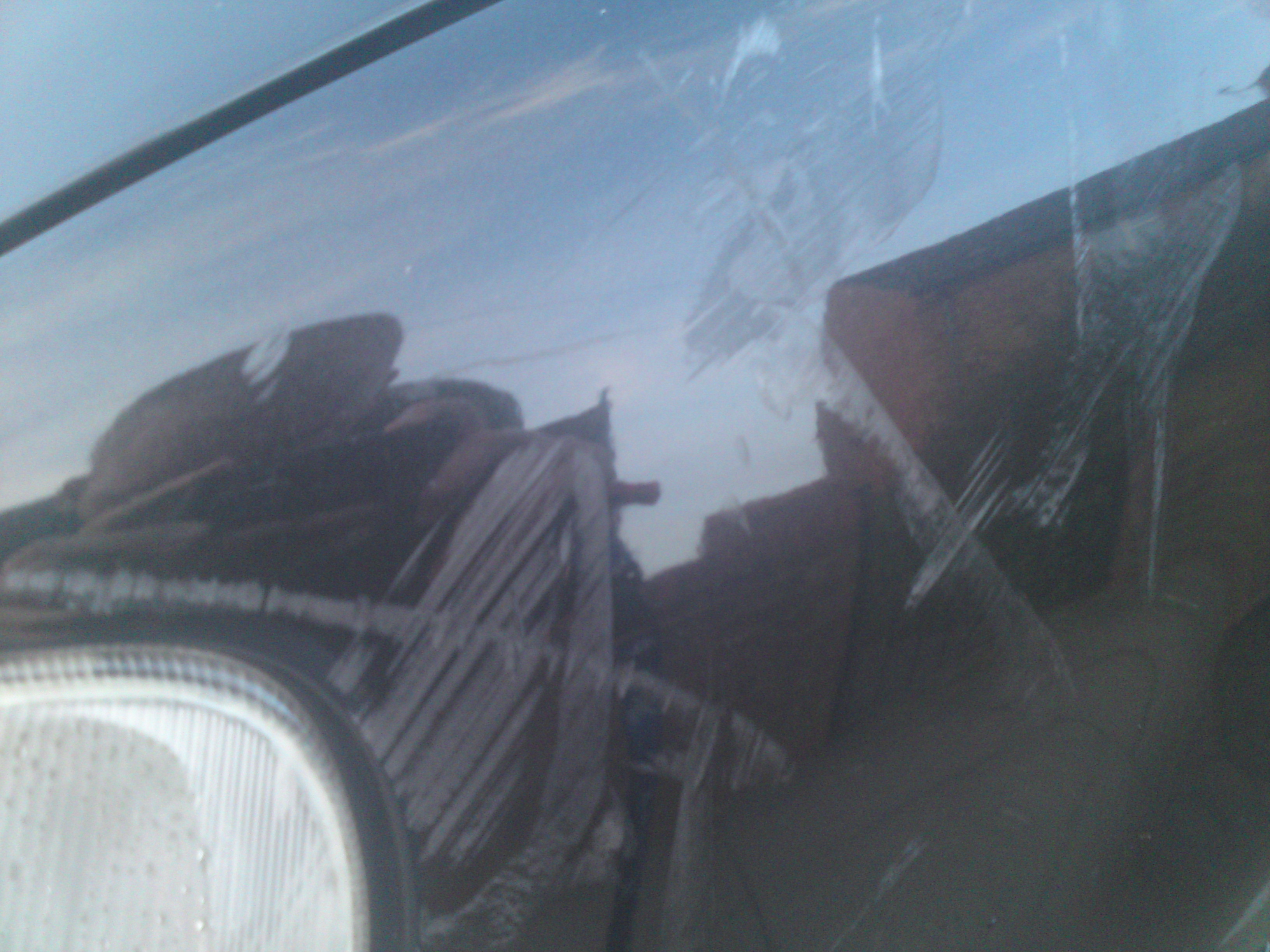

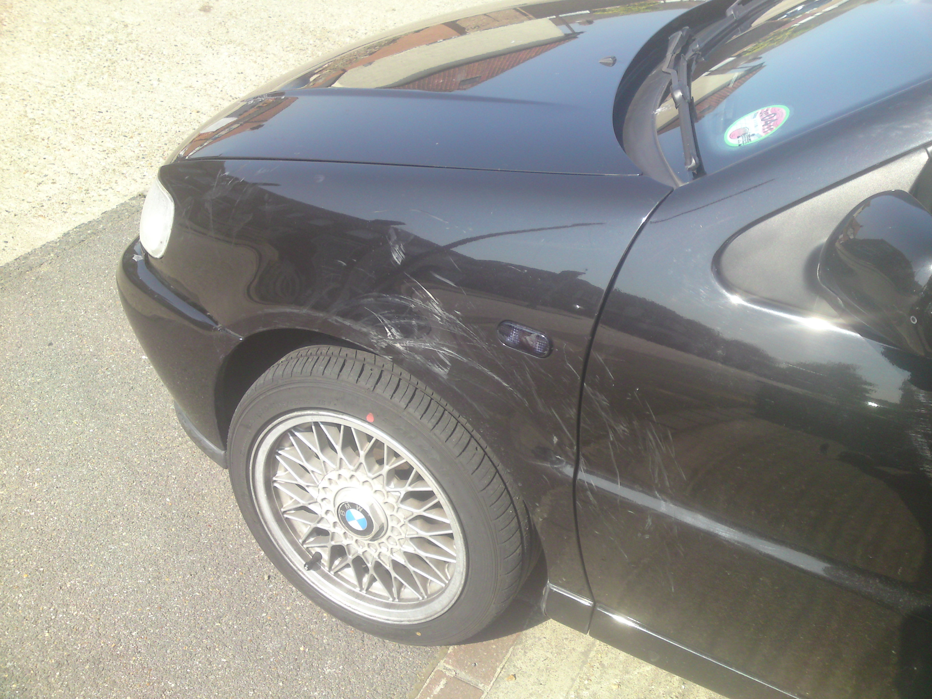

I'd watch the alloygators. IMO they are shit as some enthusiastic cornering will remove them and then untill you stop you'll get the loose end smashing your body work every time the wheel goes round till you stop.
If you like your bodywork and drive hard I'd get rid of them and just learn not to crash into kerbs.
This is my Polo valver after it got attacked by the alloygator.
